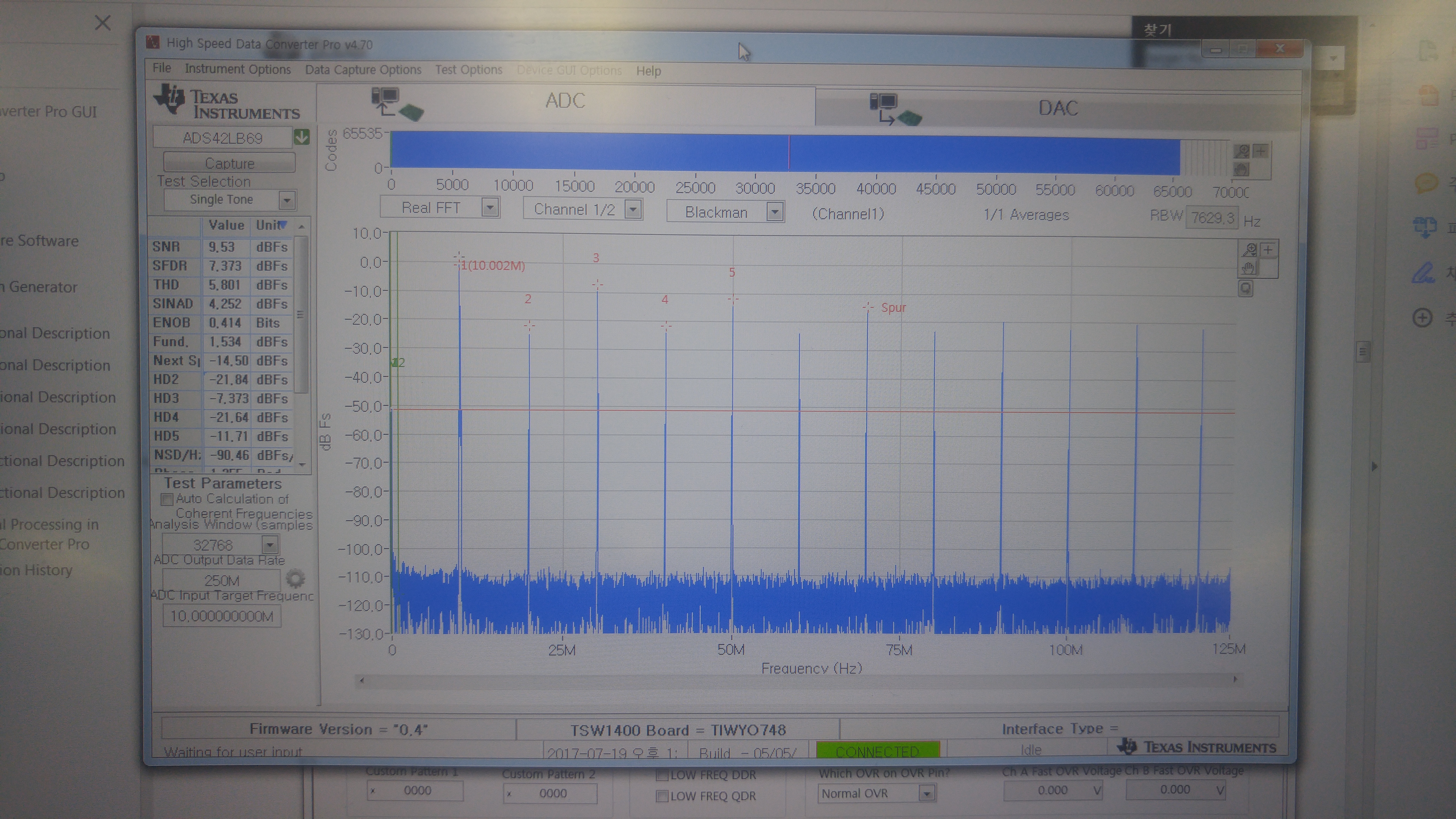

I got test result and some questions for ADS42LB69.

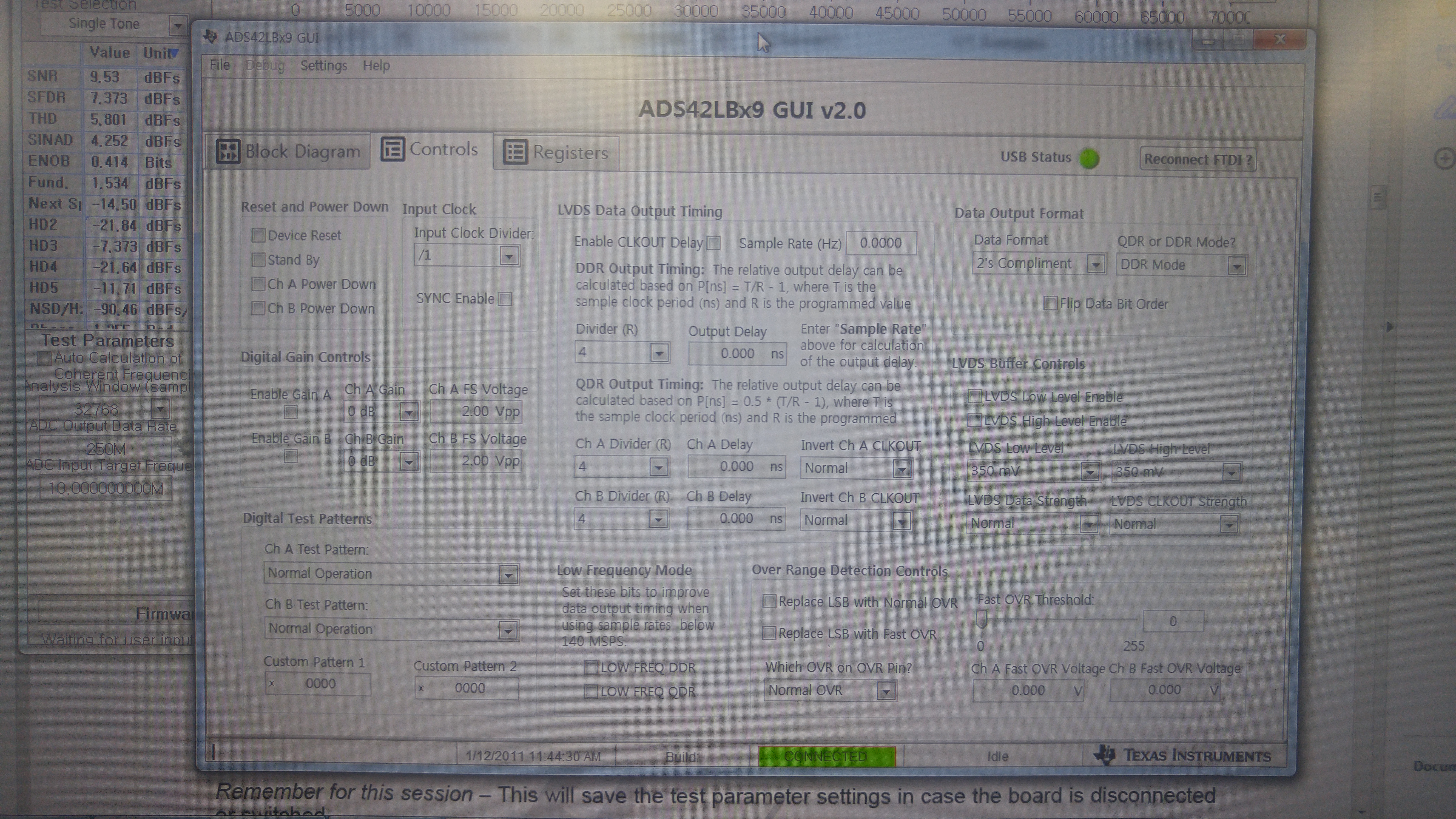

  1. Please kindly refer to my test result with settings for ’ADS42LBx9 GUI’ and ‘High Speed Data Converter Pro’ and let me know how to get the same result on ADS42LBx9EVM User's Guide. In my test, Clock Input was 250MHz and Signal input was 10MHz.

  1. Unexpected components on captured data using TSW1400 as below.

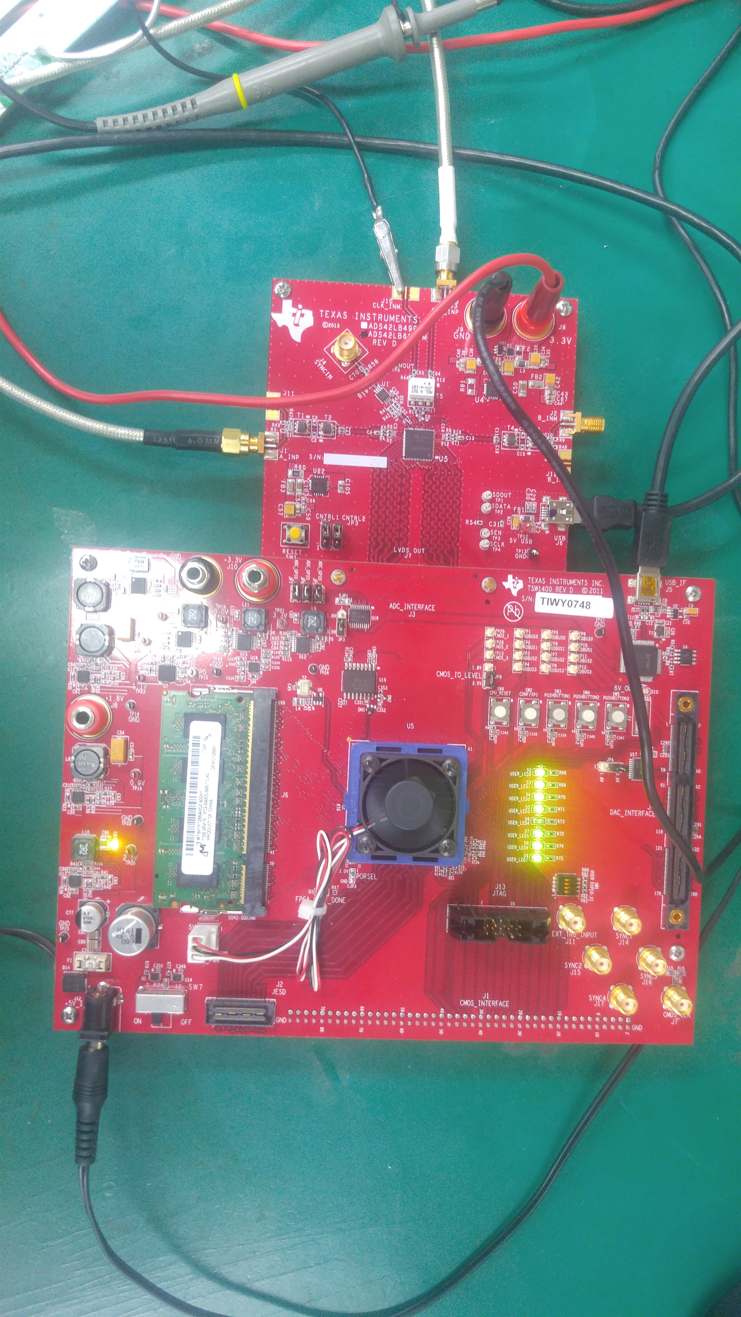

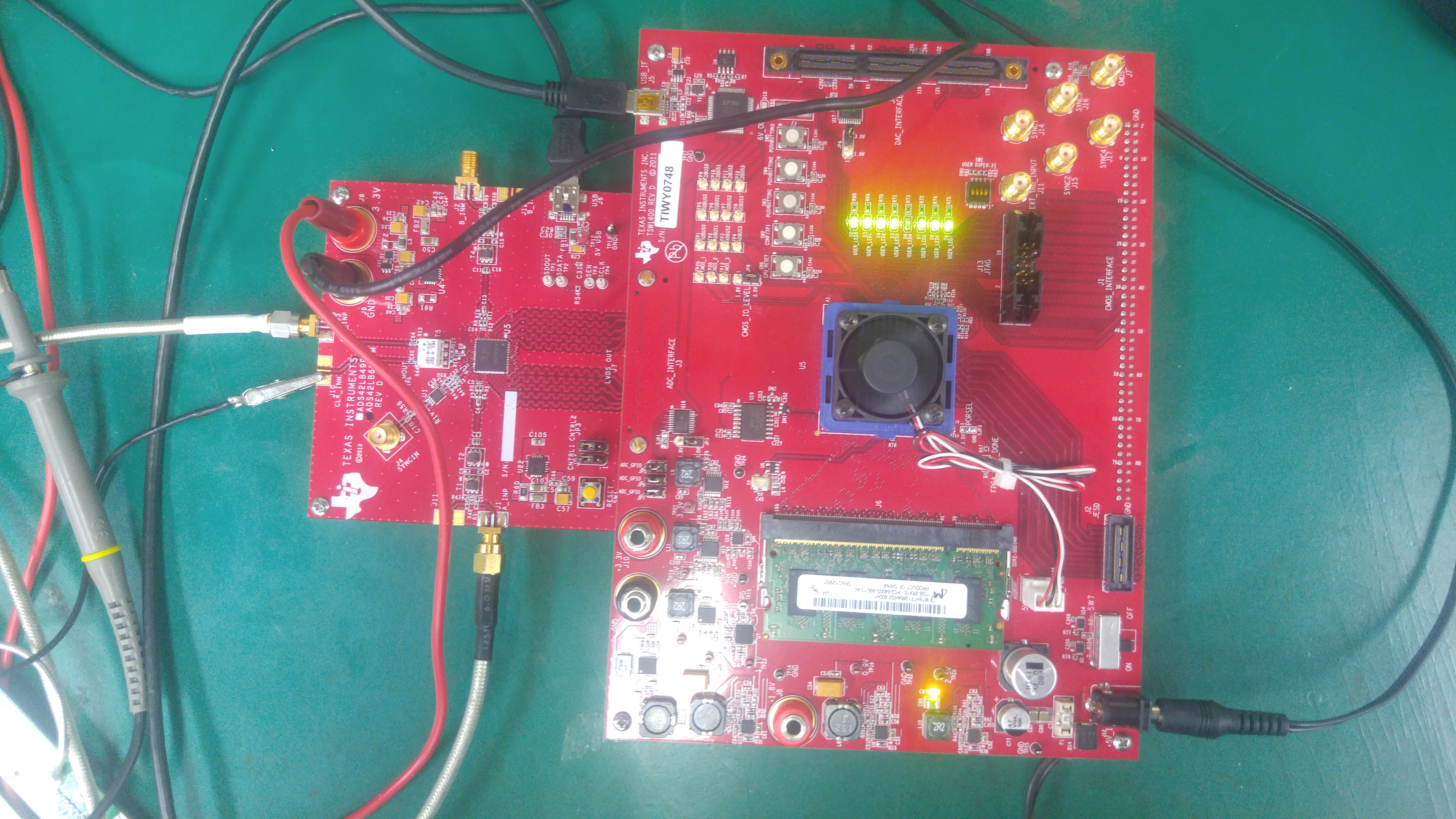

  1. Followed ADS42LBx9EVM User's Guide in http://www.ti.com/lit/ug/slau465a/slau465a.pdf

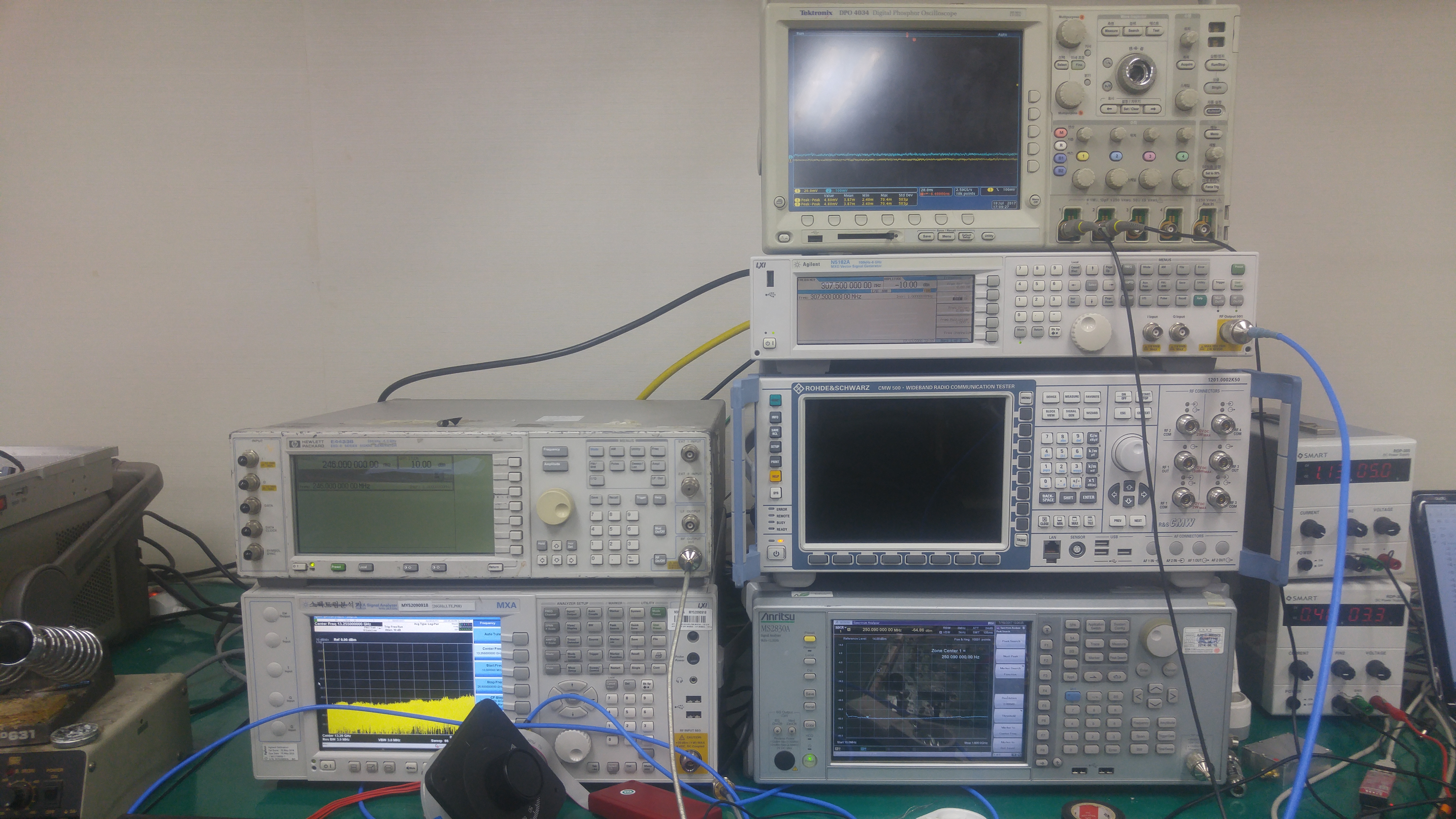

  2. Bandpass Filter
Since I don’t have bandpass filter, I couldn’t follow below instructions. So I tried to use Low Pass Filter for 10MHz frequency input, but test result was same.
- Connect a signal source to either analog input SMA connector, A_INP or B_INM. For single-tone testing, a bandpass filter should be used to achieve the best SNR and harmonic performance.
- Connect the ADS42LBx9EVM to the TSW1400 by connecting J7 on the ADS42LBx9EVM to the ADC Interface connector on the bottom of the TSW1400.
3. Settings for ’ADS42LBx9 GUI’ and ‘High Speed Data Converter Pro’
Please refer to the settings that I used for this test as below.
