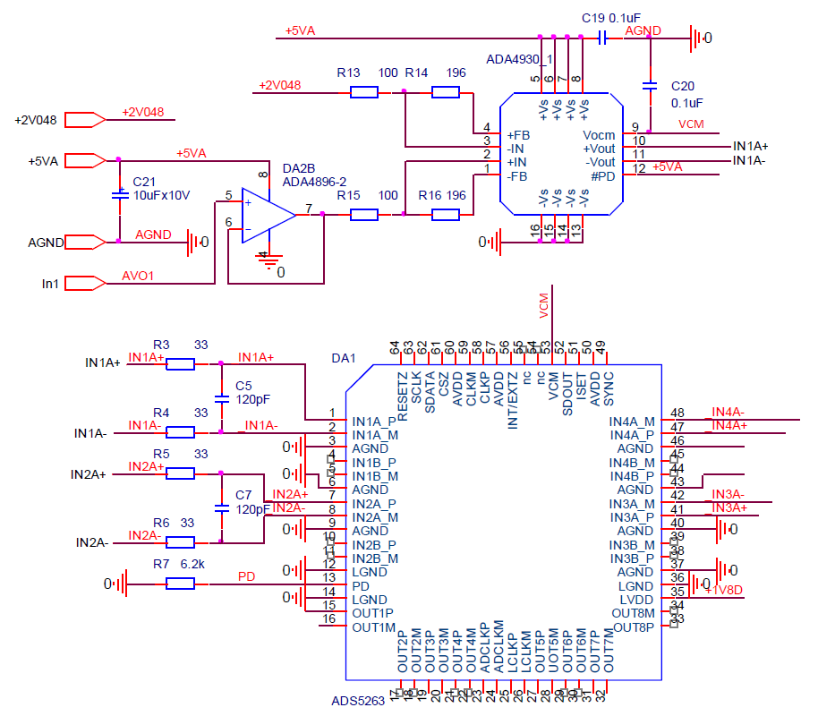

We are using ADA4930 to drive ADS5263. Maximum slew rate of the signal at the input of ADC is 47V/us. Acquisition Time should be ~85ns. Here is a fragment of the circuit:
Are there any mistakes in our design? I'm confused by the phrase in ADS5263's datasheet (page 63): "A 5-Ω to 15-Ω resistor in series with each input pin is recommended to damp out ringing caused by package parasitics. It is also necessary to present low impedance(<50Ω) for the common mode switching currents. This can be achieved by using two resistors from each input terminated to the common mode voltage (VCM)."
1) Why do we what to place those 5-Ω to 15-Ω resistors in series with each input? I think we need a little a possible impedance between "reservoir" capacitor C5/C7 and sampling circuit of ADC.
2) Could you explain why I need "two resistors from each input terminated to the common mode voltage"?
Another question is about analog input equivalent circuit (figure 90 page 62). I'd like to simulate glitches caused by sampling circuit.
3) What are timing diagrams of those three switches? Sampling switches are "off" during convertion period and they are "on" rest of the time. Right? What is timing diagram of the third switch (rightmost)?

  • Something wrong with schematic attached to my first post. Another try:
  • Hi Anton,
    Figure 103 in the datasheet depicts what the datasheet means for question 2--it likely applies only when adding a common-mode voltage signal an AC-coupled input. Since you are DC-coupling your amplifier output to the ADC input, you just need to make sure the Vcm is as specified in the datasheet.
    The 5-15ohm input resistances are fairly small and recommended to reduce ringing if present.
    I believe all three switches are on when charging the sampling capacitors during sampling/acquisition only but I'll have to confirm with my IC design team. I'll get a response back to you by the end of next week.

  • Hi Olu,
    Any updates on ADC's input circuit model and switch timing diagram? We still have large glitches and I what to play with driving circuit parameters.
    What topology of driving circuit is better: a) have two capacitors from ADC +in to GND and -in to ground
    or
    b) have one capacitor between ADC +in and -in as shown in my circuit above?

  • Hi Anton,
    All we have for the ADS5263 is the IBIS model as shown on the product page.
    I can confirm that all three switches come on at the same time when charging the sampling capacitors as I mentioned earlier.

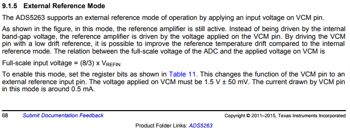

    If you are supplying an external Vcm to the ADS5263, make sure it is approximately 1.5V +/-50mV as specified here.
    Regarding the capacitors, two capacitors likely better as the circuit would then be able to provide common-mode charge compensation in addition to differential charge compensation.
    Either clock option is fine but the LVPECL clock edge might be slightly better for the device.

  • We are using internal VCM (register 0x42 is 80, pin INT/EXT #56 is pulled to GND).
    Falling edge of the CLK_P cause all three switches to close (turn on), and rising edge of the CLK_P cause all three switches to open (turn off). Right? Delay between posedge CLK_P and switch opening is t_a<3ns (aperture delay). What is delay between negedge of CLK_P and switch closing? Our glitches are delayed from negedge of CLK_P for ~20ns.  Can those 20ns be the delay between negedge of CLK_P and switch closing?  There is no reset switch, so charges at the sampling capacitors remain between samples?
    Wouldn't those capacitors from +in and -in to GND be a path for common mode noises from the ground? Those capacitors will be a little bit different (2% tolerance at best). Wouldn't it skew differential operation of the circuit?
    Does ADS5263's IBIS model correctly simulate analog input circuit and its transients? Does macromodel of ADS5263 exist?
    Is it possible to get ADS5263 evaluation board design files in order to carefully study its layout?
    Thanks!

    Yes, according to your description of setting internal Vcm mode (shown as below):
    Could you please double check and make sure whether you have the following register settings:
    Thank you!
    1) Please set register as Address=0xF0, Data=0x0000
    2) Please set register as Address=0x42, Data=0x8000
    3) Please make sure this pin: INT/EXTZ is tied to Logic High.
    4) Then please measure Vcm output voltage would be around 1.5Vdc.
