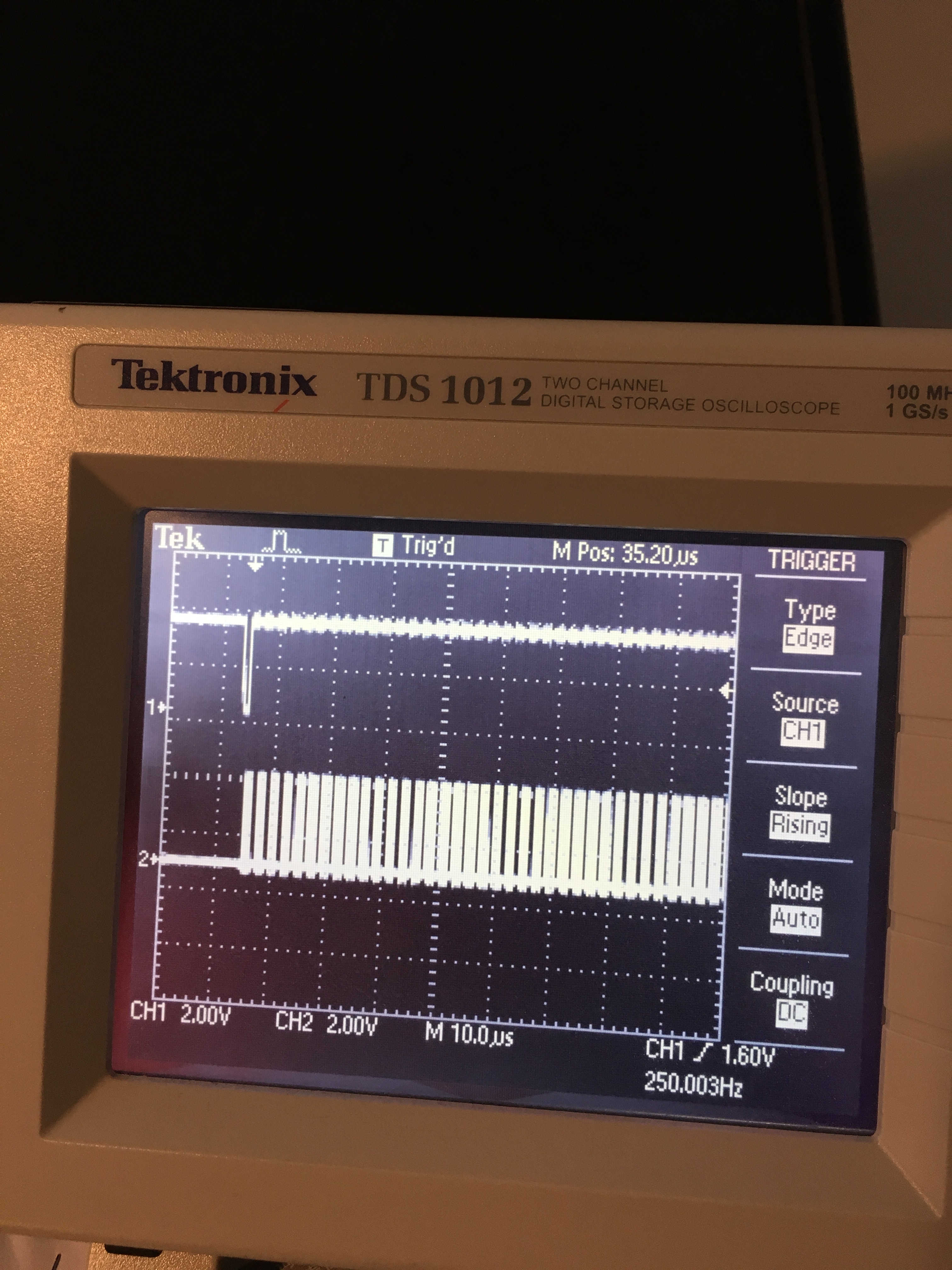

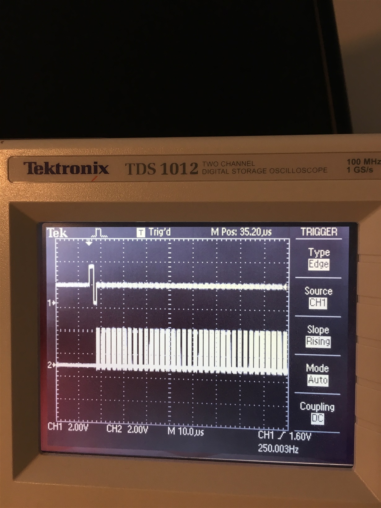

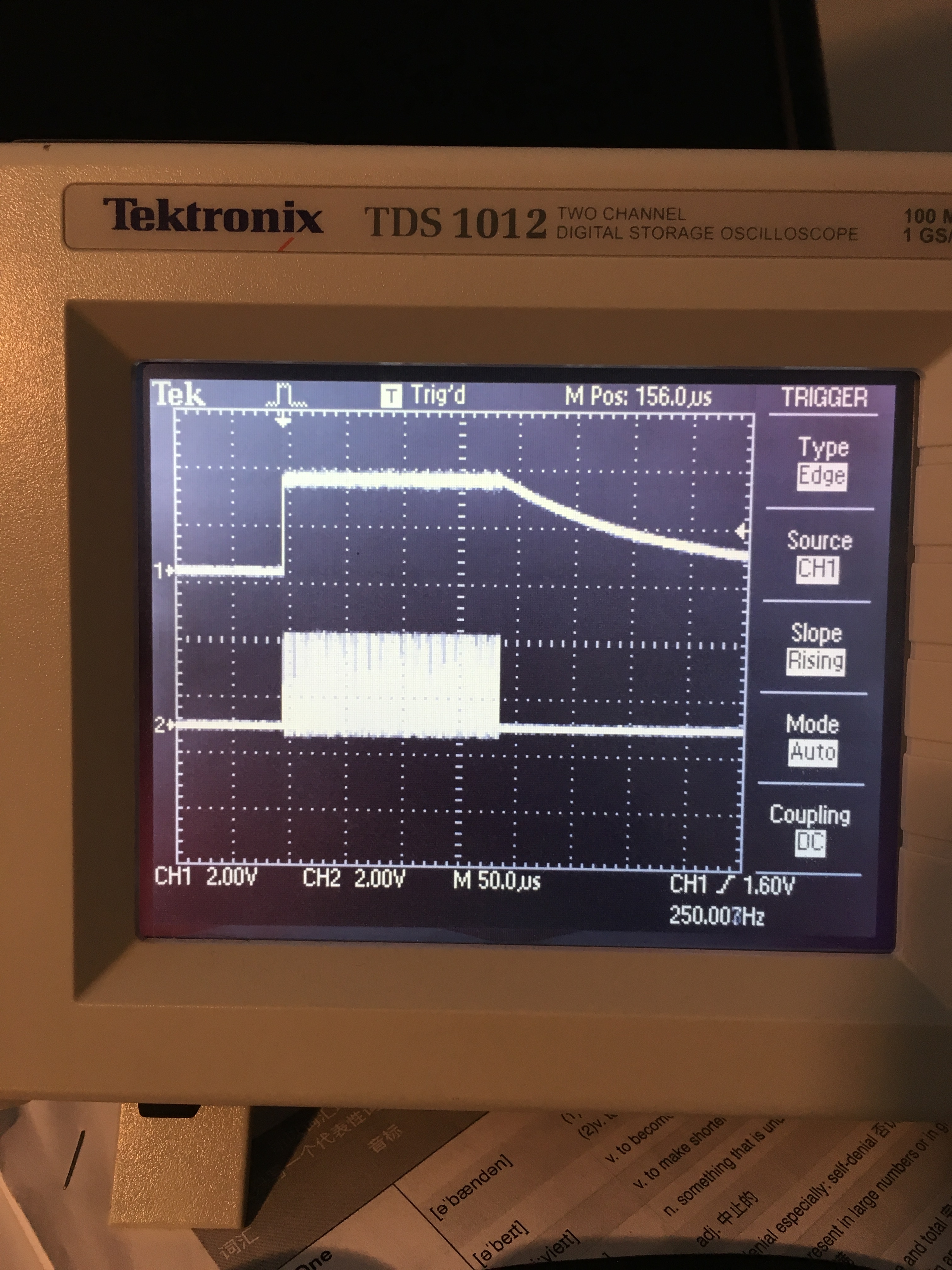

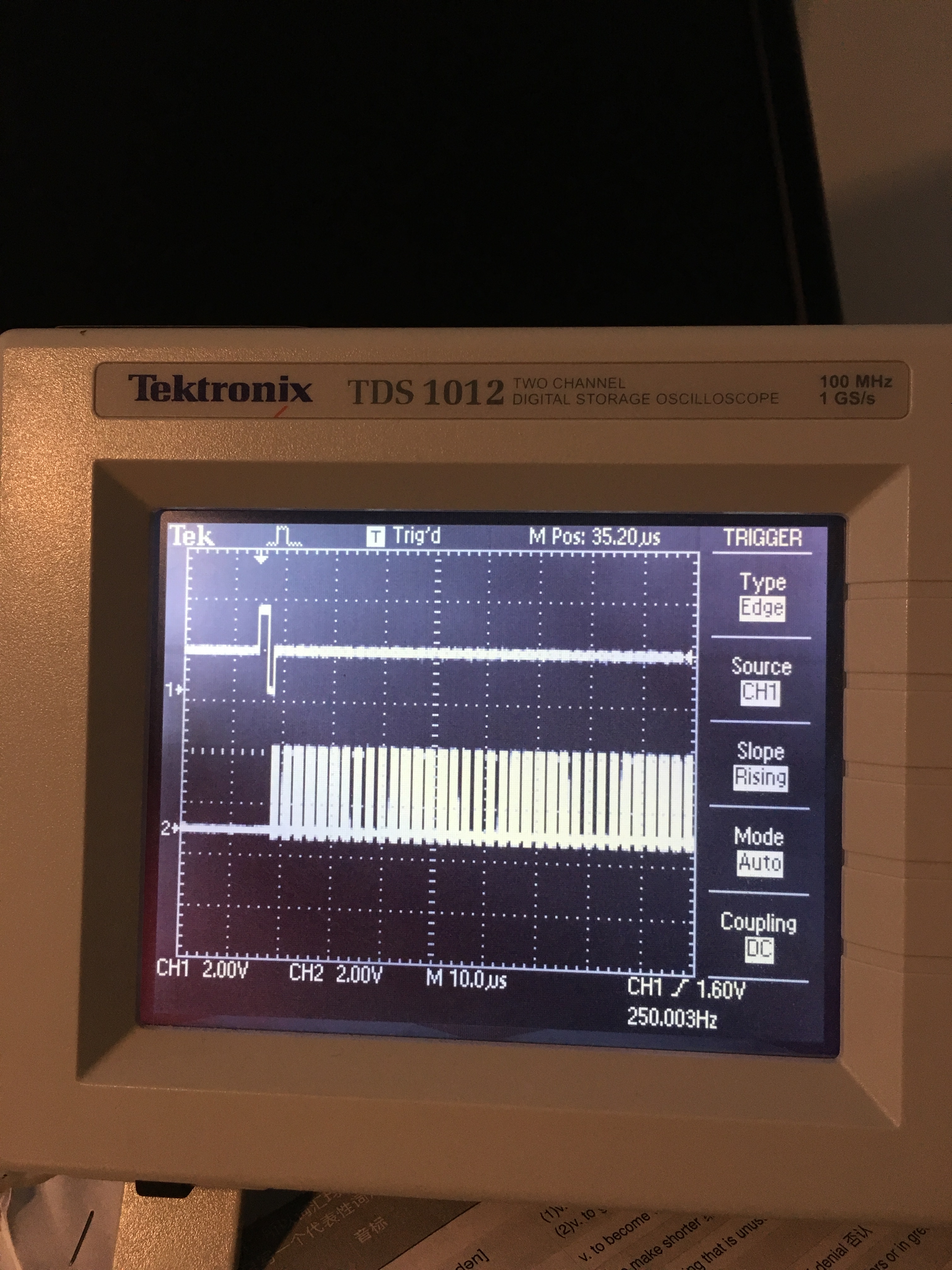

  I have made the system using three ADS1299EEG EVALUATION board and one STM32F4 Discovery board. I configure the three ADS1299s in the Daisy-Chain mode. The three ADS1299 share the same /CS, DIN, SCLK, CLK and power signals. The second and third ADS1299s' /DRDY are floating and not connecting to any pins. The first ADS1299's /DRDY signal is connected to STM32 as an external interrupt input. The DOUT PIN of the second ADS1299 is connected to the first DAISY-IN and the DOUT of the third ADS1299 connected to the second DAISY-IN of the second ADS1299. The DAISY-IN pin of the third ADS1299 is connected to GND.
  Now I can write and read the register of the first ADS1299 and when the data conversion begins the /DRDY pin triggered correctly. But the data I read from the ADS1299s is 0xFF and there is a long 'tail' after the data. It shows below.
 The first picture is SCLK and DOUT of first ADS1299, which the upper is DOUT and the lower is SCLK. The second to the fourth picture is /DRDY pin of the three ADS1299s. I think the /DRDY pins of three ADS1299s are synchronized. But the data is wrong. Anyone met this thing ever before. Please help me, thank you very much.

    Assuming the devices are synchronized and configured for the same data rate, you should only have to monitor the /DRDY pin of the first ADS1299. /DRDY will transition high after the first SCLK falling edge and it will stay high until the next sample is ready to read.
    The discharging "tail" you see on DOUT might be explained by returning /CS to high and disabling the ADS1299 interface. When this happens, the DOUT pin changes to a high-impedance state and any remaining voltage may be discharged through a low-impedance path on the circuit board or through the capacitance in your scope probes. I don't believe it's indicative of an issue just yet.

    As I explained in that thread, the number of devices you can daisy-chain depends on the data rate, SCLK frequency, and the number of bits you need to read. I do not believe that sharing the power rails would be a problem. You can verify this by probing the analog and digital supply pins as well as the /DRDY pins for all three devices. That should confirm whether all power rails are correct and that all devices are converting properly. If you use the same CLK source and synchronize the devices' conversions with the START pin, the /DRDY pulses will also be synchronized.
