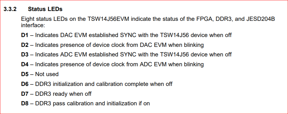

D8  MEM FAIL LED was ON this means memory fail ?
D7 MEM SUCCESS was OFF.
Kiman
  • Hi Kiman,
    You are correct. If LED D8 becomes illuminated, it means that there is a DRAM issue. (Just to be clear, you are able to connect to HSDC Pro, but error happens when you try to capture?)
    Unfortunately, the board must be replaced. Please return it to TI through your appropriate channels. Before you return the board, could you please provide the serial number that is associated with the board when connecting to HSDC Pro? Thank you!

  • Hi Jim,
    LED 8 becomes illuminate after firmware download.
    For example If I select ADS54J66_LMF_4841 then asking "Do you want to update the Firmware for ADC?" next I press "Yes".
    Yes, connection and the Firmware download is fine.
    D4 is Off,.

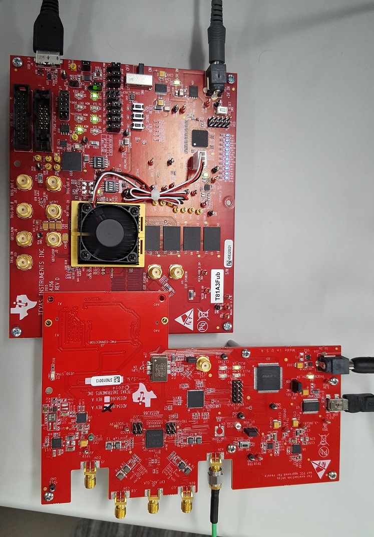

    After making all connections and loading HSDC Pro firmware and ADS54J66 configuration files (as shown in quick start guide), your setup should look like the picture below.

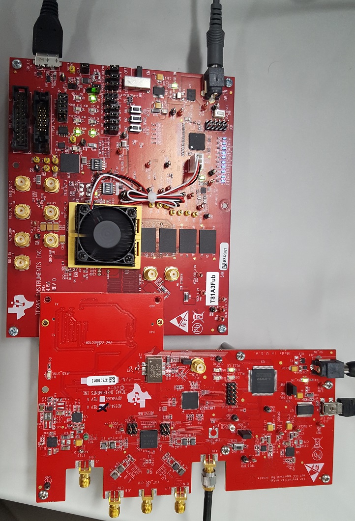

    After entering ADC Data Rate and clicking "Capture", your setup should look like this. Notice that D3 on ADS54J66 illuminates after loading the first configuration file in the ADS54J66 GUI.

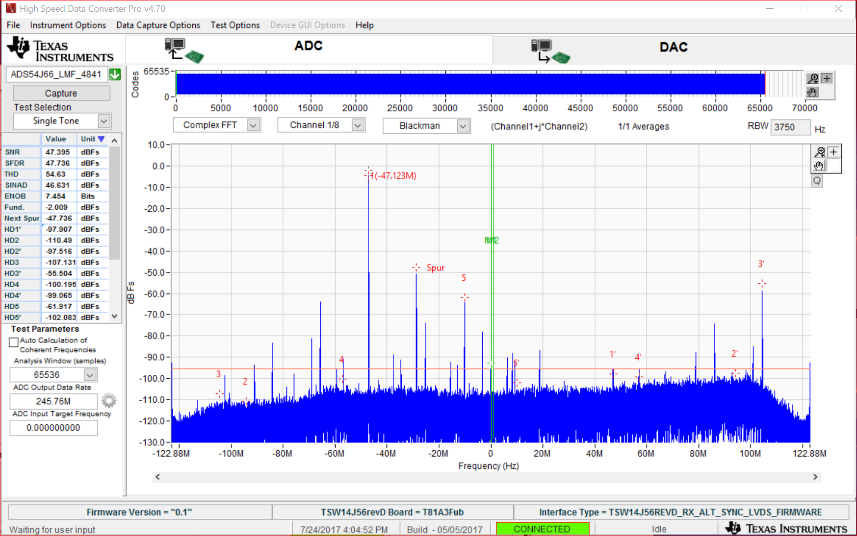

    Notice that D3 has extinguished and D4 is now flashing. HSDC Pro should have a capture that looks something like this.
    Could you please tell me (or screenshot) what error HSDC Pro is giving you?

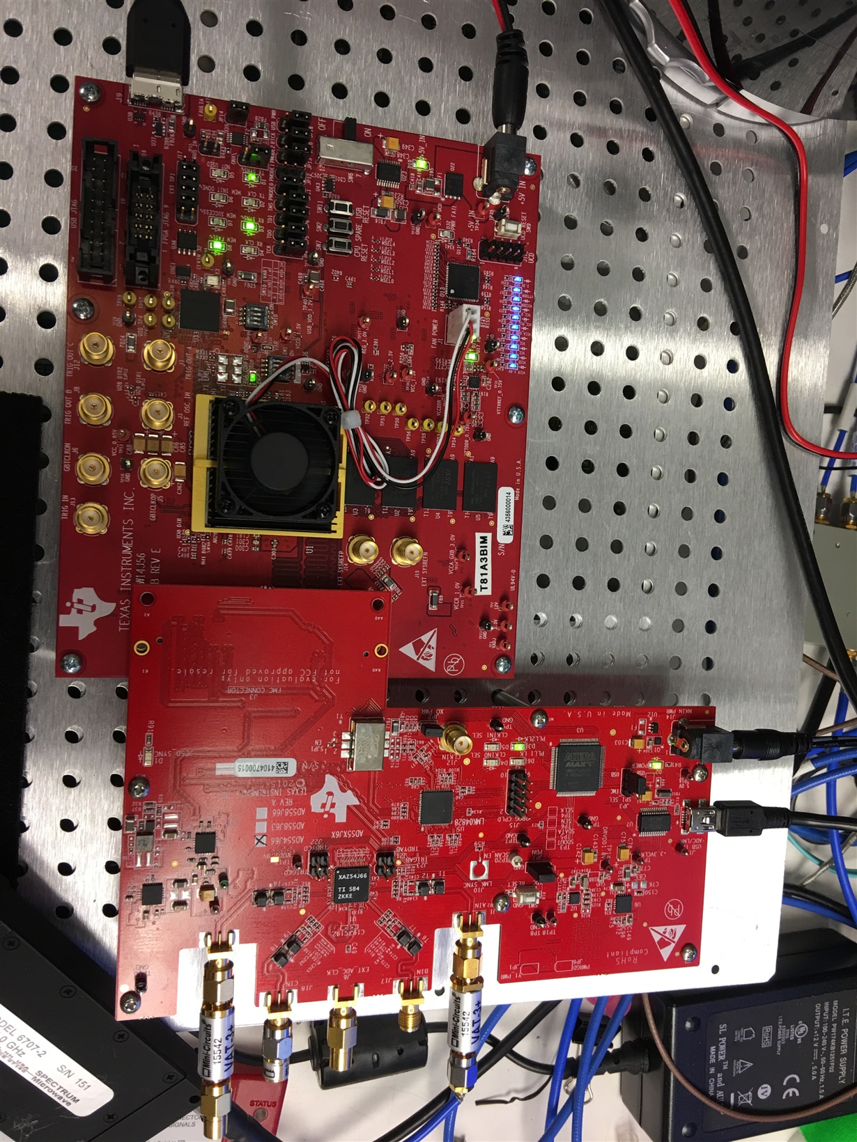

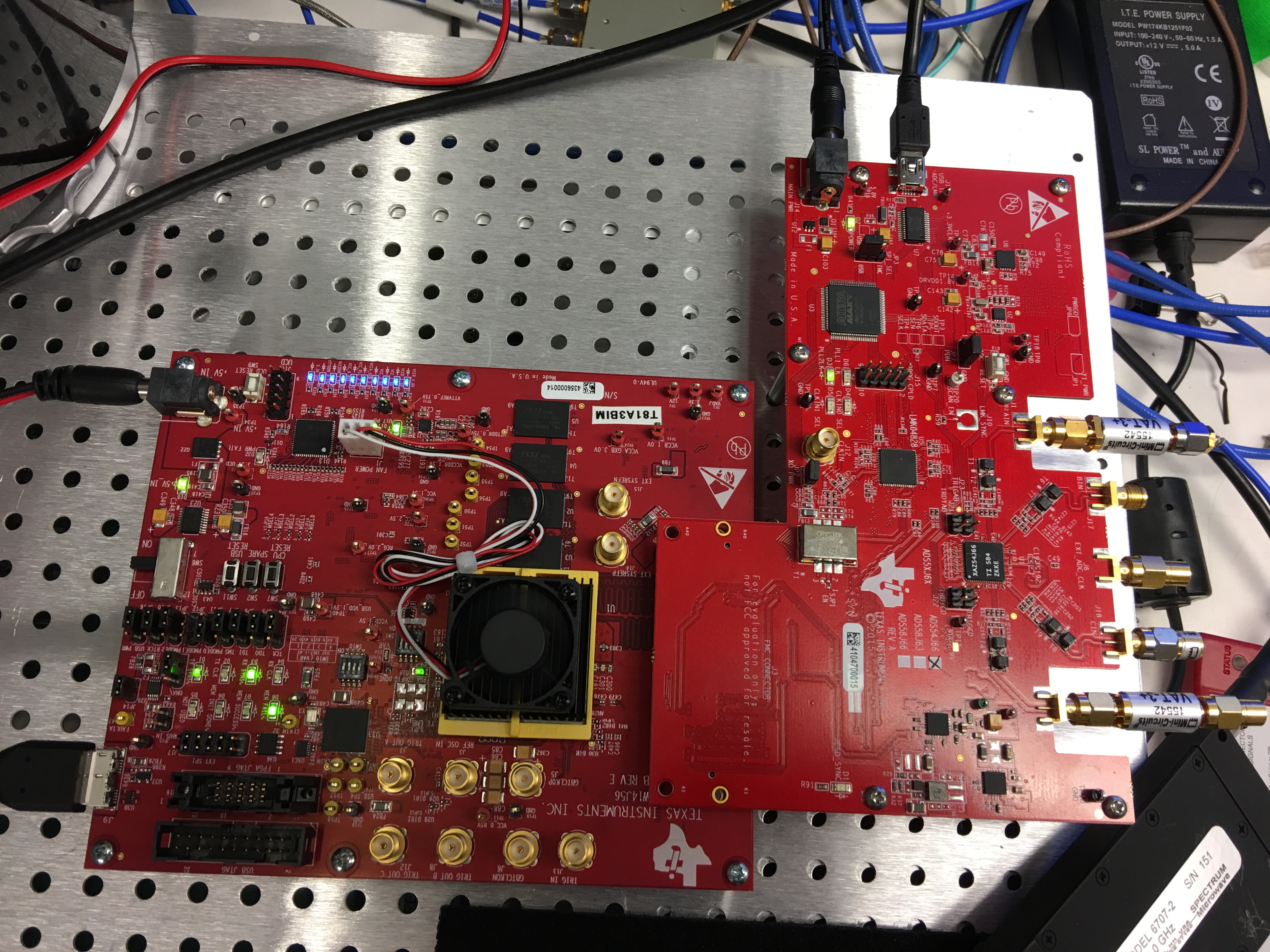

  • Kiman,
    From your photo, it looks like you have an early version of the ADS54J66EVM because the ADC device is labeled as a pre-production unit. Send us your address and we will get you an updated EVM ASAP.
    Jim

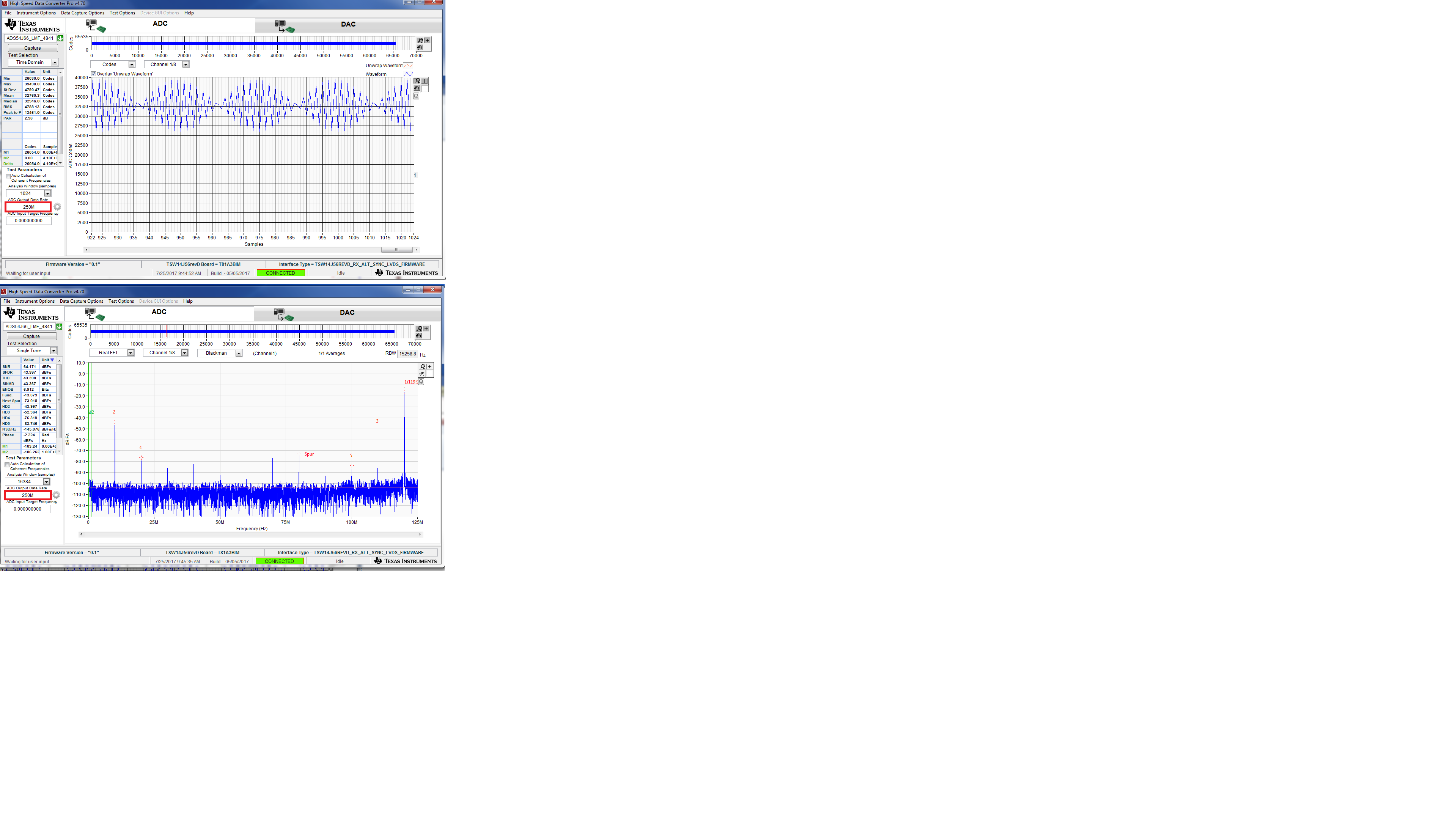

  • Hi Dan and Jim,
    I found one of missing that was ADC output data rate unit wrong. I did not typed 'M' MHz unit.
    After correction the FFT mode looks good.

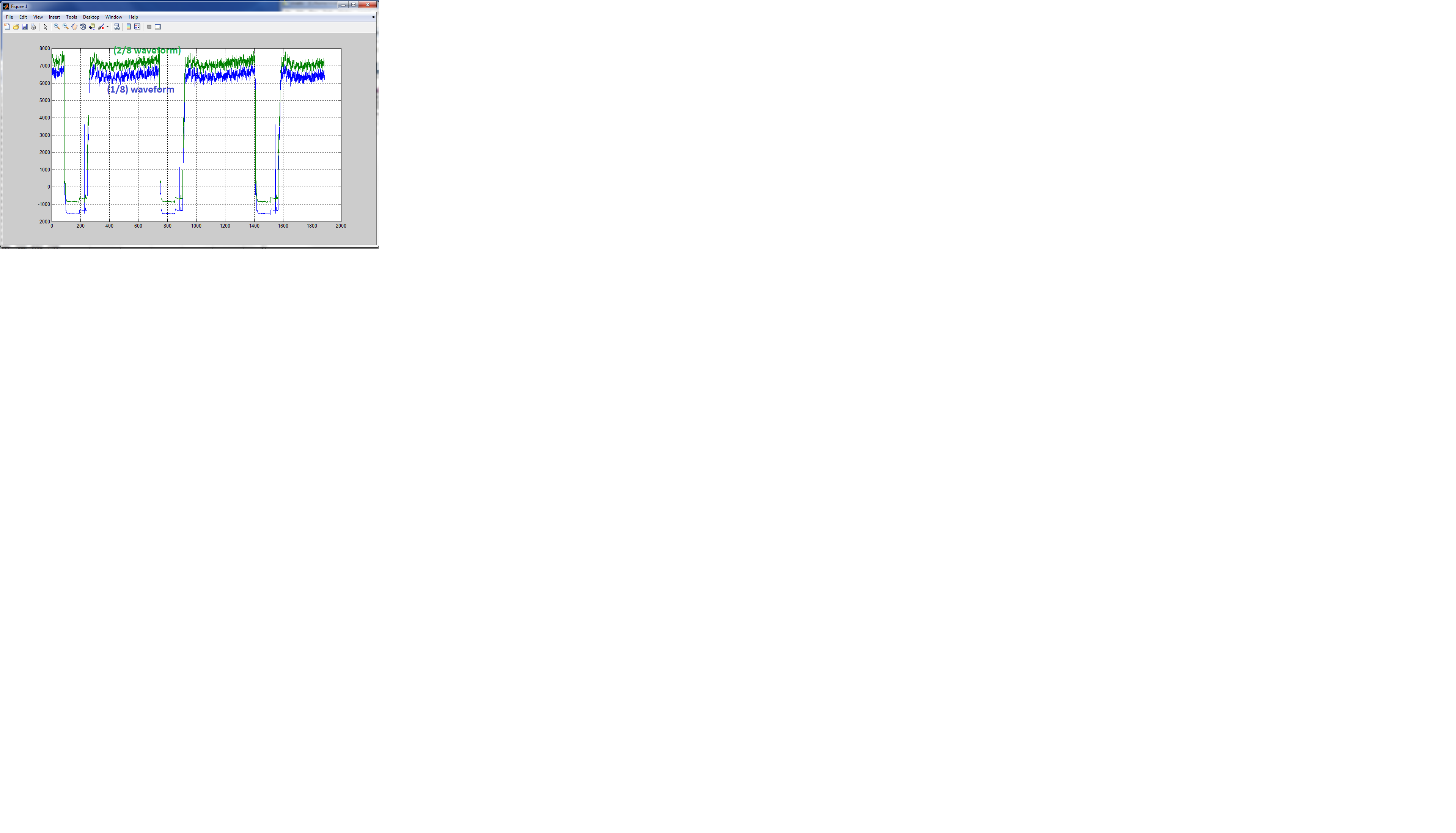

    But Codes (Amplitude) mode has offset maybe not correctly decoded sign bit.

  • Hi Jim,
    I received the new board and confirmed with our beam signal.
    Thank you so much for send a new board.
    One of issue is channel to channel phase are not same.
    For example CH1 and CH3 are same phase, CH2 and CH4 are same phase.
    But CH1 and CH2 are 180 degree phase difference. This issue coming from ADS54J66 EVM board.
    Test condition:
    Rf input 499.680 MHz
    ADC Fs = 499.680 MHz  Sync with RF input
    ADC internal mode 8 which is burst mode.
    Kiman
  • Kiman,
    To make the routing of the analog traces symmetrical and keep everything on the top side of the board, we swapped the P and N signals of channels 1 and 3 going to the ADC. This is why you are seeing what you are.
    Jim

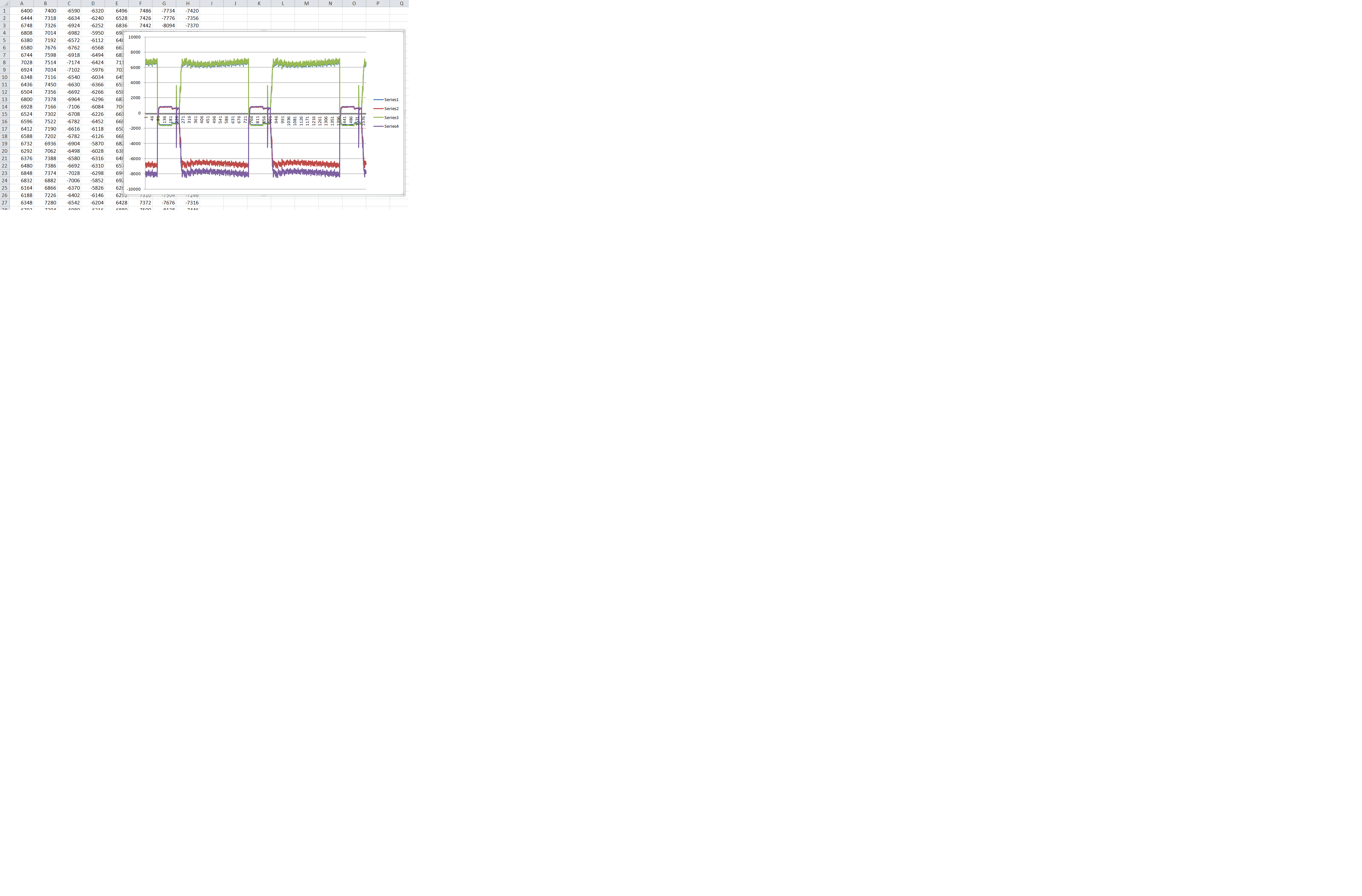

    As I mentioned before about our setup:
    RF Fin = 499.680 MHz
    ADC sampling  Fs = 499.680 MHz
    We assume that Fs clock edge is Rf input positive peek value (we used phase shift for finding peak value).
    Some reason I observed internal ADCs has different offset values, each channel has two ADCs and sampling rate is Fs/2.
    This offset difference is coming from our setup or noise coupling ?
    If you have any experience please advice me.
