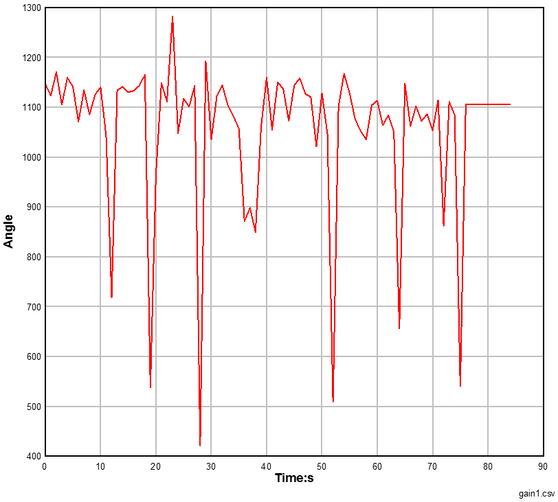

(1)When the motor is in a fixed position (which is always in sinθ = 0 or cosθ = 0), the angle values which are stored in DEV_STAT5 register are always changing from 2 to 170 incs.Please see the graph below, What's the reason for that?

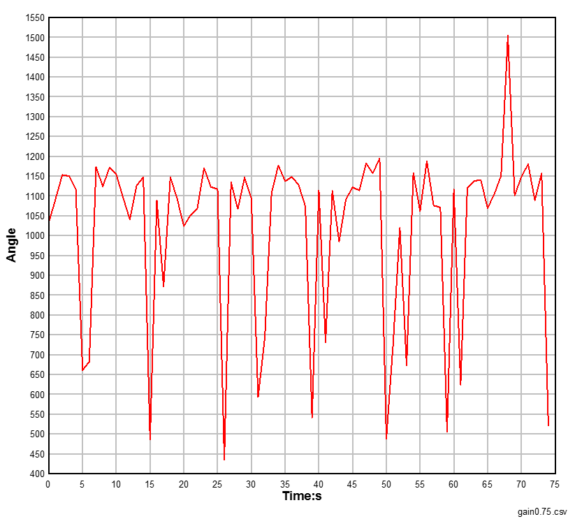

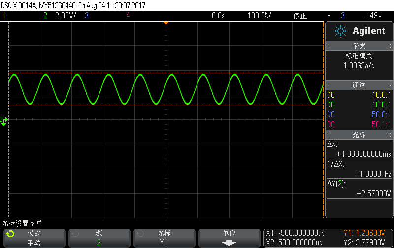

    When the motor output angle is near 1023(θ=90°, cosθ = 0),
    (1) Set the GAINCOS=GAINSIN=0.75,  angle values read unstable. The waveform of osin is shown in Figure 1. Figure 2 shows the angle  position output values .
                                                                                                      Figure1. OSIN signal
                                                                                Figure2. Angle position output values

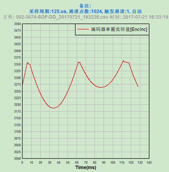

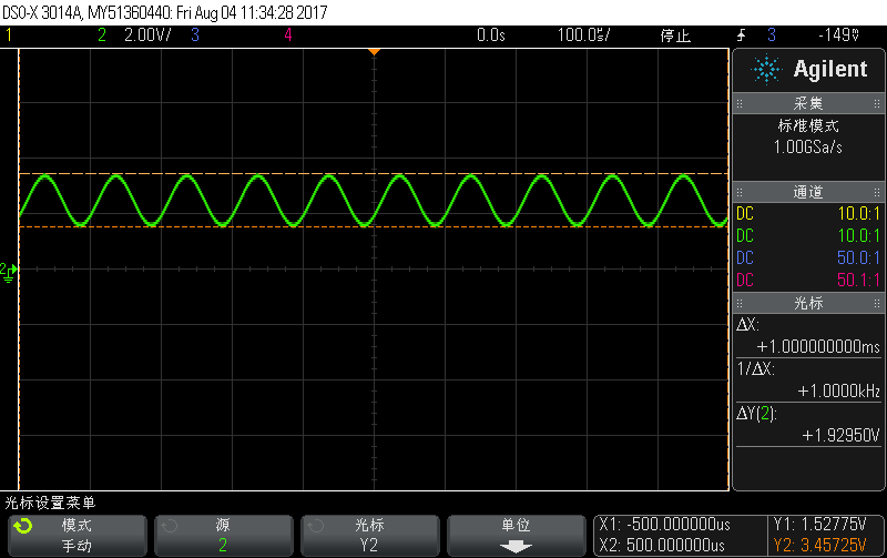

    (2) Set the GAINCOS=GAINSIN=1,  angle values read unstable. Figure 3 shows the waveform of osin, Figure 4 shows the angle position output values.
                                                                                                                  Figure3. OSIN signal
                                                                                                              Figure4. Angle position output values

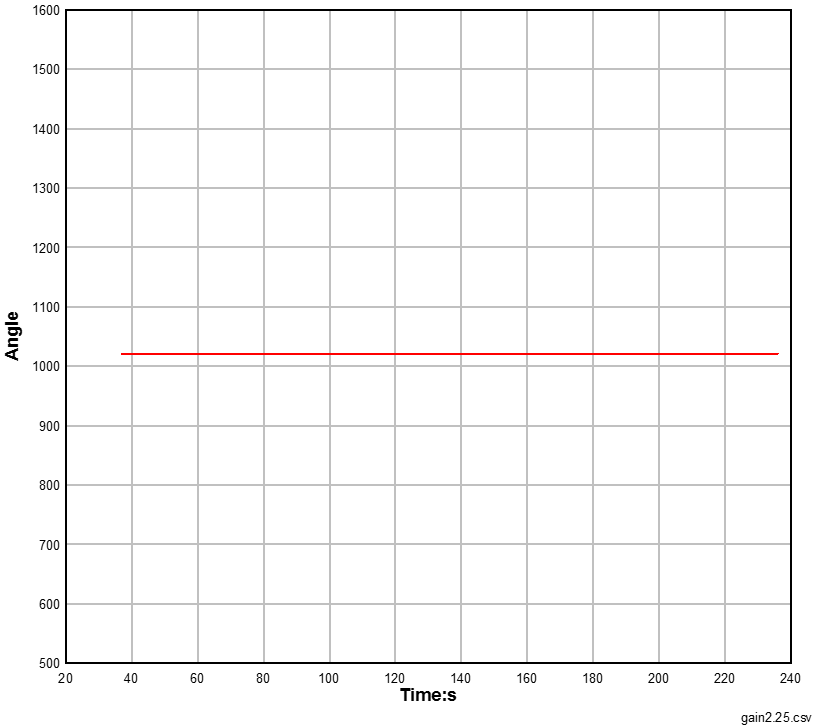

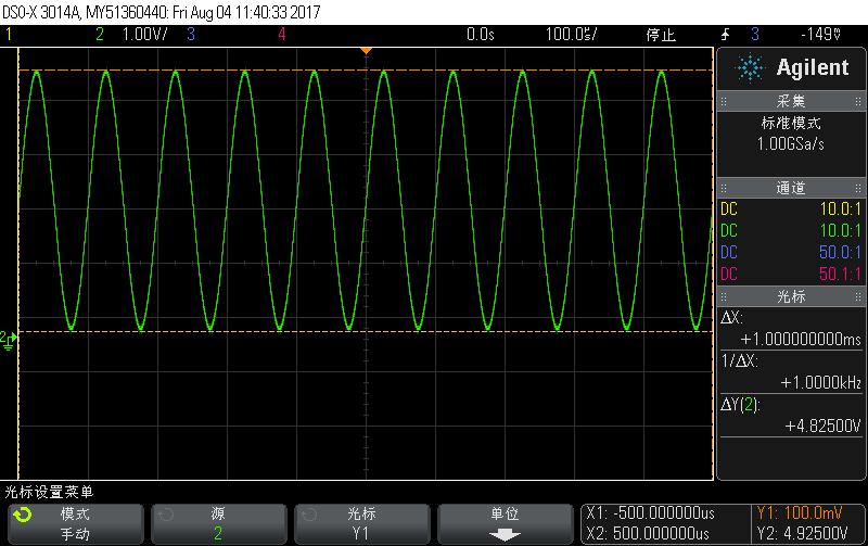

    (3) Set the GAINCOS=GAINSIN=2.25,  angle values read stable. Figure 5 shows the waveform of osin. Figure 6 shows the angle position output values. But the single-ended voltage of OSIN is from 0.1V to 4.925V,  out of range of 0.5V to 0.45V.
                                                                                                                Figure5. OSIN signal
                                                                                                         Figure6. Angle position output values

  • I know why this is happening. When you use the autophase feature, you need to set the AUTOPHASE_CFG bits in the DEV_OVUV4 register to 00 (enhanced auto phase by using short fault detection thresholds, OSHORTH and OSHORTL). With the setting that you currently have, you are using the "open fault detection threshold levels" for the enhanced autophase algorithm, OOPENTHH and OOPENTHL. For the enhanced algorithm to work, the thresholds you use must be set so that either OSIN or OCOS will always be larger than them.
    Right now, you are using thresholds that are larger than your typical OSIN/OCOS levels, so the autophase algorithm will have issues.
    -Clancy
  • Hi Clancy,
    Exactly as you say,angle values read stable.
