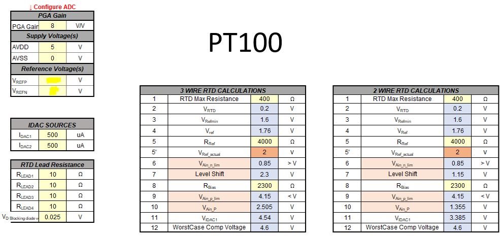

    2. I found using RRef = 4K and RBias = 2.3 K will be good to measure PT100 sensors and PT1000. In case of using PT100 the VIDAC1 is very close to maximum allowed level, is that ok?

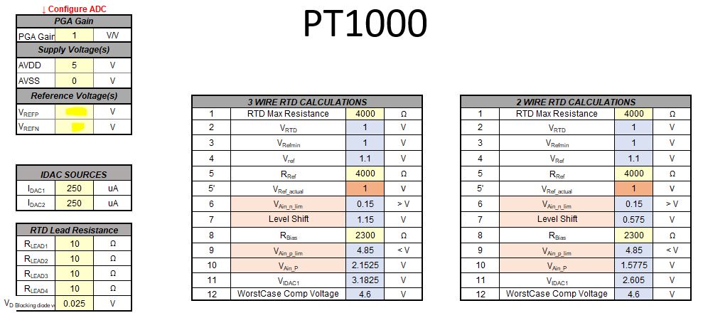

    3. And when measuring PT1000, gain of one is used and the Reference is only 1 V. Can the low reference be bad for the system? I know using low reference means sampling more noise in the ADC, but also amplifying the signal will amplify the existing noise anyway, I am not sure in practice if using low reference is a good or bad idea?

    1. Regarding to using two current sources for 2-wire and 4 wire RTD, will that cause any degradation in the measurement accuracy? [Bob] This would depend on how the current source is applied.  In the 2-wire case this should not be an issue as long as you apply the current using the second current source at the AINN input as the current summing mode is at the connector.  In the case of the 4-wire, the current must be applied where the lead resistance is not a part of the current path.  For the 4-wire case the current would need to be injected at node where the 4th lead wire connects to Rbias.
    2. I found using RRef = 4K and RBias = 2.3 K will be good to measure PT100 sensors and PT1000. In case of using PT100 the VIDAC1 is very close to maximum allowed level, is that ok? [Bob] Remember to include all voltage drops (resistors, diodes, etc.) in your final calculations and also remember resistor values and tolerances.  For example a 4k resistor might actually be 4.02k and 2.3k might actually be 2.32k.  Also consider any variation and drift of the IDAC sources.
    3. And when measuring PT1000, gain of one is used and the Reference is only 1 V. Can the low reference be bad for the system? I know using low reference means sampling more noise in the ADC, but also amplifying the signal will amplify the existing noise anyway, I am not sure in practice if using low reference is a good or bad idea? [Bob] There are always tradeoffs in the design when attempting to support a variety of sensors.  In the end it will depend on if you can achieve the desired temperature resolution.

  • Hi Bob,
    I will redo the calculations and consider the TVS, Schottky diodes and the current limit resistors on the IDAC1 path.
    1. I would like to ask about the AAF in front of the ADS114S08, I think the IDAC current will not flow through that path, so this will not affect the previous calculations? The effect will be a voltage drop in the ADC measurement?

  • Hi Mahmoud,
    The IDAC current should be routed in such a way that the anti-aliasing filter is not in the current path.  Take note of the ADS114S08 datasheet RTD example and see how the second IDAC is routed around the series resistance for the filter.  As far as using bipolar supplies, the IDACs are referenced to AVSS I'm not sure there is any benefit for RTDs.  For TC that may be referenced to analog ground (such as a grounded tip TC) there can be some advantage to the bipolar supplies.
