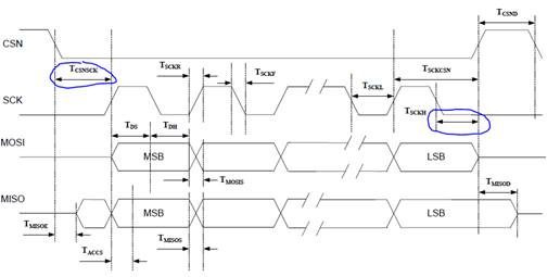

This first byte is usually also 0x05, but is sometimes 0x45.
This response (0x45) seems to appear when the Master and the Slave get out of sync.
For instance, if you perform a SPI transfer to a device on the bus and then change to a diffent device (same bus, different chip select) you get a 0x45 from the PGA900 on the next SPI transfer.

    According to the design Bit 23 is a diagnostics bit that is getting set if the device didn’t see 24bits clocked in during the NCS low time period… So it’s pretty much a bit frame error check.
    I think your setup might be too fast that you are pulling the NCS pin high at the end of the frame before you can allow the last bit to be clocked in… Or, it could be that you are already clocking in the first bit before you had the chance to pull NCS low at the beginning of the frame…
    Either way what the status bit is trying to say is that between NCS falling and NCS rising he didn’t see 24bits, so he’s complaining about it.
    So it seems like there is nothing wrong with the device, however, you do want to get this fixed, because the design also says that if this error is detected, the bit that didn’t get shifted in properly will be assumed 0…. So if you see a 0x45 that means your last SPI data was shifted in wrong.
