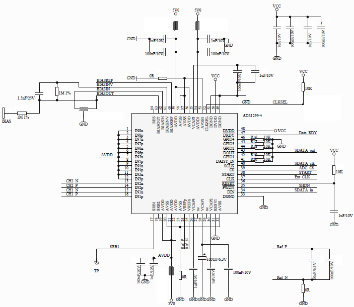

I am working on a custom board using ADS1299-4 , communication with the IC seems fine - ID number reads fine, control registers can be written and read, parameters such a continuous mode and sampling frequency seem to be set without problem. I am now at the stage to get data from ADS1299 but I am facing the issue of not being able to get valid data.
For example, for an uni-polar analog power supply of 5V, when using ADS1299EEGFE-PDK to read the mid-supply value through channel 1 I am getting ADC code of 0x00470F4D and voltage of 2,498142V which both seem correct. With my custom board, however, values I am getting are quite random and do not seem valid - while I am expecting to get ADC code of about 0x00470F4D what I am getting is a sequence of numbers quite random and different from each other, such as

  • Hello Kamen,
    Thanks for your question.
    Can you please share the register settings that you are using for the measurements on your board?

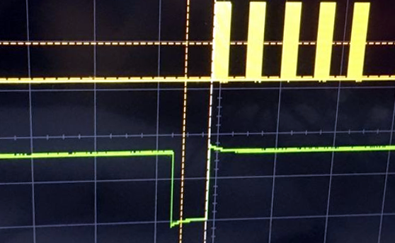

    To verify the device operation, you could try probing the reference voltage and the supply voltages to confirm they are configured as expected. I assume you are still using a unipolar 5-V supply and the internal 4.5-V reference? If you'd like, you can also share the ADS1299-4 section of your schematic and we can review the relevant connections.
  • Dear Ryan,
    Thanks for reply. Below I provide the required details. What I feel is that I am reading the data from the ADS1299 somehow in a wrong manner, however I can't yet figure out what I have overlooked.
    Indeed, I am using a uni-polar power supply 5V (measured it - the 5V voltage is fine), internal reference (measured voltage BIAS_OUT-GND, and BIAS_INV-GND - it is as expected 2.5V). On the schematic below BIASREF, CH1 P, CH 1 N, CH2 P, CH2 N, SRB1 are floating - not yet connected - I believe these do not need to be connected to see the correct internal test signals.
    The ADS1299-4 connection is as follows:
    ADS1299 configuration is as follows:

  • Hi Kamen,
    Thanks for the additional details.
    You mentioned that you are able to correctly read the ID register. Can you also confirm that you can read all of the device registers? This will confirm that registers are written correctly with the settings you listed above.
    If the register settings read back correctly, I would try to probe one or two data read periods with a logic analyzer and check the timing between the SPI signals (/CS, /DRDY, SCLK, DOUT). As you mentioned in your last comments, you may be overlapping a read transaction with new data, resulting in corrupted data. Each sample will begin with the 24-bit STATUS word, and the first four bits will always be 1100.
  • Dear Ryan,
    Thanks again for the useful advices. I eventually figured out a problem with the data reading:
    As shown in my code above I blindly followed the code examples that circulate online and didn't pay attention that the data read function supplies the required dummy bytes automatically, therefore the spi_write_byte(0x00) instruction before reading each byte in the data reading loop seems to have shifted all the results, causing a mess. Now the data I am getting from the device seem meaningful - test signals come out, when collecting electrode signals I am getting noise (no electrodes connected yet). Now I am facing new challenges: when setting mid-supply measurement, I am getting a code of 0x007FFFFF which seems like a meaningful value ( 23 bits "1" and and the Msb one "0" for the sign) but that still does not relate with what I hope to see -  values close to 0x00470F4D as mentioned earlier.
    Is it possible that any settings in the register setup reflect the code value for the mid-supply?

    To confirm the SPI communication has no problem, I have measured the signals on the SPI bus. So the question remains what I am overlooking and why I am getting 0x007FFFFF instead of the expected value for the mid-supply voltage.
  • Also, the DRDY - CLCK lines:
  • Hello Kamen,
    Thanks for your updates.
    I'll start with the latest question. /DRDY will return high in line with the first SCLK falling edge. This is not an issue with the device. You must use the falling edge of /DRDY to monitor for new data.
    Your register settings appear correct to read the MVDD measurement. I'm not sure what the implications of the Reserved bits are (bits 6:5 in CONFIG3), but you should confirm that you are writing the correct values to be sure. It is not expected to see bit 5 read as '0'. Please note that you should be reading data with SPI settings as CPOL = 0 and CPHA = 1. Data is shifted out on the rising edge of SCLK, so your uP should be latching the data on the falling edge.
    Also, you mentioned that the test signal amplitude does not change when you select the 1x or 2x options in CONFIG2? It certainly should make a difference, can you please share those results? Again - confirm that you can read the correct register values back from the device to be sure the settings have taken effect.
