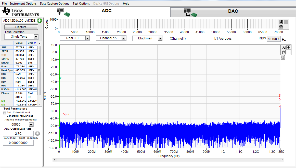

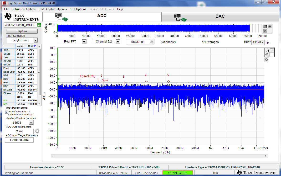

I am using the ADC12DJ3200EVM with the TSW14J57. I am following the instructions in the user guide SLAU701. I setup the ADC as detailed in 3.10.1 through 3.10.3. Then I go to step 3.11 and 3.12. I am supplying a filtered 1.91GHz signal at 0dBm to the VINA input (J2) of the ADC evaluation board. I see a raised noise floor. Can you please let me know what I may be doing wrong? Thanks. See images below:
With no input:
With 1.91GHz input
Jay

  • Hello Neeraj,
    1. I already have tried that. In JMODE0, you can see the FFT screenshot in my message above.
    2. I tried JMODE2. Below are the FFT images with NO SIGNAL
    Ch.A
    Ch. B
    It looks like something might be wrong with Channel B?
    3. The board rev says "ADC12DJ3200EVM REV E3"

  • Hi Umesh
    The Rev E3 board is not 100% compatible with the standard TSW14J57 settings provided with High Speed Data Converter Pro. Those settings are intended for the production Rev A board.
    Due to some logistics problems prior to release of the ADC12DJ3200 and ADC12DJ3200EVM some of the Rev E3 boards managed to get into distributor inventory. These should be replaced with Rev A boards.
    If you obtained your board through a distributor I recommend you initiate a return and have them provide a replacement board, first confirming the new one they are sending is a Rev A.
    If you have a time crunch and need to get the current board working now I can create and provide an updated configuration file(s) to enable the JMODE(s) you are using. Will files to support JMODE0 and JMODE2 be sufficient for your current testing?
