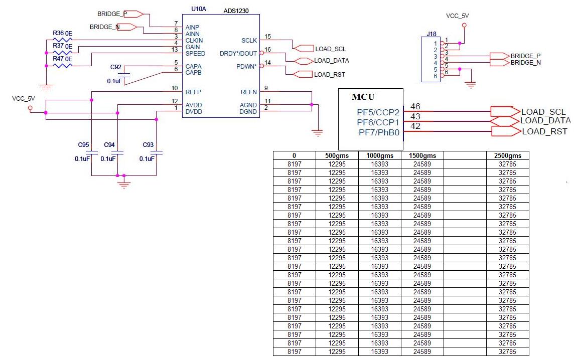

  • Dear Bob,
            Thank you for the response.
    Please find the attached file which gives the ADS1230 connections with MCU.Also I have pasted few reading which I got during testing.

  • Shenoy,
    I am confused about a couple of things. In an earlier post you said the GAIN input is high, but the schematic shows that it is pulled low. You also state that the load cell is rated for 100 Kg, did you mean 10 Kg? The data seems to come a lot closer to to 10 Kg. The data that you show, is it really that stable? I would suspect it to move around from reading to reading. Also in an earlier post you said you had alternating readings. Were you able to track down the source of that problem?
    Let's investigate this a little further. At 1.978 mV/V at 5V excitation, there is a maximum deflection of 9.89 mV. I am going to assume that the load cell is actually rated at 10 Kg, so that would compute to 989 uV per gram. At a gain of 64, one lsb would be 75 nV. Putting this all together excluding noisr, gain and offset error, 500 grams would produce a code of 6,593. 10 Kg would produce a code of 131,860. I find this number interesting as it is approximately 0x1FFFF, which is one of the alternating values you had mentioned previously.
    There will be an offset, do you run the offset calibration? If not, I would suggest that you run the calibration and retake the readings. Are the weights you are using calibrated weights? That is also important when verifying your system. Another thing to consider is the stability of your voltage source. This should be a clean supply. It may also help to use a larger cap at the reference pin. A 4.7-10uF cap can be used and should be placed as close as possible to th REFP pin.
    Looking at your data and subtracting out the offset at 0 V, the codes are about 2/3 the value they should be for 500 g to 1 Kg, but are double from 500 to 1K which would be correct. However, the more interesting pattern is that each reading changes by a factor of two for 500 to 1.5 Kg. That would be totally wrong. So I wonder a little about your code, and how you determine the values. Have you verified your data on an o-scope to make sure that your calculated reading from the micro is the same as the data reading displayed on the scope?
    Please verify to me the data via o-scope, the actual gain settings, stability of the readings and load cell maximum load.
    Bob B
    Sory for the confusion,Actually I started with GAIN input as in the schemtic(low).Then I wanted the check with Gain with 128 I pulled the GAIN pin to HIGH.(Just to mak FSR lesser).This gave me the similar readings by dobling the values.
    The readings are very stable!!Which made me very confusing.(This is the reason the weight of one gram is not recognised) As I mentioned in my previous post abt the alternating readings,please find the readings as below.I am taking  2nd set of the reading as my correct wait.( I am storing the values in a buffer and checking the buffer in debug mode.These values are for No weight kept and with GAIN PIN Pulled HIGH).
    0x01 0xff 0xff 0x00 0x40 0x09 0x01 0xff 0xff 0x00 0x40 0x09 0x01 0xff 0xff 0x00 0x40 0x09 0x01 0xff 0xff 0x00 0x40 0x09       ( for 0 gm)
    0x01 0xff 0xff 0x00 0x60 0x0D 0x01 0xff 0xff 0x00 0x60 0x0D 0x01 0xff 0xff 0x00 0x60 0x0D 0x01 0xff 0xff 0x00 0x60 0x0D     ( for 500gms)
    The voltage source is from the USB port of the LAPTOP.I will try this by using 10uF cap at REF pin.
    Please find the code for getting the data from the ADS1230.GET DATA function is called on each interrupt from the ADS1230.Calibrate function is called during PowerON.

  • Shenoy,
    I think we have a couple of things going on.  Regarding the alternating readings, it could be that because you are reading in debug mode, the actual data is not getting read ever 100 ms.  The second issue is with the 100KG load cell, you are trying to read weights that are acutally in the noise region.  The ADS1230 has effective bit resoultion of 17.5 bits.  See page 20 of the datasheet for a more detailed description of what is happening.
    You really need to look at the data/clk and read the data coming from an o-scope.  You can also verify my assumtion that the data is not being read quickly enough in the debug mode.  Also, you should see the lower bits moving around.
    What I can tell from your code is that you are clocking in the data correctly, but I'm not sure if the debug mode is handling your buffers correctly.  Verifying the scope data with the debug data should be done.  If at all possible, post the scope plots.
