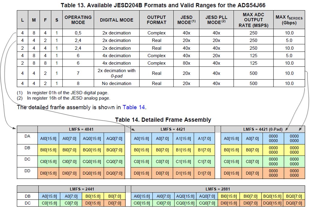

Let me ask you a question as below about operating mode of ADS54J66.
Q1) The data sheet describes below. (datasheet page38, table13 and table 14).
        is the line that i connect from the JESD MODE(up) to the frame assembly is the truth(especially the mode 8)?
Q2) in the mode 4421 (not the 4421 0-pad), there is a data named A1.
         is A1  the next sample data of A0?
Q3) in the datasheet, (datasheet page38, table 59).
what's the function of the LC register(low resolution counter value) and the HC register(high resolution counter value).
Is it possible to use operating mode "8" (No decimation) in case LMF=244?
I suppose it is possible but let me confirm this to you for sure.

    Q1. Yes
    Q2. A0 is the first sample for Channel A, A1 is the second sample for Channel A and so on.
    Q3. These will be removed from the data sheet. I have attached a preliminary draft of what we are currently working on. These are still
            shown in this draft but will be removed.
    Q4. No. You cannot operate mode 8 in LMF = 244.

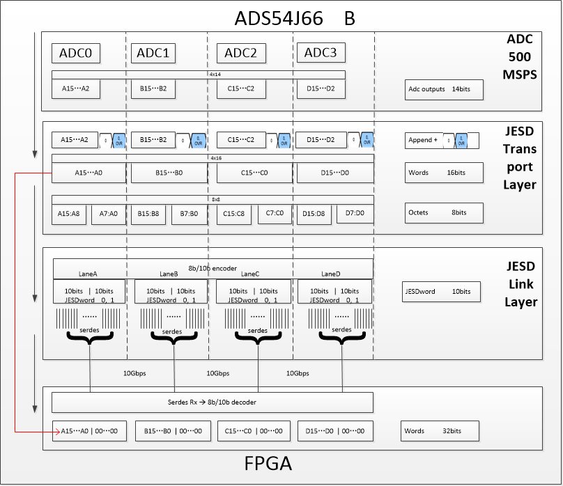

            And i have another question about the dataflow and its data format of this device( from adc to jesd204b( transport layer, link layer)). about this question, i a draw a data flow diagram.
            but it is a pity that i leave it in my company. so, i will upload it in tomorrow,  please comfirm it for me.
    qiu xu

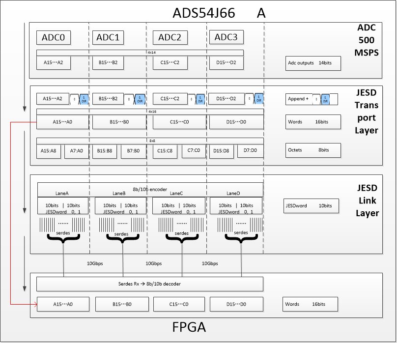

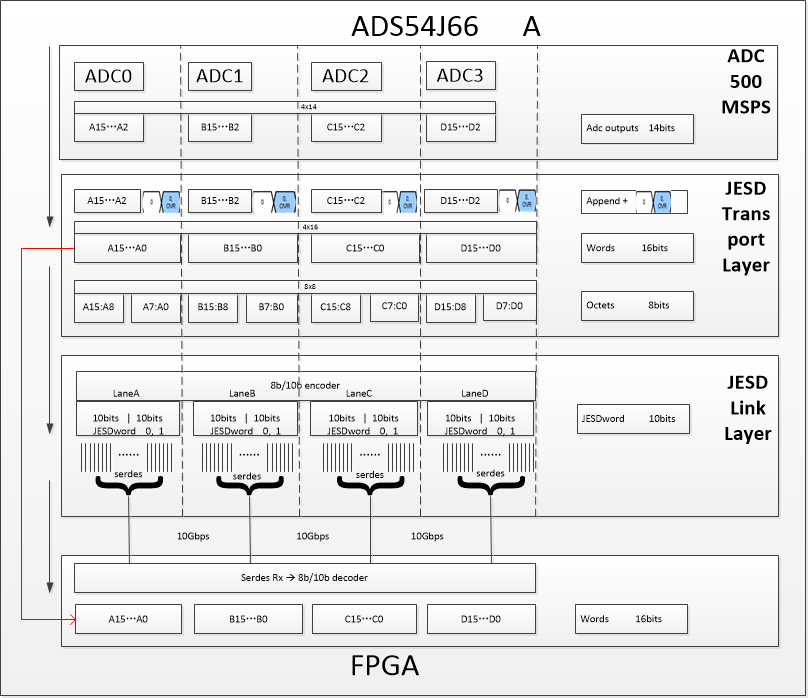

  • Jim,

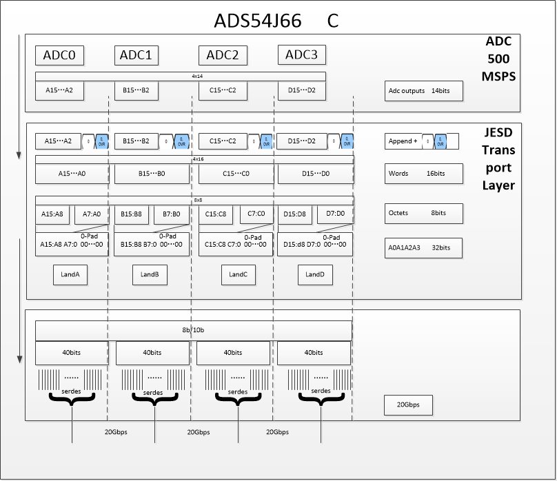

            I have another question about the ADS54J66's datasheet, it make me feel puzzled. About this data flow diagram question, i spend some time to draw some drafts to make my question more clear. there are be named "ADS54J66      A" , “ ADS54J66      B” , “ADS54J66      C”. I post them below.
             these question are related to the OPERATION MODE 8.
    Q1 > The three data flow diagrams below from ADC outputs data stream to the JESD204B output bit stream, which one is the correct understanding?
             If none of them is right, please help me confirm which one is closest to the right answer.
    Q2 > I tend to think that "ADS54J66      A" is right, but in the datasheet (page 38, table 14),  the subtable (named LMFS = 4421( 0-pad )) which is related to the operation mode 8, there are 16bits 0 fallow A0[15:8] A[7:0], i don't know these zeros come from where ?
             So i drawed the daft B and C.
    Q3 > About the “ ADS54J66      B”, i think may be the serdes Rx or the JESD204B Rx register is 32 bits ,so when they deal the 16bits data, they must append 16bits zeros. so i can ignor these zeros?
            So, when i desgin the FPGA receiver, i should also use a 32 bits register to get this data, and just ignor the low-16bits?
    Q4 > About the “ ADS54J66      C”,i also doubt its correctness, because it even use 20Gbps.
    Q5 > The red line in “ ADS54J66      B”, can i think the data at the ends of the red line are equal?
    Q6 > I want know, after the SERDES RX and JESD204B RX, the data i get in FPGA is the ADC output data append 0 and OVR. is this understanding the right?
  • maybe the operation mode use the  data frame assmebly LFMS=4421 in table 14 not the LMFS=4421 0-pad?
  • jim,
            maybe the operation mode 8 use the  data frame assmebly LFMS=4421 in table 14 not the LMFS=4421 0-pad?
    qiu xu
  • User,
    That is correct. Mode 8 uses LMFS = 4421, no 0-padding.
    Jim
