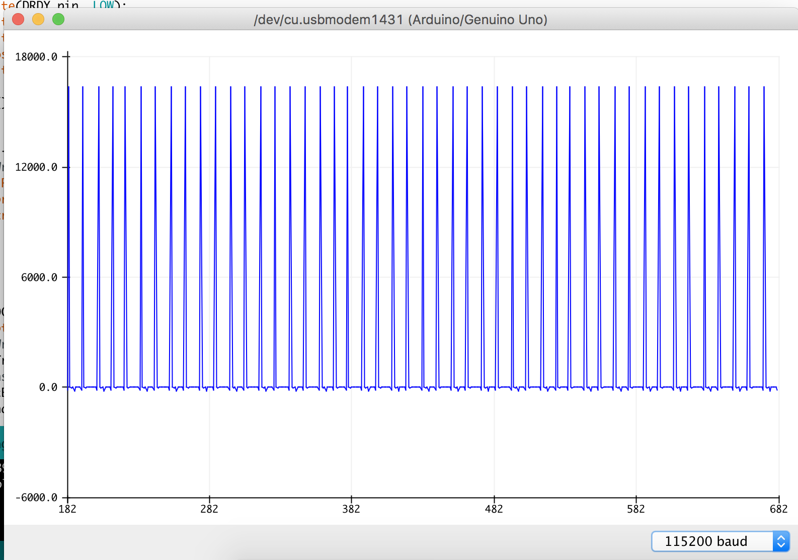

When this setup is completed and the Arduino connected to power, the ADS127L01EVM lights up (so it seems things are connected properly).
The difficulty comes when I upload my program to read conversion results. I connected a 3.3V DC voltage to the terminal block and I get this output:
What's good is that it looks like I'm clocking out data from the device, but what's bad is it's nonsense. The periodicity of the "spikes" looks like the problem could originate from the void loop() function in the Arduino program, but I'm unsure. I am returning unformatted data (not converting to voltage, hence the y-axis scale).

    1. If you wish to control the START pin with your Arduino, you'll need to make a jumper wire from the low side of R67 (connected to the START pin), not from the DVDD test point (TP21). This resistor pulls the START pin high to DVDD to leave the ADS127L01 converting continuously.
    2. If JP11 is uninstalled, then there is nothing connected to the digital supply for the ADS127L01. Do you have an external supply shorted to JP11[2]? In fact, since you tied TP21 to your Arduino, you are effectively toggling the digital supply each time you try to pull START high or low. I believe this is likely the main issue.
    3. Did you mean FILTER[1:0] = 01 (Wideband 2 filter) or FILTER[1:0] = 10 (Low-latency filter). I'm assuming you're using the Wideband 2 filter since you mentioned running the ADC at 512kSPS.
    4. JP1 should be installed and the remaining jumpers should be in their default position.
    The analog supply (AVDD) is connected to 3V. Therefore, you should not be applying a 3.3-V DC input to J8. 3.3V is right at the Absolute Maximum Ratings to avoid device damage, but this is beyond the Recommended Operating Conditions. Also, the reference voltage (VREF) for the ADS127L01 is 2.5V on the EVM, so the ADC cannot convert a differential input greater than that anyways.
