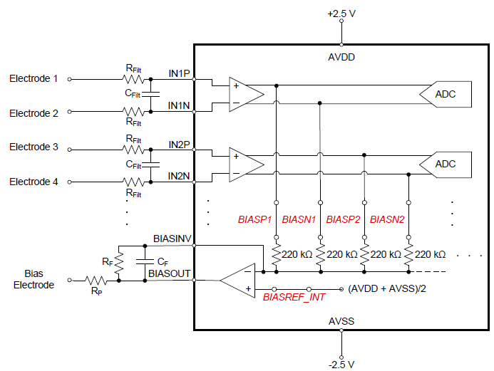

    What is connected to the inputs during this test? If you have lead-off detection enabled and the inputs are not connected to a signal source, then they will be pulled internally to the positive or negative supplies. Then, if those inputs are selected for the BIAS derivation, the common-mode output of the BIAS amplifier can change significantly.
    If the inputs are connected and the BIAS output is still railing, try reducing the gain of the PGA and/or the BIAS amplifier. The BIAS amplifier gain is set by the feedback resistor (Rf) and the number of PGA outputs selected. Each PGA output is connected in parallel to BIASINV through a 220-kOhm resistor, so the gain is (Rf / (220k || 220k || ... )).

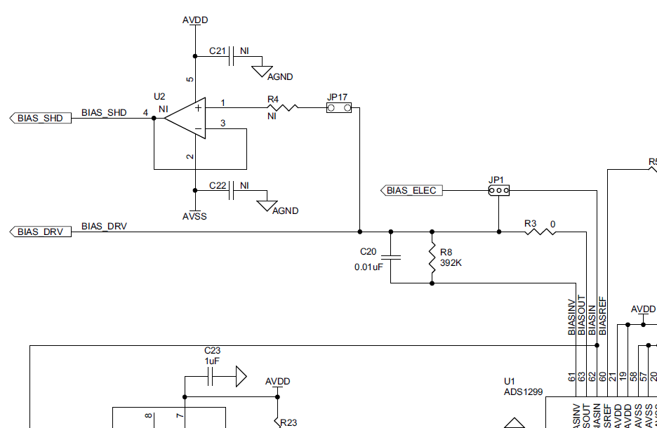

    - perhaps shielding of electrode connecting wires is worth to try - however, as there is an option for active shielding in ADS1299EEG-FE, does it worth to try active shielding in the custom board? Could I expect any significant decrease of external disturbances in this case?
    If your electrode cables are coaxial, you can try tying their shields together and driving it with some common-mode signal. Ideally, you want the common-mode signals on the shield to match the common-mode signals on the electrodes, which will reduce the capacitive coupling between the two. Essentially, this means you should drive the shields to the inverse of BIASOUT.

    - while we want to drive the shield with the inverse of the BIASOUT signal, the shield driver implemented in the
    ADS1299EEG-FE (see image below) does not seem to invert the BIASOUT signal, is that still fine?
    - I am a bit confused of the ADS1299 datasheet in terms of PGA output resistors - it is written there that "330-k? resistors at each PGA output are in parallel for common-mode signals.", while in the figures values of resistors at the outputs of PGAs are shown as 220k - are the same resistors referred in both cases, is 220k the correct value?
    - Some clarification regarding the PGA and configuring the bias calculation is welcome:

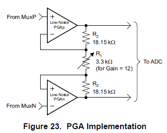

    On Fig. 23 of the datasheet, the PGA structure is shown like this:
    while in the following figures it comes as:
    I guess the last one is correct and perhaps the one from Fig. 23 has omission in exchanging the inputs of the lower OA? If so, that also explains why we can get the common mode voltage at the output of the PGA - the common mode voltage acts in the same direction to the both non-inverting inputs, and thus at the outputs of the OAs the common mode signals sums up. Is that assumption correct?

    1. I believe that was an oversight on the EVM design. You will want to invert the BIASOUT signal to drive the cable shielding.
    2. "330k" is a typo, the correct value is 220k for the summing junction resistors connected to the BIAS amplifier. I will make a note to update it in the next datasheet revision.
    3. Both figures are correct. The first (Figure 23) is only showing the channel input path connected to the ADC. The second figure shows how we connect the same PGA outputs and route them to the BIAS amplifier inverting input through series 220k resistors. This is illustrated more clearly in Figure 72.

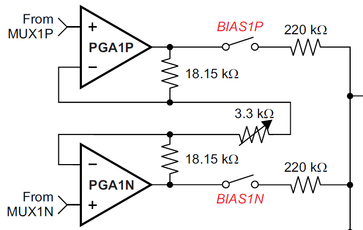

  • Dear Ryan,
    thanks for the answers. Let me clarify the last question: I believe the schema form fig. 23 contains a mistake since the inverting and non-inverting inputs of the lower operational amplifier seem exchanged - in this case the lower OA seems to have a positive feedback... Thus I believe that is an omission of the datasheet and wanted to confirm that.
    Kind regards,
    Kamen
  • Hello Kamen,
    You have found an error in the datasheet. :) MuxP and MuxN should connect to the amplifiers'  non-inverting inputs and the feedback paths should connect to the inverting inputs.
