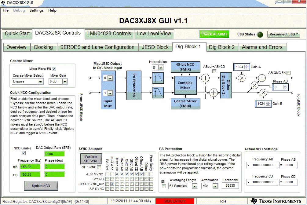

Mode:4421,data_reate=312.5Msps,8x interpolation,DAC_CLK=2500MHz(external)
K=16,ref_clk=156.25MHz,SYSREF=19.53125

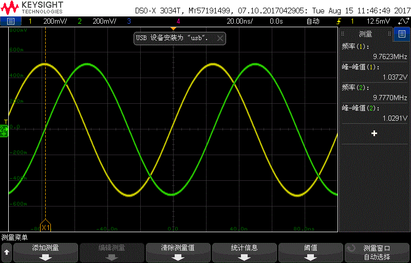

Bypass Mixer Block,DAC output is about 10MHz single tone(IQ):FIG1

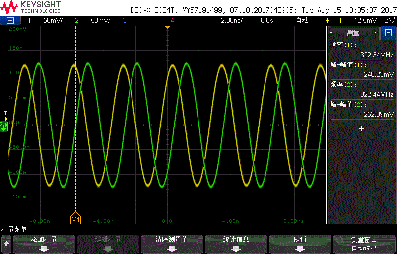

Enable Mixer Block with Course Mixer Mode = Fs/8,Output is right:FIG2

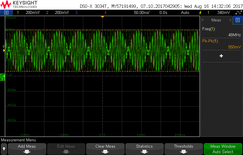

I would like to use NCO Block,So Enable Mixer Block,Course Mixer=Bypass,NCO Enable:register Config2=0x20D0,
but the output is not what expected?
my SYSREF is continuous,so NCO Accu syncing source can not be 'SYSREF',I tried all the other configurations,NCO seems not working right.
Anything i missed?
