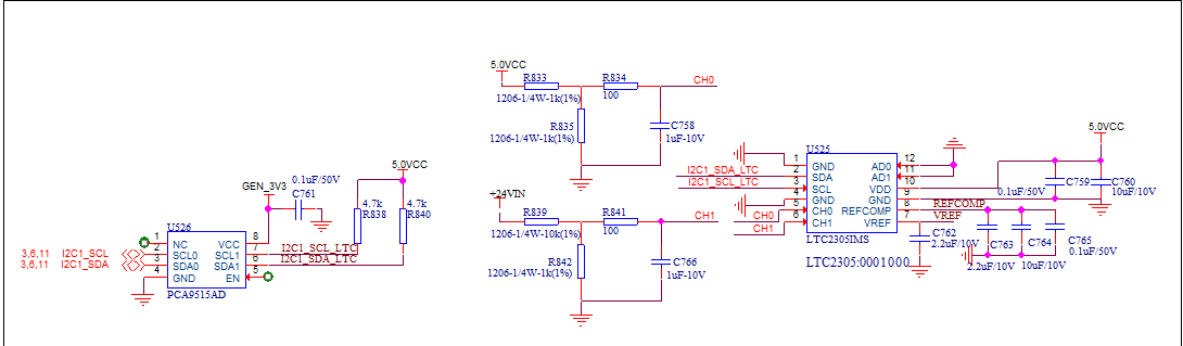

Now in my design, i use ltc2305 with two channel to monitor my input power 24V and another 5V power ,schematic like that the device should be more cheaper than LTC2305,can somebody reply to me timely?

Hi user4973896,
if you are open to using a delta-sigma ADC instead of a SAR ADC then you might want to look at our ADS1015 as a potential option.
Let me know what you think.
