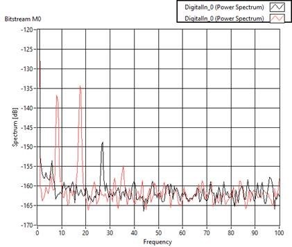

We are using the ADS1281 in one of our designs at CERN to measure the current on the magnets of the accelerator. It's a low frequency, high resolution, high precision measurement and we need performance at the part per million level.

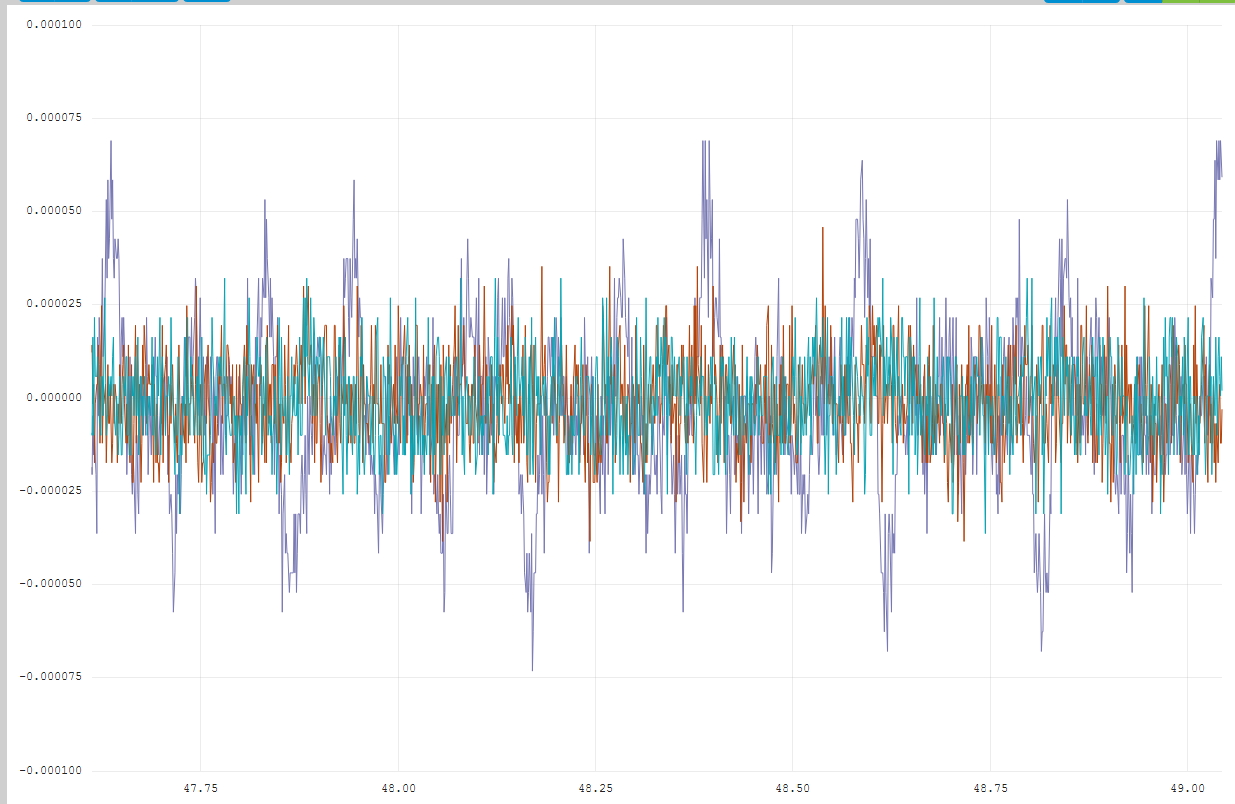

When testing some of our ADS1281 boards, we have observed very low level, low frequency periodic tones which do not exhibit the linear frequency-voltage characteristic of Sigma-Delta idle tones. The frequencies of the tones are slightly different between different ADCs (≈1 Hz), but the amplitudes differ by up to 15 dB in the investigated units. In some they don’t pose a problem, in others it’s at the limit of what could be problematic for us. The amplitude is quite small, in the worst case we saw a tone of about 6.5 uV pkpk at a frequency around 10Hz.
 These tones seem to come from the ADC and not from the signal conditioning circuit or the input signal: the analogue input of the ADC was studied carefully with a high-gain, low-noise differential amplifier. No signals resembling the tones were seen. A common coupling mechanism, e.g. through the supply lines, voltage reference, or common-mode bias voltage, can be ruled out because we have three ADS1281 channels in the same board and in different cases some of them don’t show the tones while others do, at different levels.
To evaluate the problem, which we saw after filtering, we obtained the bitstream from M0 and M1 for 1 unit to see if the problem can be seen in the bitstream. The results are below for two different ADS1281 channels.

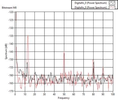

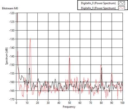

I also show below the M0 and M1 full-bandwidth spectra for two devices – please notice the “bad” device that has the high tones also has somehow different distribution of the regular idle tones. More of them appear in the M1 stream. Also, the sidebands around the idle tones seen in the M0 stream are different. One of the hypothesis we discussed was that could be related to the dither. A colleague suggested perhaps it’s the spread of the amplitude or frequency of the internal dither generator or some kind of beating with other frequency? Or an aliased version of that.
We would be grateful if someone could help us with some hints. For the moment we are replacing the ADCs that show this tones at a non-acceptable level for us. We consider that below 1.5uV pk pk the problem is negligible for us.

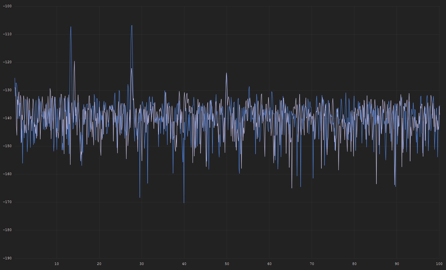

    The idea of showing separately M0, M1 was to help understanding where the tones could be coming from, within the ADC chip, if indeed they were coming from there. Obviously the problem was first detected on the combined and filtered bit stream output and it was only when we started investigating and reached the conclusion this could be coming from within the ADC that we decided to look at M0 and M1 separately.
    Below I show the spectrum of the combined and filtered bit stream, as we use it in our application. Please notice that this is not the same unit as from my original post, as that unit was not available today. So I used another unit where these tones are also visible. The FFT below shows two ADC channels. One is clearly worst (>10dB difference)
    For information, we have more than 1000 boards installed in the field with this ADC, in operation for half a year now. We have detected this problem only in a small number of them, and it's not really a problem for operation for now. As I said, we suspect these tones are present in all units and they are just too small to be seen.

  • The graph in the previous post was obtained with the inputs short circuited to ground.
  • I would like to add that we are not using the internal digital filters of the ADS1281. We are using our own digital filter. That is also why we wanted to send you the original bit stream showing that the tones are there before the digital filter.

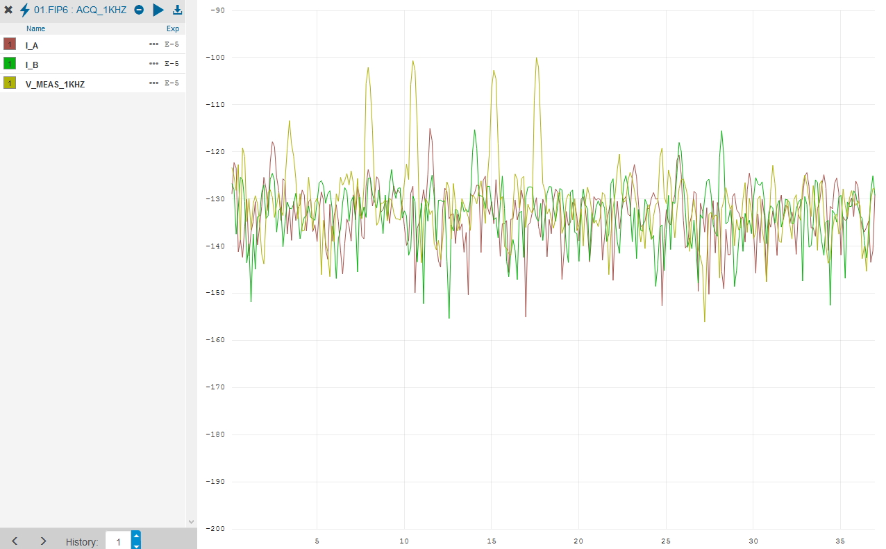

    As promised, I am back to this subject after mounting a ADS1281 chip considered to have the unusually high amplitude low frequency tone on a channel that had another ADS1281 that didn't show the issue. We verify that the problem follows the ADC chip.
    In the first image of the FFT the worst channel is shown in yellow(ish) and identified as Vmeas. We see low frequency tones at around 10 and 15Hz. The other channels IA and IB show tones but with more than 10dB less amplitude.
    The second image shows the result after swapping the ADCs between the bad channel (Vmeas) and one of the others (Ib). In the picture the worst behaviour is now corresponding to the green curve (Ib). So the tones follow the chip.
    It is interesting to observe though that the frequencies of these tones are not repeatable. They seem to move from one test to the other. They are probably aliased versions of some other frequency or a "beating".
