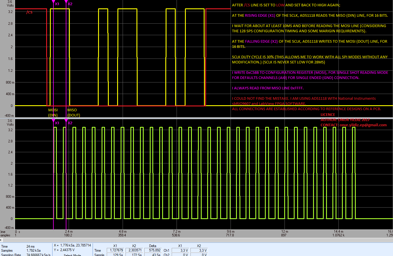

I could not read the SPI MISO line of ADS1118. I have tried to read the temperature sensor, but MISO line is always read as "HIGH". I am posting an illustration, which gives more information about my configuration and my problem.
Thank you for your help,
