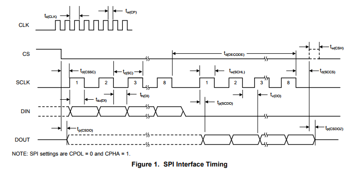

I think there is a problem with the documentation for this converter in that whether CPAH=1 or CPAH=0 in regards to the SPI mode.  If we go on ever reliable wikipedia we find the following information:
  • At CPOL=0 the base value of the clock is zero, i.e. the idle state is 0 and active state is 1.
    • For CPHA=0, data is captured on the clock's rising edge (low→high transition) and data is changed at the falling edge (high→low transition).
    • For CPHA=1, data is captured on the clock's falling edge (high→low transition) and data is changed at the rising edge (low→high transition).
  • At CPOL=1 the base value of the clock is one (inversion of CPOL=0), i.e. the idle state is 1 and active state is 0.
    • For CPHA=0, data is captured on the clock's falling edge (high→low transition) and data is changed at the rising edge (low→high transition).
    • For CPHA=1, data is captured on the clock's rising edge (low→high transition) and data is changed at the falling edge (high→low transition).
And:
SPI ModeClock Polarity
(CPOL/CKP)
Clock Phase
(CPHA)
Clock Edge
(CKE/NCPHA)
0 0 0 1
1 0 1 0
2 1 0 1
3 1 1 0
When looking at the data sheet for the ADS127L01 we see the following:
Which although stating CPHA = 1 the timing diagram is consistent with CPHA = 0 as data is changing on the rising edge and been latched on the falling edge (Page 12).  Furthermore in the text it is stated "Only SPI mode 1 (CPOL = 0, CPHA = 1) is supported".  I have used this ADC before with a TI MCU where I used (TivaC):
SSIConfigSetExpClk(SSI0_BASE, SysCtlClockGet(), SSI_FRF_MOTO_MODE_1, SSI_MODE_MASTER, 20000000, 16);
So I would guess that the error is the timing diagrams? or I am in someway confused?  I do have my development system with the MCU still but I would probably have to do quite a lot of fiddling to get reliable results on this due to the large phase shifts in that system (flying leads).
James.
  • Hello James,
    Thanks for your question.
    James Lawson77 said:
    ...the timing diagram is consistent with CPHA = 0 as data is changing on the rising edge and been latched on the falling edge (Page 12).
    This is actually consistent with CPHA = 1, which you initially described correctly as:
    The rising edge of SCLK will shift the data into or out of the ADS127L01. Data coming into DIN will be latched on the SCLK falling edge, and the same applies to the data which comes into the MCU from DOUT.
    If you focus on the tsu(DI) and tp(SCDO) specifications, both use the rising edge of SCLK to mark the time when DIN and DOUT are changed. DIN must be stable at least tsu(DI) before the SCLK falling edge in order for the ADS127L01 to latch the data correctly. tp(SCDO) guarantees that DOUT will be stable for the MCU to read no more than 15ns or 21ns after the rising edge of SCLK, depending on the supply voltage.

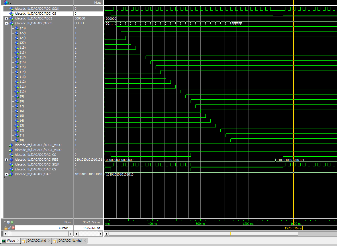

  • Many thanks this is now clear to me.  I do find it slightly odd that this part has a hold requirment while other parts I am using such as the DAC8830 do not,.  I think these new waveforms will be correct for  both parts:
