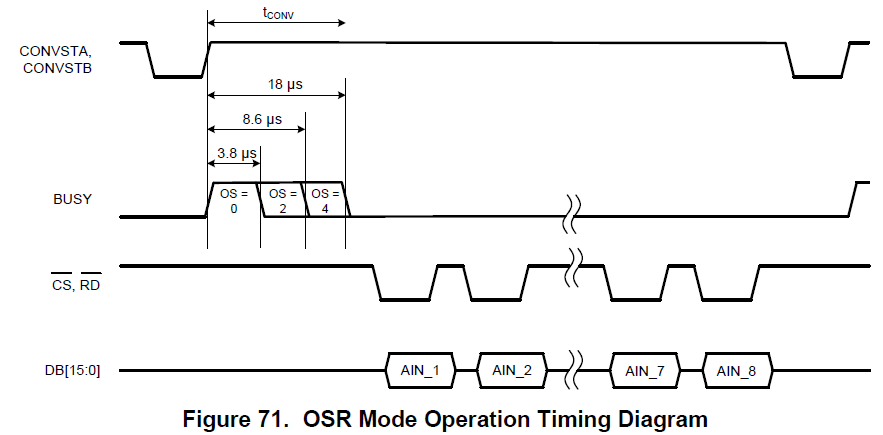

When ADS8588 oversampling is set to 4, want to check which of the following condition is true for each channel?
1, The sample and hold function only works once while digital conversion cycle 4 times.
2, Both S-H and Conversion work 4 times.
