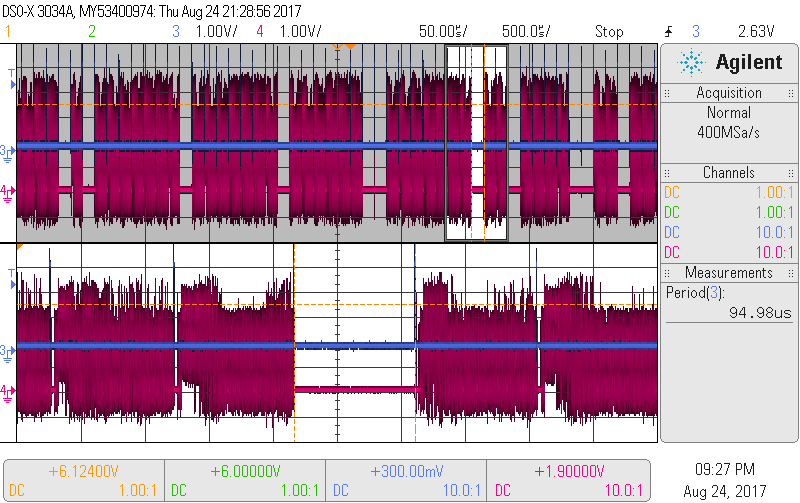

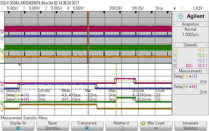

The attached figure shows the SH_R signal (in blue) sending a pulse every 95us and the DOUT6 (pink), where the dead frames can be appreciated every now and then.

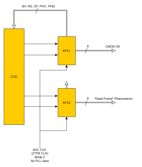

    Exactly, the second AFE does not provide the control signals to the CCD, it is only used for sampling and AD-conversion.
    However, since both AFEs get exactly the same ADC clock from an external source (no PLL to minimise timing issues), and if we also assume some individual (but constant, a few ns) AFE component timing differences regarding the ADC exists, this can be compensated with the sampling fine-tuning settings (clamp-time and sample-time).
    Firstly, such an issue should not result in ~10-20% dead frames, but in 100% of the frames having bad shape (due to bad timing, its either bad or good but has no jitter).
    And additionally, we tried to adjust the sampling timing by modifying the fine tuning, but with no effect on the dead-frames whatsoever (of course the good frames changed and shifted according to the new sample timing settings).
    The figure below shows the block diagram of our system:

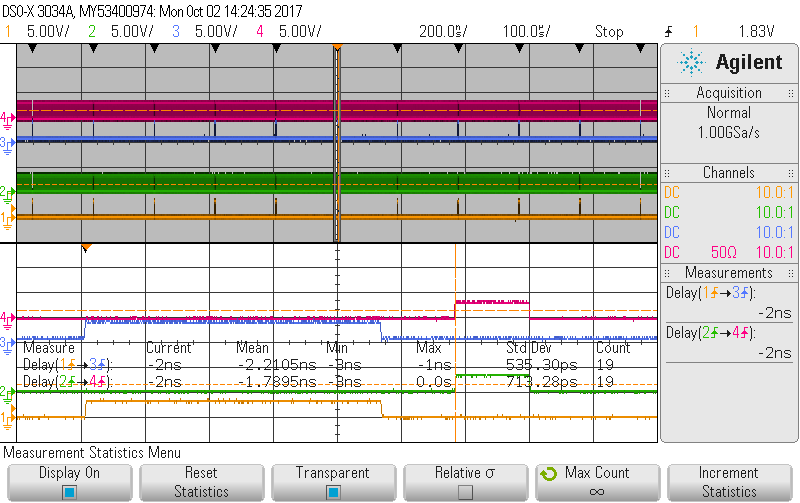

    The following figure shows the SH (SH1 output) and RS signals of both AFE #1 and AFE #2 in the working state, where:
    - Yellow: SH of AFE #1
    - Green: RS of AFE #1
    - Blue: SH of AFE #2
    - Red: RS of AFE #2
    In this case, all SH and RS signals are perfectly and consistently aligned within 1 to 2 ns, so the sampling is therefore always correct in both AFEs, as shown here:

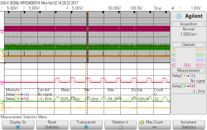

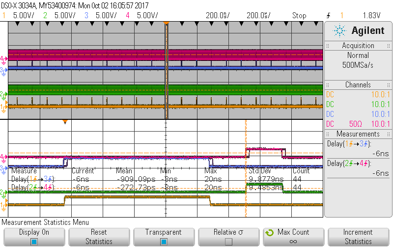

    In the next figure we can see the state where the AFE #1 is sometimes delayed with respect to the AFE #2 (the jitter appear to be in the AFE #2, simply because the oscilloscope's trigger is in the SH of the AFE #1),
    and consequently the sampling signals do not match:

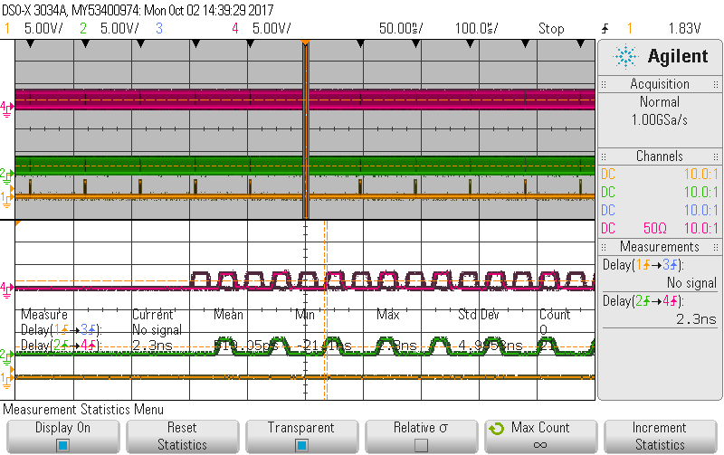

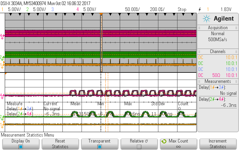

    On the contrary, the next figure shows how the AFE #2 is sometimes delayed with respect to the AFE #1.
    Both AFEs get exactly the same SH request signal, and the outcome is that one of the AFEs, in the 1% of the cases (after system reset or AFE full software reset), generates sometimes (around 10%...20% of the SH request pulses) the SH interval around ~20 ns delayed (almost half the pixel period), leading to a wrong sampling of the CCD data.
    We also run an automated test setup with 20.000 test cycles, performing resets with signal integrity check, and exactly 2.1% had the faulty state (i.e. 1.05% for each AFE).
    So there seems to be some general and systematic situation inside the AFE chip, which in 1% of the startup cases leads then to this delay suddenly and sporadically happening until next full reset. This also suggests that there is no fix other than a "init - check - reinit - check" loop at device startup...
