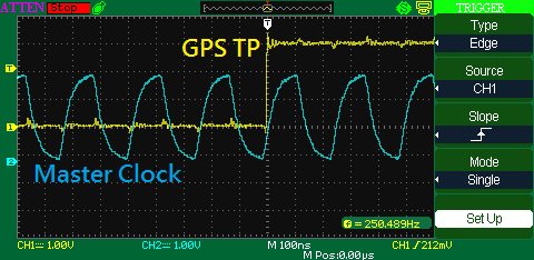

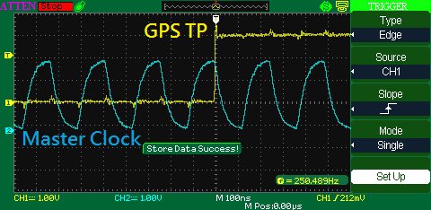

  • Hi Chris,
    Thank you for the answer.
    As you can see in the picture above, there is drift between GPS TP signal and master clock.
    Therefore, the SYNC rising edge may not match the falling edge of the ADC's master clock.
    (The master clock uses a 4.096 MHz oscillator, and the GPS module uses its own internal clock.)
    In the figure, the master clock looks like a sine wave because of a bad probe.
    Actually, it is outputted as a square wave.
    KJ Park.
  • Hi KJ,
    Unfortunately, if these clocks are drifting too much with respect to one another then continuous-sync mode will regularly re-sync the device. If the drifts of each clock are smaller, then re-sync will occur less often; however, this mode really works best when the SYNC clock and ADC master clocks are derived from the same clock source.
    For continuous sync mode, do you have multiple ADC's in your system that need to stay synchronized, or do you just need to ensure that the ADC is operating at a very accurate data rate?
    Perhaps there is an alternative way of using your MCU to "re-clock" the GPS pulse so that the SYNC pulse and ADC clocks are derived from a similar source. To do this, you would likely need to create the ADC clock from your MCU clock. If this is not an option, then likely using pulse-sync mode in one way or another would be the next best option.
    Chris
