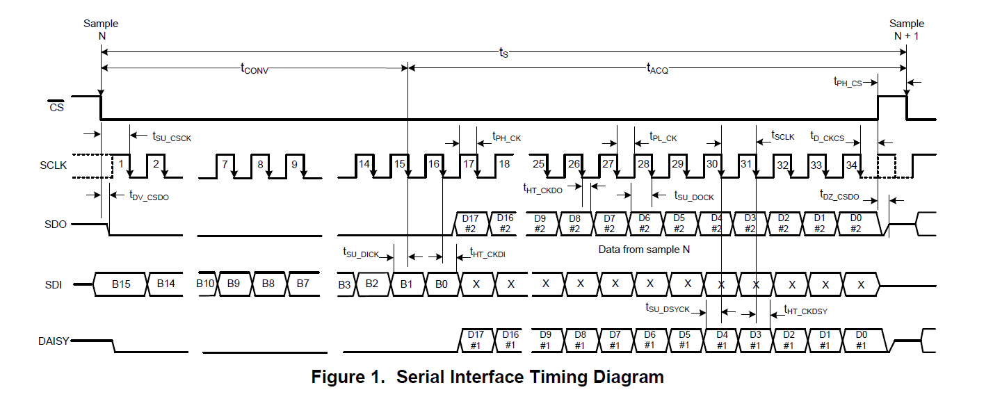

  • Hello Clark,
    Unfortunetly we do not have sample code for the device.  The most common issue when communicating with devices is timing errors. I would suggest to look closely to the timing diagram in the datasheet.
    If you have any inquiries concerning the MSP430, I suggest posting again in their desginated forum area.
    Cynthia

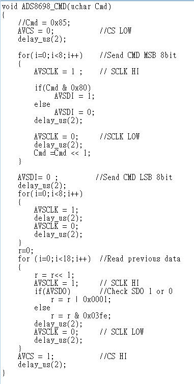

  • How can i know that command is sent correctly?
    if i want to send a RST command
    my command like that: (Cmd = 0x85)
    void ADS8698_CMD(uchar Cmd)
        //Cmd = 0x85;
        AVCS = 0;		//CS LOW
        delay_us(2);
        for(i=0;i<8;i++)    //Send CMD MSB 8bit
            AVSCLK = 1 ;    // SCLK HI
            if(Cmd & 0x80)
                 AVSDI = 1;
            else
                 AVSDI = 0;
            delay_us(2);
            AVSCLK = 0;     //SCLK LOW
            delay_us(2);
            Cmd =Cmd << 1;
        AVSDI= 0 ;         //Send CMD LSB 8bit
        delay_us(2);
        for(i=0;i<8;i++)
            AVSCLK = 1;
            delay_us(2);
            AVSCLK = 0;
            delay_us(2);
        r=0;
        for (i=0;i<18;i++)  //Read previous data
            r = r<< 1;
            AVSCLK = 1;     // SCLK HI
    	if(AVSDO)	//Check SDO 1 or 0
    	    r = r | 0x0001;
    	else
    	    r = r & 0x03fe;
    	delay_us(2);
    	AVSCLK = 0;	// SCLK LOW
    	delay_us(2);
        AVCS = 1;		//CS HI
        delay_us(2);
  • Yes,
    If you want to send a RST command, you would use x8500h. More commands are shown in table 6 in the datasheet. Note that there are 16 bits though, even though the 8 least signifact are all zeros.
    In general if you want to double check that the registers are programmed correctly:after you program the registers, read them to be sure the values you assigned are correct.
    Cynthia
  • Hi Cynthia:
    Thank you for your reply ,
    All problems are solved, it works normally.
    Clark
