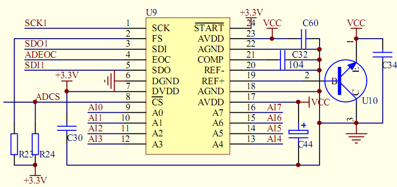

hello, everybody! Recently ,I have been getting stuck with the communication between dsPIC33FJ64 and
TLC3578.I initialized and configured the TLC3578 according the TLC3578 datasheet,but it doesn't
work,always reading 0x0000.I can't know why.I am sure my SPI protocol is absolutetly right.Have
anybody  used TLC3578 before ?Could you give me some sample code or explains it to me?
Thanks a lot.
Following is my source code.

while(1)
 SADres = ReadAD(0X07);
//************************Program main loop ends**************************
WORD ReadAD(BYTE CHx)
  int tick;
  WORD AD_res,tmpad;
  //tick = 10;
  //CHx = 0x7000;
  ADCS = 0;
  Nop();
  SPI2BUF = 0x7000;
  while(!SPI2STATbits.SPIRBF);
  //ADCS = 1;
  while(ADEOC);
  //tick = 10;
  //ADCS = 0;
  SPI2BUF = 0x0000;
  AD_res = SPI2BUF;
  SPI2STATbits.SPIROV = 0;
  ADCS = 1;
  AD_res /=4;
  AD_res &= 0x3FFF;
  return AD_res;
