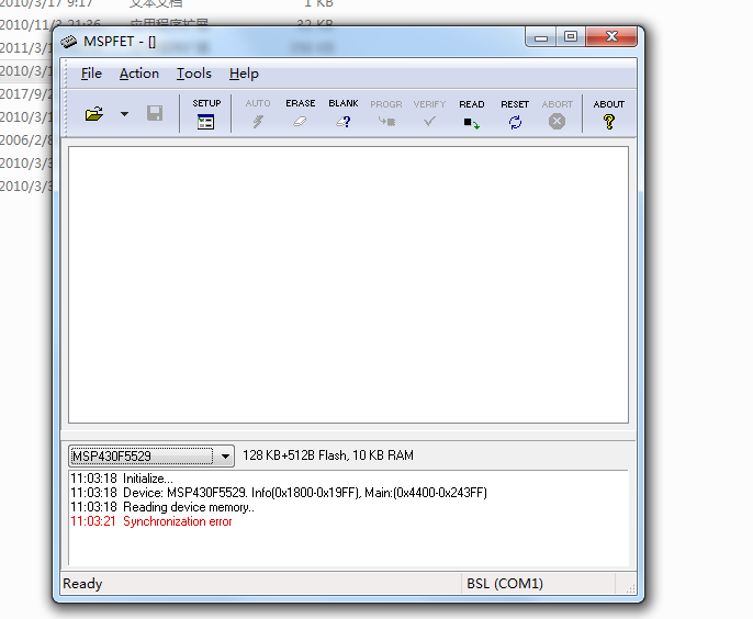

    I also have a problem now. I used embedded firmware upgrade software in ADS1292 EVM GUI to upgrade the firmware, but I upgraded a program written by myself instead of ADS1292ECG-FE firmware package.
    So now that ADS1292ECG-FE is powered on, it's my own program. I tried using MSPFET BSL to restore the original firmware, but failed. The failure information is shown below.
    I think how can I get back to the factory firmware?
    Thank you very much!
  • Hi Alex,
    I'm not familiar with that software.
    Have you tried to load the firmware through the ADS1x9xECG-FE GUI? There are some instructions about this in the User Guide (section 7, page 37).
