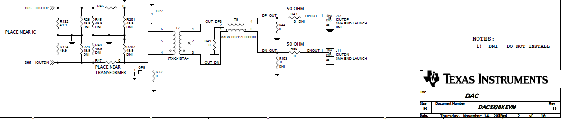

Am fabricating a test jig involving the DAC38J84 DAC.
Want to monitor the DAC outputs IOUTA, B, C and D.
What are my options of termination?
Can these outputs be connected directly to an SMA connector?
Thanks.
  • Hi Ikon,
    As a first step, I would take a look at the outputs on the DAC38J84EVM .
    This schematic is available in the EVM design package located here  under "User guides".
    Dan
