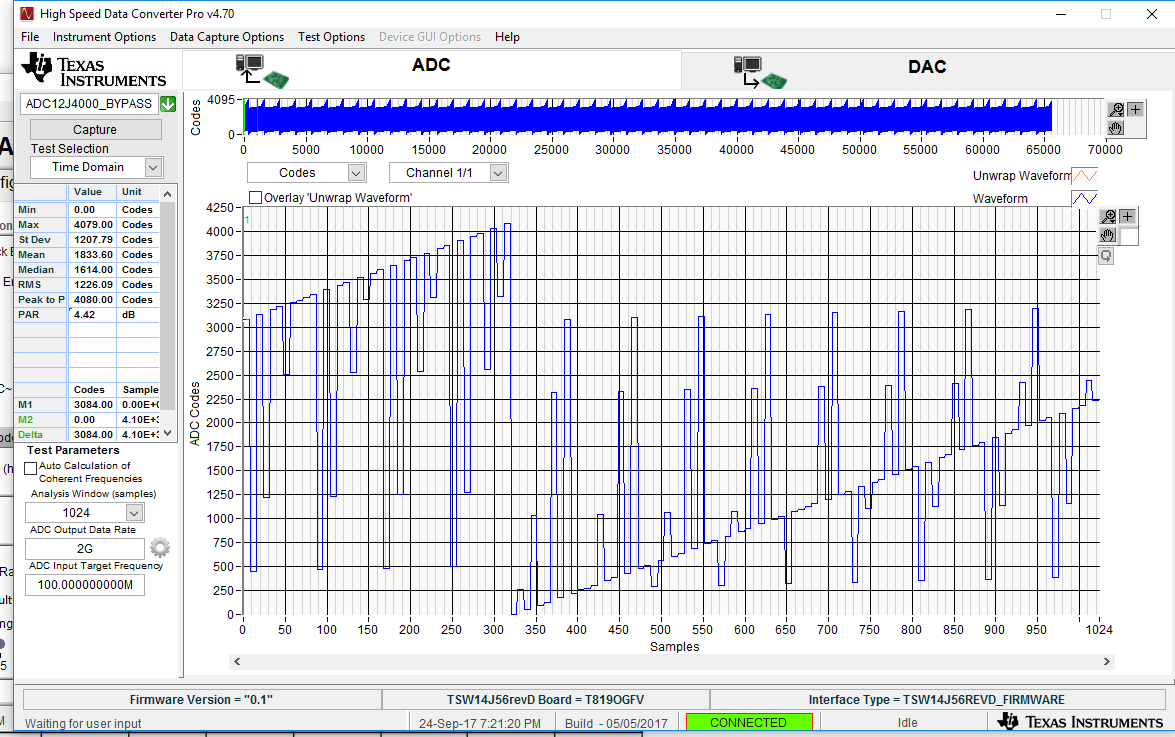

We are evaluating the ADC12J4000 ADC using both the ADC12J4000EVM and the TSW14J56EVM.
The TSW14J56EVM is running with its original firmware.
Spectral display (FFT) looks fine when injecting RF carrier signal.
However, result looks improper when switching to an internal Pattern signal (Ramp).
Attached is a picture of the Pattern in time domain as captured by the HSDC Software.
As can be seen, ADC12J4000_Bypass is selected.
“Ramp Test” mode is selected in the ADC12J4000EVM GUI.
Test pattern is enabled in the TSW14J56EVM GUI.
We followed the instructions as in SLAU551B (ADC12J4000EVM User's Guide) and no errors are reported by either GUI applications.
Please advice regarding the issue described above.
Is there anything that we overlooked which could explain this result?
