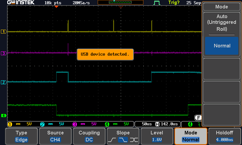

I am trying to read chip ID from ADS1298 board and I am getting 7F and what I expect is 92.
please help
I am transmitting
11h SDATAC
20h
and 00h
so what I am getting on dso is very odd because it seems discharging(DOUT PIN on DSO)
yellow clock
pink Din
Blue Dout
Green CS
Zoomed 1st set of clock 20h
2nd set of clock 00h
zoomed last set of clock ......and getting 7F on receive buffer
zoomed out sequence dout (blue)seems as if discharging
