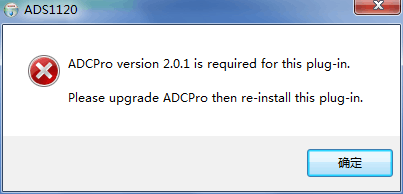

When I downloaded the software of ADS1220evm, the web page showed version 2.0.0, but when I finished downloading, in the installation process, I had the following problems and how to solve them. I need your reply urgently. thank you
You need to download "ADCPro Installer" (2.0.1). this is a separate software that can be found here. I tried installed the ADC1220 software first, and I got the same error as you. After installing ADCPro 2.0.1, and then doing the 1220 EVM software I got no errors.
