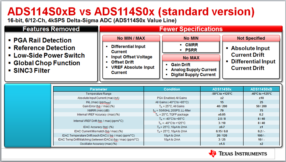

  • Tim,
    The ADS114S08B is very similar to the ADS114S08, with some of the features removed. There are also a few differences in the specifications (from the MIN and MAX columns of the Electrical Characteristics).
    Here are the differences in a single graphic.
    What you decide to use will depend on what features you need and what specifications you need in your design.
    Joseph Wu
  • Thanks Joseph. I think the ADS114S08 is best for our application. I really appreciate your quick responses.

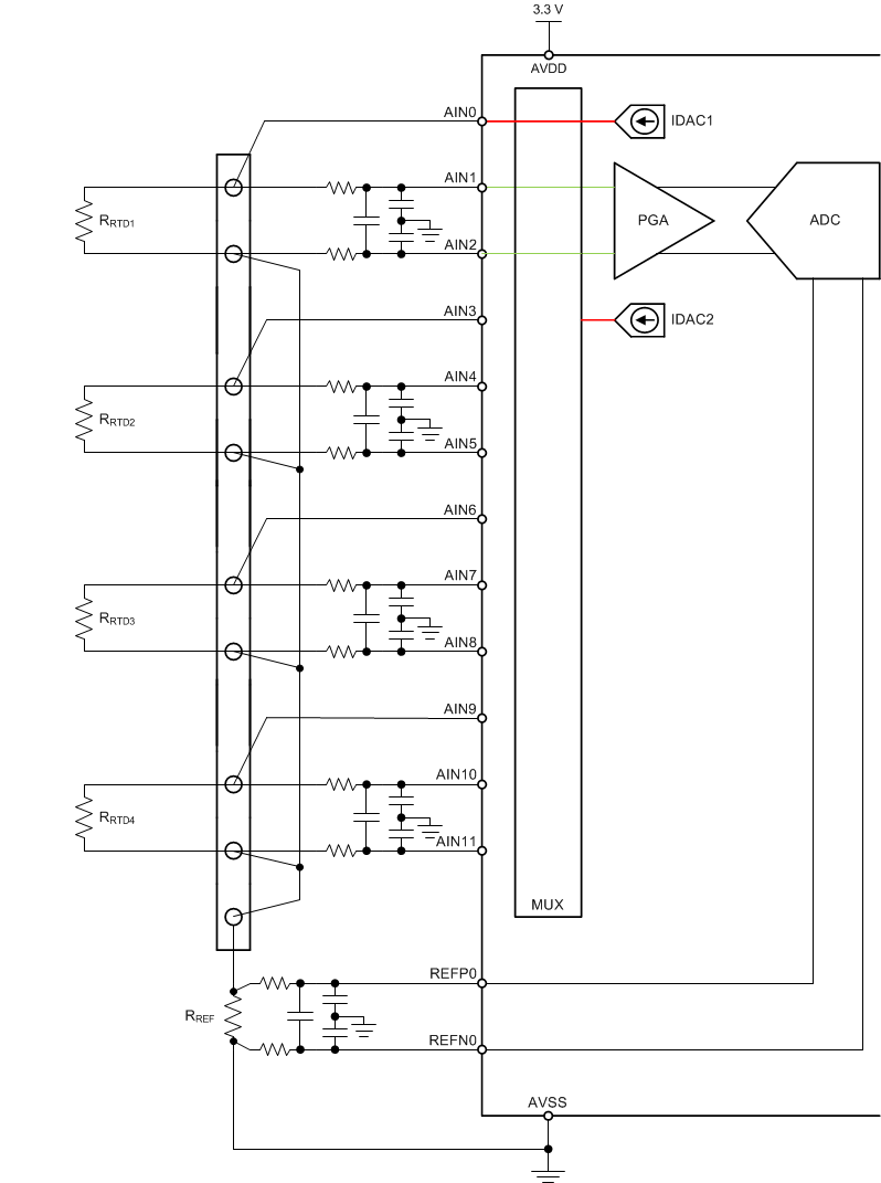

    Do you know if the ADS114S08 can be configured to measure four (4) PT1000 RTDs without putting them all in series?  We have an application that requires measuring between 1 and 4 PT1000 RTDs, so we would prefer to not put them all in series with with the single reference resistor. In the case where only one is connected, this would break the series chain and no current would flow. Is there a way to use the MUX to switch the reference resistor between 4 different RTDs and still do a ratiometric measurement?

  • Joseph,
    These are 2 wire RTDs. They are PT1000 (nominal resistance of 1000 Ohms) so the lead resistance is negligible.
    Is this doable with the ADS114S08 alone, or would we need to add an external MUX?
    thanks,
    Tim

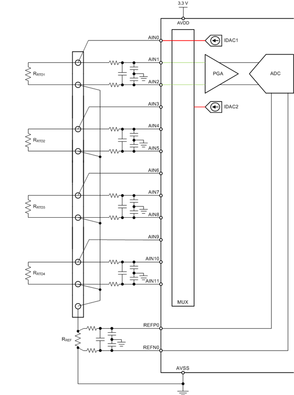

  • Tim,
    You should be able to connect four 2-wire RTDs to the ADS114S08 device. You shouldn't need the help of a multiplexer. I think something like this should work:
    All negative leads are connected and you select the IDAC to go from channel to channel.
    Joseph Wu
  • Joseph, this is perfect. The key is connecting the negative leads of each RTD. You are the man!
