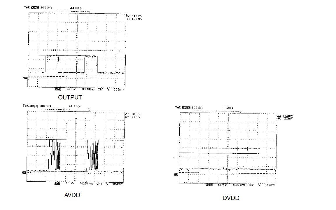

  • Hi Joseph-san,
    I got the waveform.
    Below is the measured current across 10 Ω.
     · VDD, AVDD: 2.7 V
     · Using unipolar
     · Using a 0.1 μF capacitor between VREFOUT and AVSS
     · Use internal reference
     · Reference voltage is determined by input voltage of VREF1P, VREF1N
     · Excitation current 100 μA × 2
     · Data rate 20 SPS
    I appreciate your support.
    Thanks and Regards,
    Kenji/Japan Disty.
  • Kenji-san,
    Thank you for the waveforms. As you mentioned, it looks like AVDD is repeatedly drawing about 20mA current during two 300ms periods. What is the plot labeled "OUTPUT"? Is this the measurement of some current, IDAC current, reference, or is it the output of something else?
    With the current repeatedly going high and low for AVDD, I don't know what this is. There are two things that I can think of that might behave this way. First, this could be the power supply or LDO output becoming unstable or going into some sort of current limit. Additionally, large inductances or ferrite beads on the supply may cause some spiking with the digital current. Second, this might be the internal reference becoming unstable because there AVSS return has a high impedance.
    It would be helpful to have a schematic showing the ADC and the devices supplying power to the system. Also, is the internal reference always on? or is it enabled and disabled whenever the RTD is measured?
