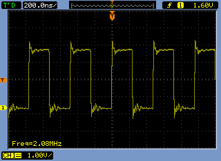

3) I'm using internall oscillator for this project, I have mesured directly by CLK pin with oscilloscope, the freq is 2,08Mhz;

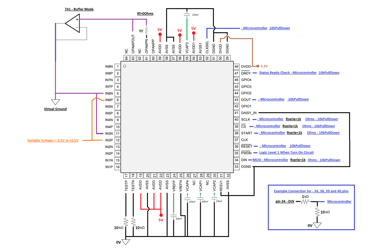

5) My schematic is attached below;

  • Oi Gabriel, bem vindo ao fórum e2e!
    The values you are getting back from the ADS131E08 make a little sense - the decimal values 127, 255, 255 translates to hexadecimal 0x7F,FF,FF which is full scale positive and fits with your +2.5V input. The 255, 184, 62 would be 0xFF, B8, 3E which would be near 0V input (the ADS131E08 provides binary two's complement data). Going to -2.5V on the input would not be appropriate since you have the device powered at 5V. How is your 741 buffer powered and what is the voltage on the output pin going to IN6N and IN3N?
