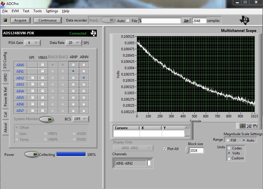

  • Joseph,
    Here's a screen shot after putting a bag of ice water on the sensor we're using - I've attached the sensor as close as possible to the EVM as to our circuit; voltage
    across the active element looks correct.
    Is the app automatically implementing the chop of the current DACs?  Is there a way to extract the register settings the ADS1248 is using?
    Thanks!
    John W.

  • John,
    When I refer to chopping the IDACs, this is really taking two settled measurements and averaging the two.
    For a three wire measurement in the traditional setup you would do this:
    1. Set IDAC1 to lead 1 of the RTD, Set IDAC2 to lead 2 of the RTD.
    2. Take a measurement of the RTD.
    3. Set IDAC2 to lead 1 of the RTD, Set IDAC1 to lead 2 of the RTD.
    4. Take a second measurement of the RTD.
    5. Average measurement 1 and measurement 2.
    Step 5 should cancel the mismatch of the IDAC currents. You're not trying to dynamically chop the IDAC currents. It is really just averaging two measurements.

  • John,
    The EVM does not run on any other software GUI. There are ways to talk to the device with a terminal program but it's not any easier that running this GUI.
    ADCPro does not do any IDAC chopping. Chopping only eliminates gain error associated with IDAC mismatch. It won't do anything for SNR.
    Joseph Wu
