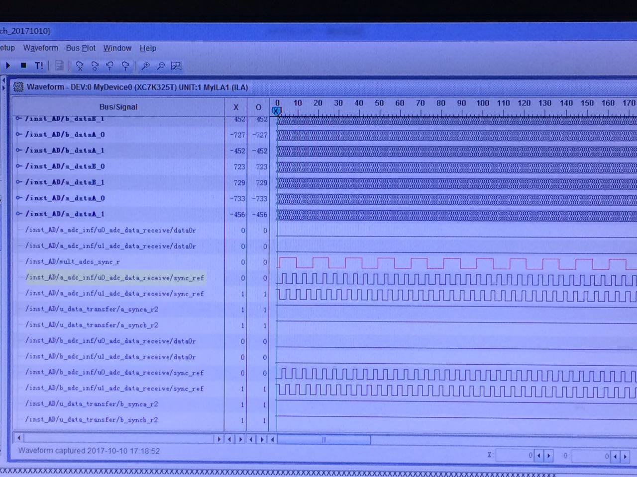

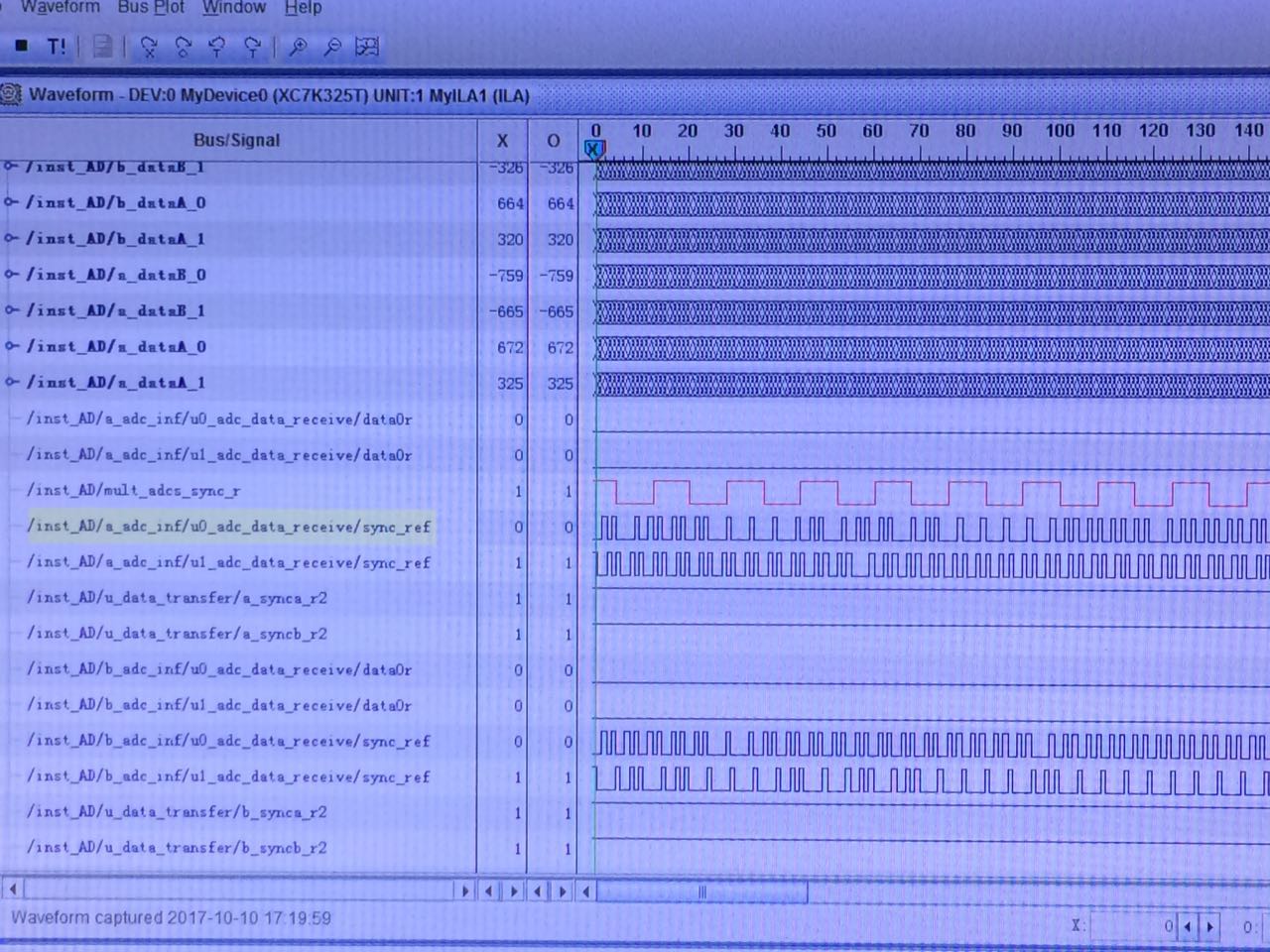

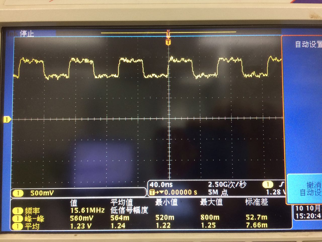

  • figure 1 shows sync signal at ads5407 SYNC pin. As i said before, it's a 15.625MHz periodic pulse which repeat every 32 CLKIN(500MHz) cycles.
    figure 2 is chipscope view window,  red signal is the sync signal produced from fpga and the signal on board is just as figure 1. But sync_ref signals which get from syncout pins are not stable and periodic. I have tried one-time pulse but i had the same result.
