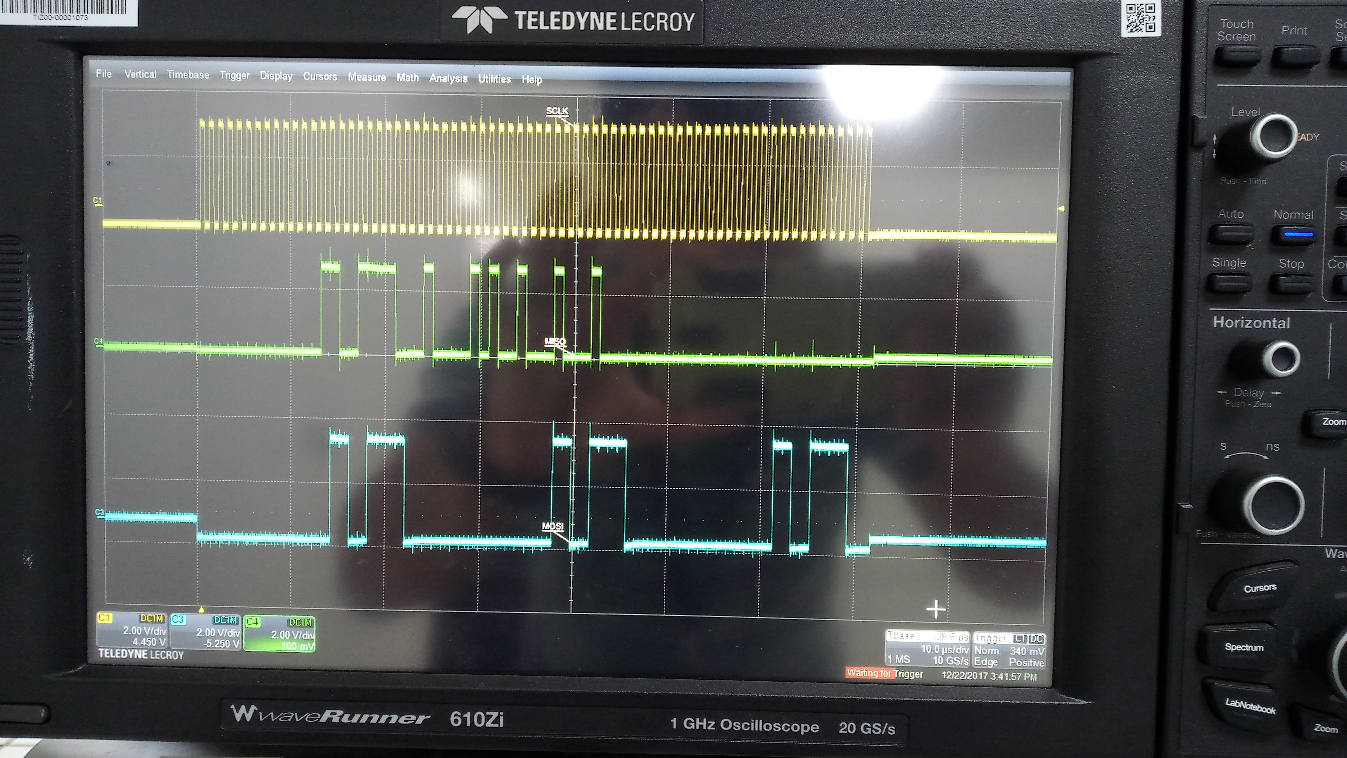

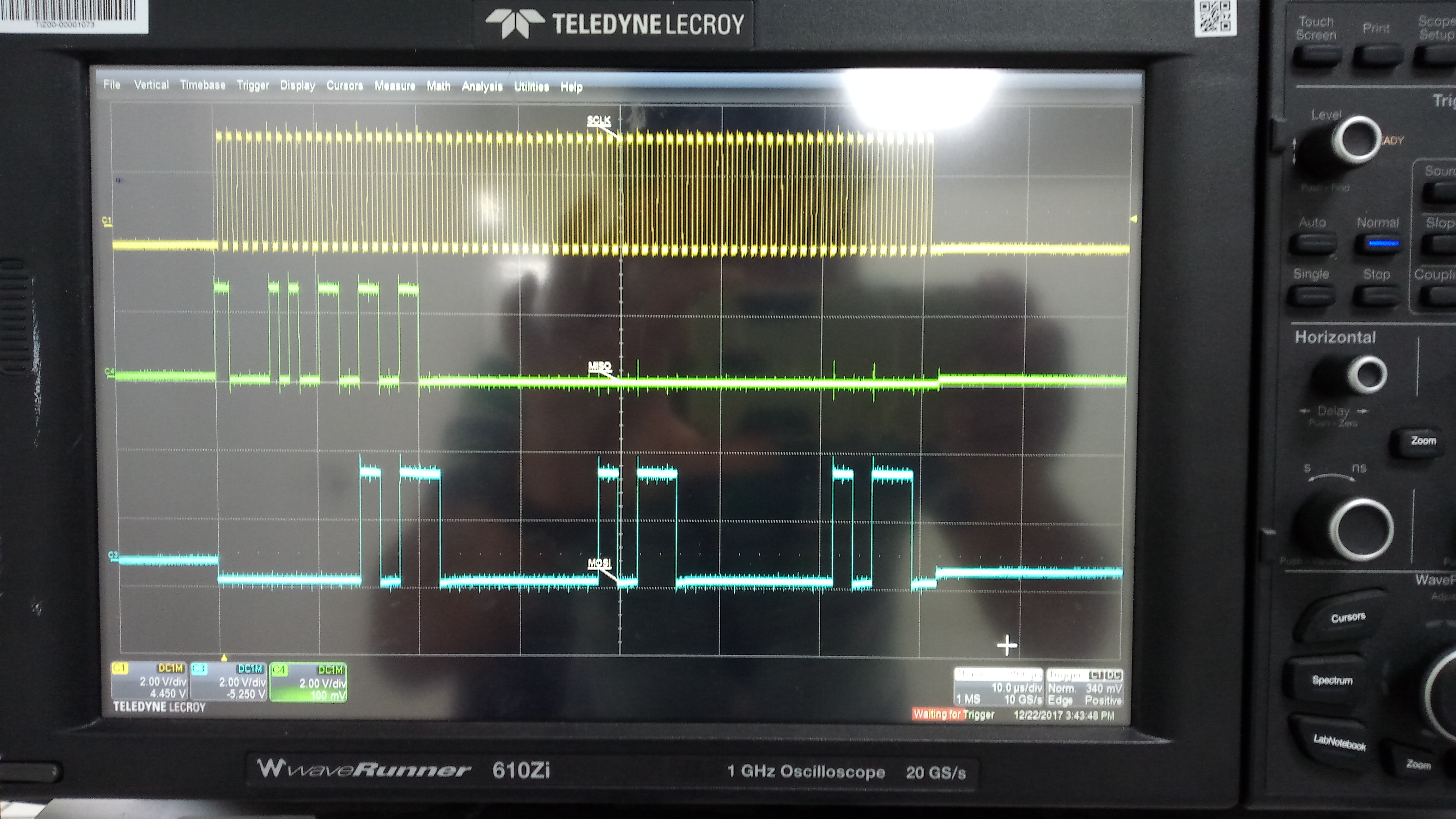

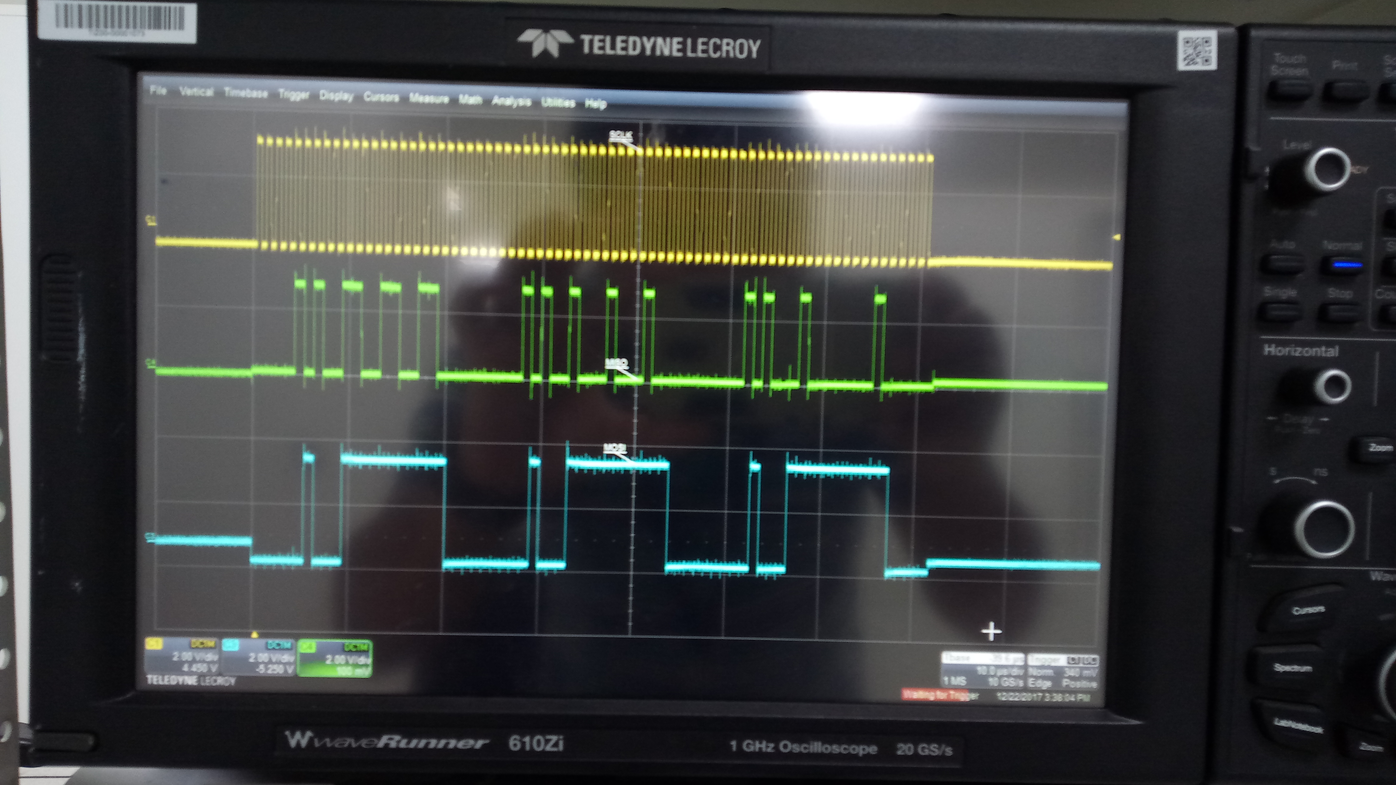

  • Hi Pieter,
    Soon after writing my previous post, I could get hold of a digital designer and we could find a workaround for the problem. The steps are as follows (for 3 DACs in daisy-chain):
    1. Write in daisy-chain as usual per datasheet
    2. Send read command for the first DAC and NOP for others in daisy-chain
    3. Send NOP command for all in the daisy-chain and parse MISO line for data from first DAC
    4. Send read command for the second DAC and NOP for others in daisy-chain
    5. Send NOP command for all in the daisy-chain and parse MISO line for data from second DAC
    6. Send read command for the third DAC and NOP for others in the daisy-chain
    7. Send NOP command for all in the daisy-chain and parse MISO line for data from third DAC
    Please note that the steps 2, 4 and 6 can be interchanged.
    Due to some custom implementation in the design, we need to go through the above steps to perform a proper read-back of all DACs in the chain. I understand that this is a multiplication of the steps and in your design, you will need 10 SPI cycles to read 5 DACs, instead of 2 cycles.

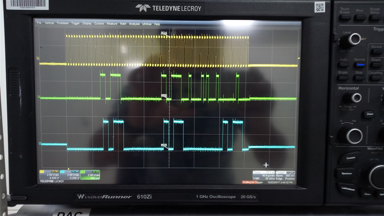

    Please find the scope shots below:
    First write (0x05, 0x33, 0x30, 0x05, 0x22, 0x20, 0x05, 0x10, 0x10): This is the value I am going to read back:
    Second Write (0x04, 0x7F, 0xF0, 0x04, 0x7F, 0xF0, 0x04, 0x7F, 0xF0): To make sure I am not just reading back the data from the shift register that has not been updated from the DAC registers:

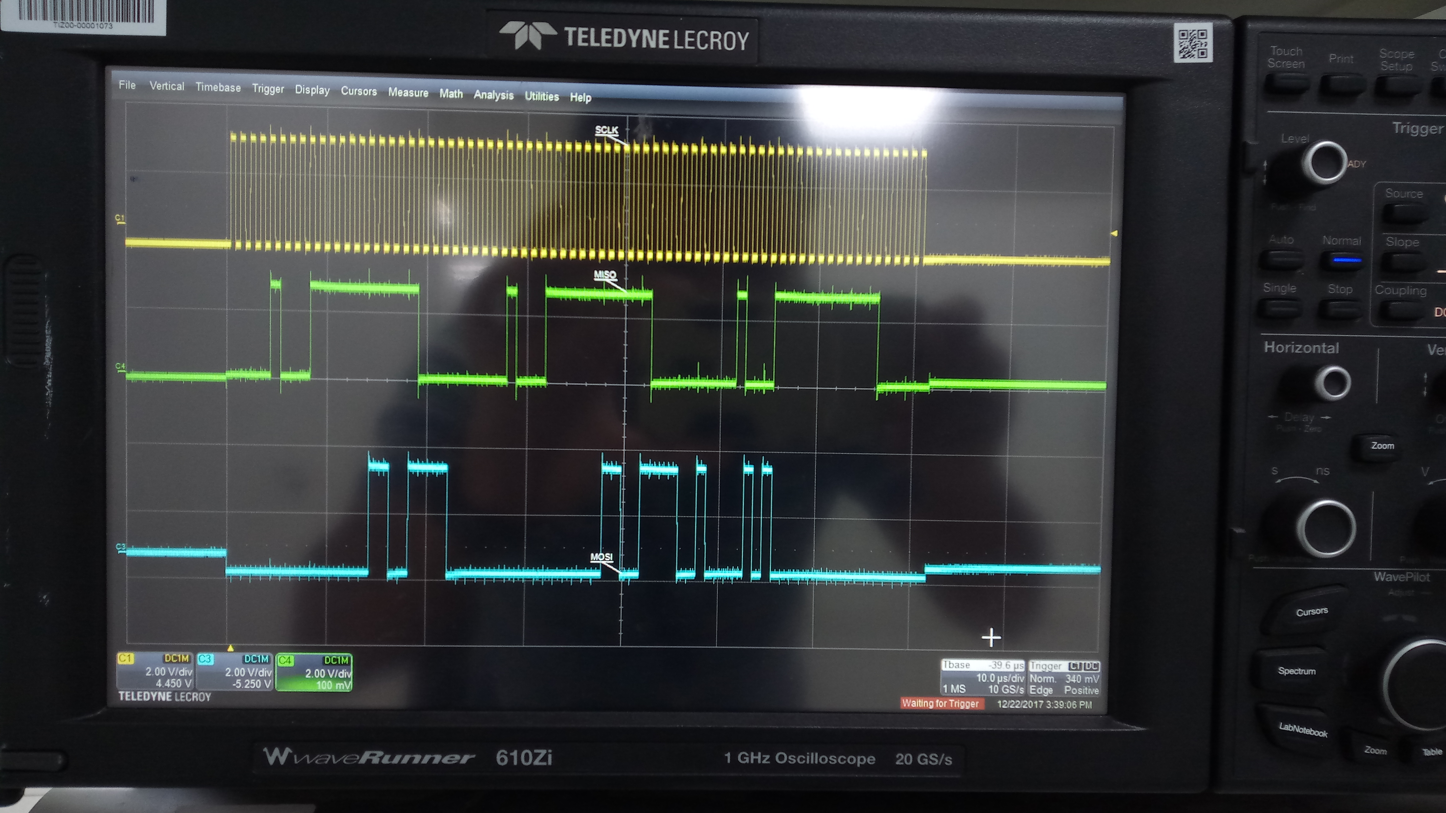

    First Read Command (0x00, 0x03, 0x3C, 0x00, 0x03, 0x3C, 0x85, 0x00, 0x00):

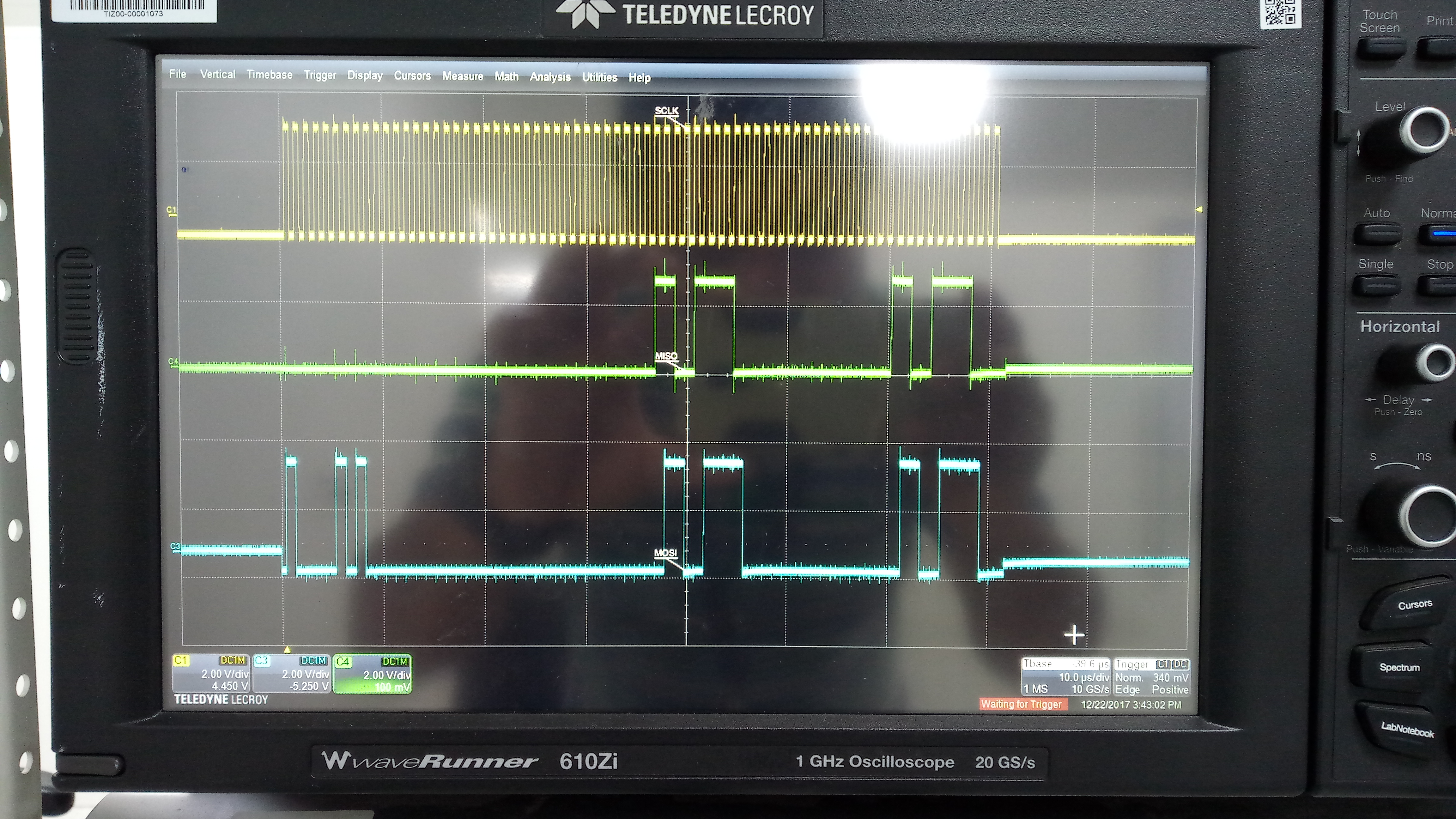

  • First NOP (0x00, 0x03, 0x3C, 0x00, 0x03, 0x3C, 0x00, 0x03, 0x3C): Read-back first DAC data now:

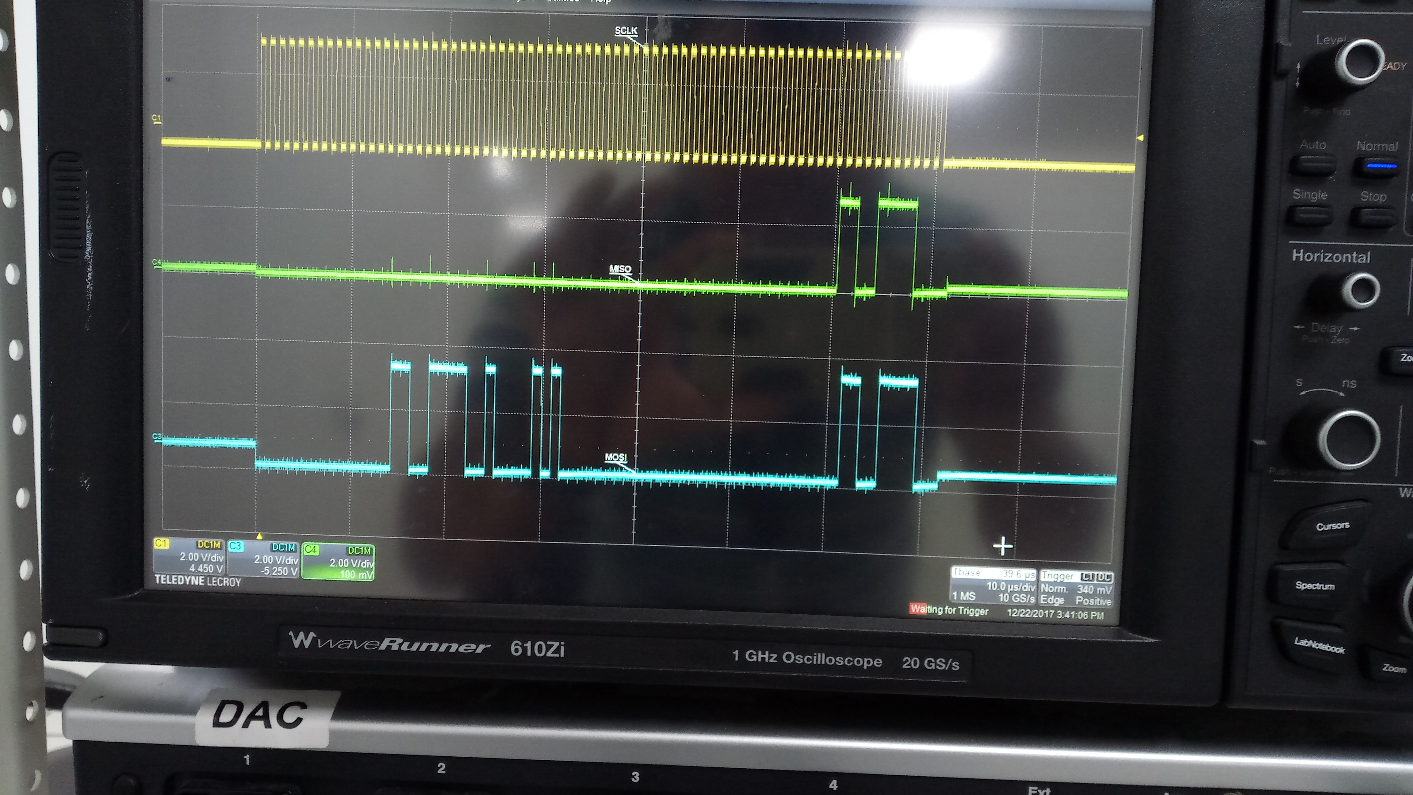

  • Second Read (0x00, 0x03, 0x3C, 0x85, 0x00, 0x00, 0x00, 0x03, 0x3C):
  • Second NOP (0x00, 0x03, 0x3C, 0x00, 0x03, 0x3C, 0x00, 0x03, 0x3C): Read-back data from second DAC:

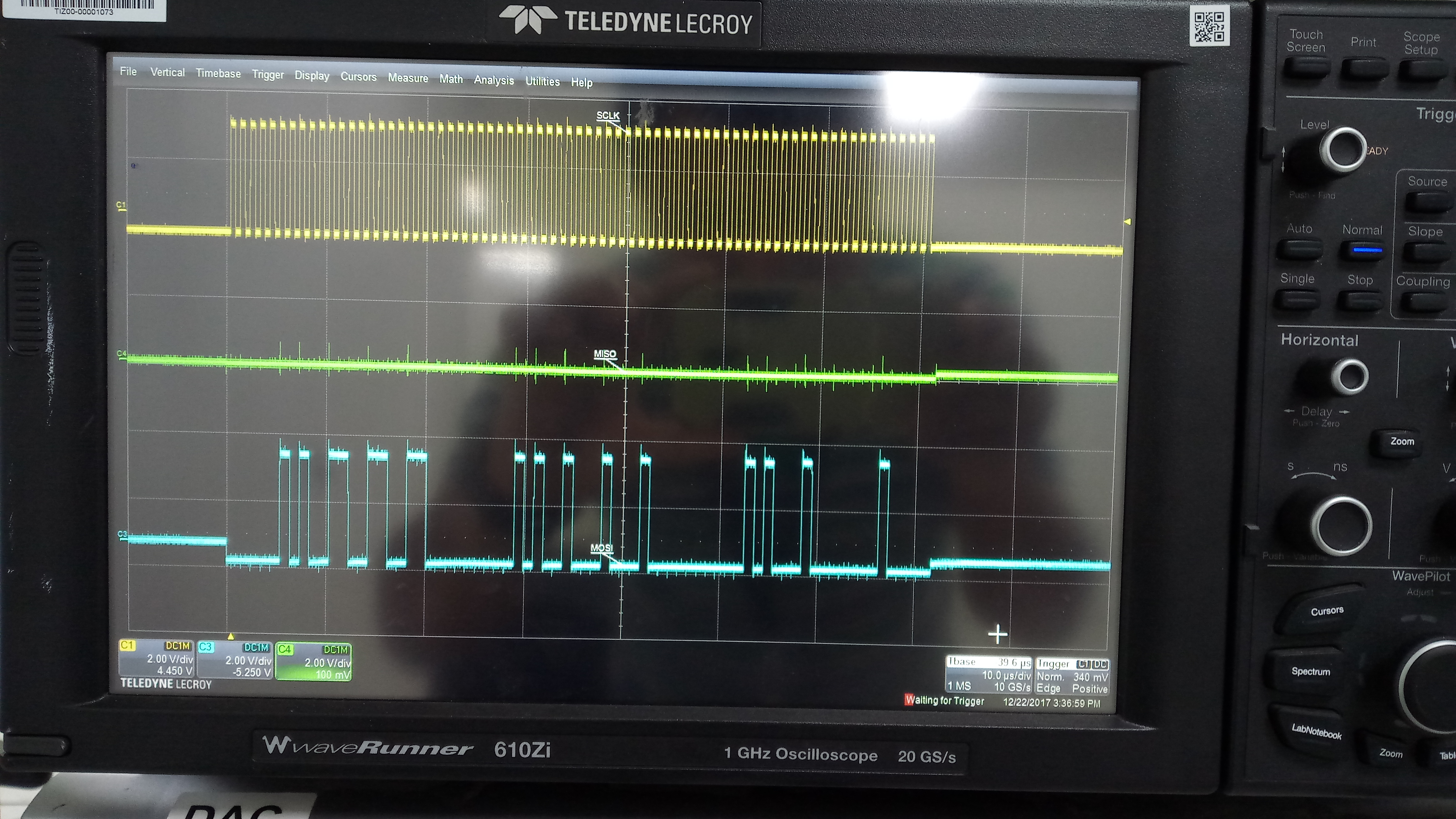

    Third Read (0x85, 0x00, 0x00, 0x00, 0x03, 0x3C, 0x00, 0x03, 0x3C):

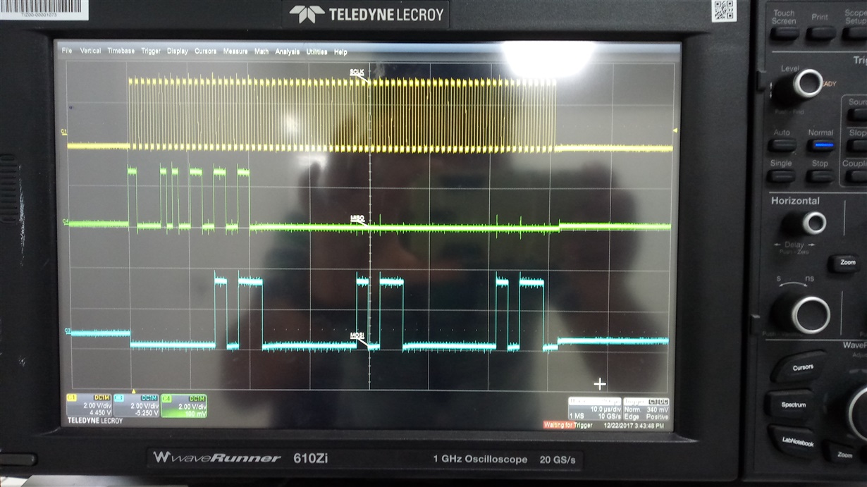

    Third NOP (0x00, 0x03, 0x3C, 0x00, 0x03, 0x3C, 0x00, 0x03, 0x3C): Read-back data from the third DAC here:
    I think your issue is resolved now. Please let us know if you are facing any further problems.
