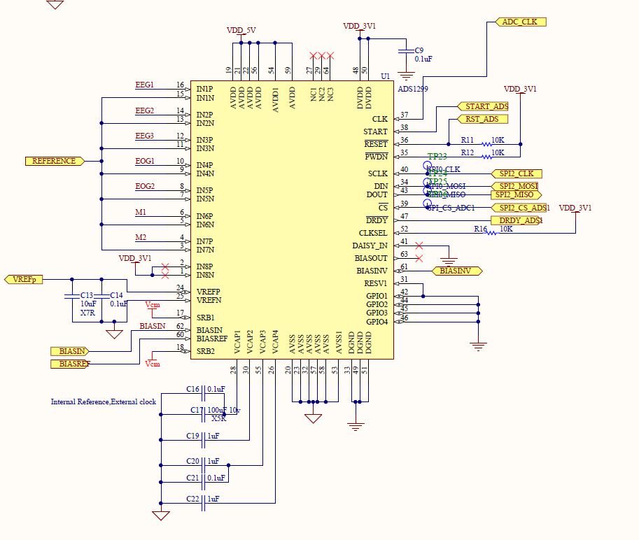

       Our Team developed a board with ADS1299, but We found we can not read chip id after send read register command via spi,
If you give us some advice, we will appreciate it.
we found VCAP1 is less than 1.1v, so we change C17 from 100uF to 47uF. after we change C17 to 47uF, we found VCAP1 is greater than 1.1v.
but we still can not read chip id, the data is 0x00.
the attachment is our hardware scheme.

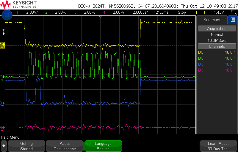

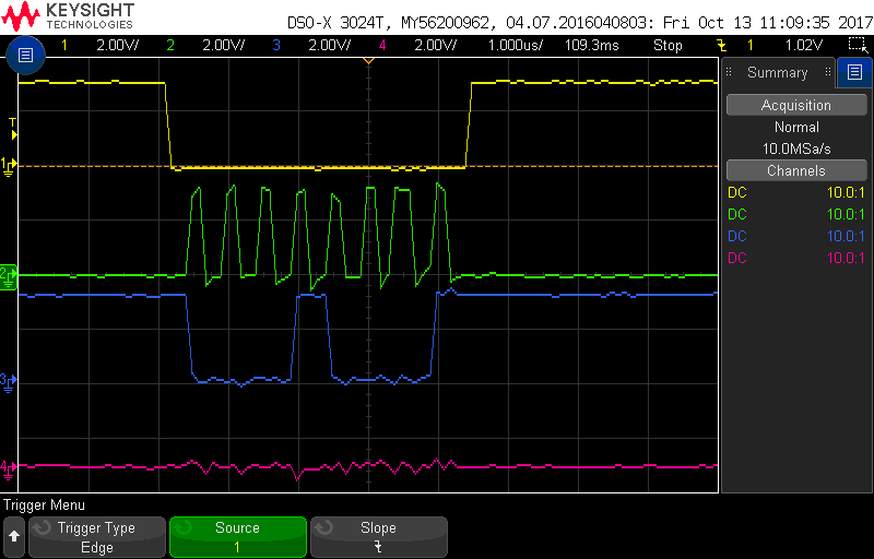

These pictures are from oscilloscope.
SPI Command 0x02(WAKEUP)
SPI Command 0x11(SDATAC)
SPI Command 0x2000(RREG ADDRESS 0 chip id)
SPI Command 0x04(STANDBY)

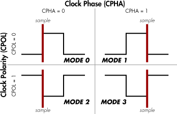

  • Hello Gang,
    Thanks for your question.
    Are you using the correct SPI mode settings? It appears that data is transitioning on the falling edge of SCLK in your images. We need data to transition on the rising edge of SCLK since the ADS1299 uses the falling edge to latch the data.
    Please confirm you are using SPI mode 1 (CPOL = 0, CPHA = 1):

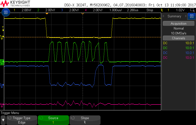

  • Hi, Ryan,
            Thanks for your advice.
    Follow your advice, After changed SPI mode to MODE 1,but chip ID is still 0x00.
    Is there other factor we should consider?

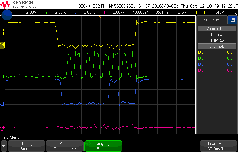

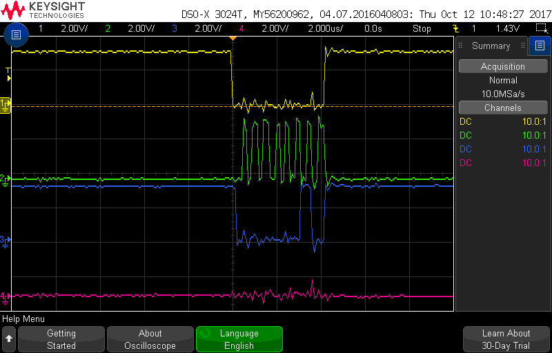

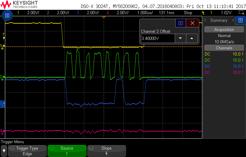

  • Hello Ryan,
    Thanks for your reply.
    We powered on the device and toggle /RESET  to low level with wire directly.
    but there is still no /DRDY pulse.(in picture1)

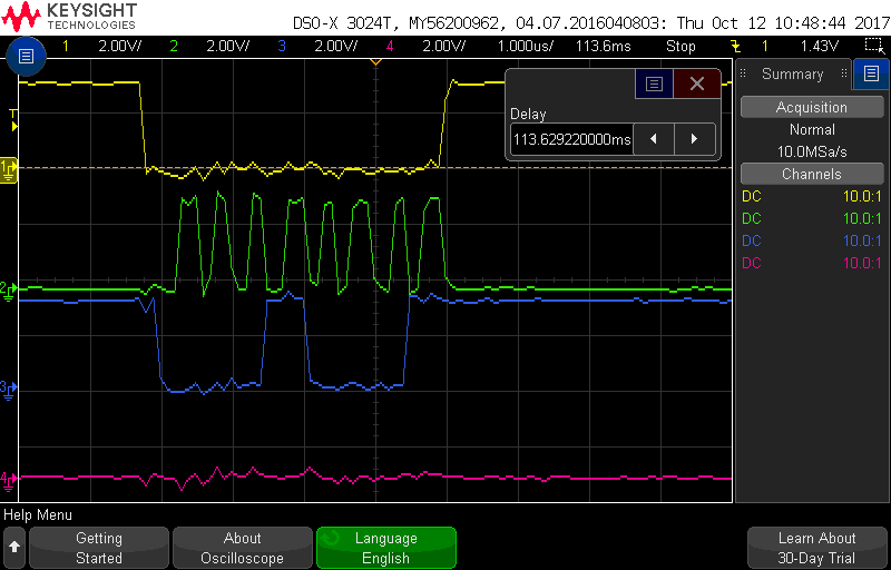

    We set  the signal is triggered by falling  on /DRDY on oscilloscope,
    then We  pulse the /RESET under linux
    but we have not seen  /DRDY pulsing since the device powered on.(picture 2)
    Gang
    The below is the Picture1
    yellow: START
    green: RESET
    blue:   Supplies
    purple: DRDY
    The below is picture 2
    Yellow: START
    Green: DRDY
    Blue:  RESET
    Purple:PWDN
