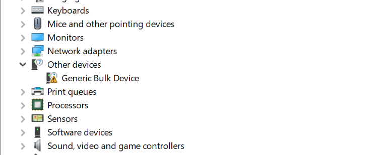

Hello TI,
We have ordered new ADS127L01EVM and installed following in a Windows 10 PC.
1)ADS127L01EVM-DVCPKG : ADS127L01EVM Device Package
2)ADS127L01EVM-DVCPKG: ADS127L01EVM Device Package
I still see issue with Generic Bulk device as in picture , release notes mention that windows 10 driver issue is resolved.
Has someone faced similar issue with latest software as well?
Can someone at TI support with this issue

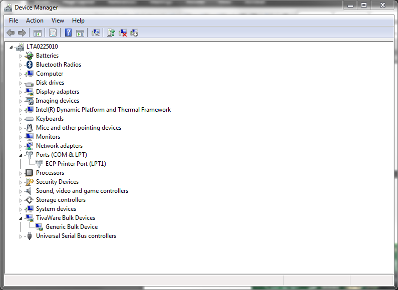

  • Hello Ashok,
    Thanks for your interest in our ADS127L01!
    The first piece of software you should have installed is our Delta-Sigma EvaluaTIon Software:
    DELTASIGMAEVAL-GUI:
    Delta-Sigma ADC EvaluaTIon Software
    After installing the GUI and the ADS127L01 Device Package, you may still need to point the device to the correct drivers. Please do the following:
    1. Right-click on “Generic Bulk Device,” select “Update Driver Software…”
    2. Manually browse to “C:\Program Files (x86)\Texas Instruments\DSEvalSW\drivers.” Check “Include subfolders” and hit Next.
    3. Install the device software.
    The Device Manager should refresh and the EVM will enumerate as TivaWare Bulk Devices -> Generic Bulk Device.
  • Thank you Ryan. Your suggestion helped.
