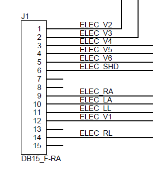

    One possible explanation for the difference in signal amplitudes may be how you have the electrodes connected to the ADS1198ECGFE-PDK. The software is expecting the electrodes to be connected to certain channel inputs in order for the calculations to work properly. Can you confirm that your electrode configuration matches the EVM schematic?

    I have checked several times and the leads are connected as expected (following your image).

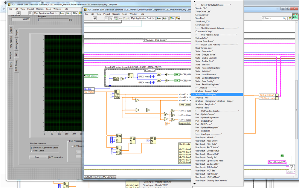

    You mentioned I could check the source code, but I couldn't find the lead calculation part, could you tell me what is the file that contains this procedure?

    Honestly, I'm not that familiar with LabVIEW myself, so I apologize if this explanation isn't the most clear. I simply opened the main LabVIEW project "ADS1298evm.lvproj," navigated to the Analysis Tab -> ECG Display, and opened the source for the display by double-clicking on the scope screen. If you change the pull-down menu option to "Analysis - ECG Display," you will see where the various leads are calculated. Hopefully the image below shows you what I'm talking about:
