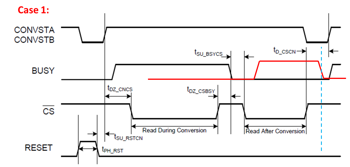

    Case 1:     the new conversion initiated on CONVSTA or CONVSTB (red BUSY high in figure 1 as below) is NOT finished during this data read.
    This data reading will not be affected by this new conversion because the data in the internal data registers is not updated with the new conversion data by this new conversion until the end of conversion phase (when red BUSY goes low).

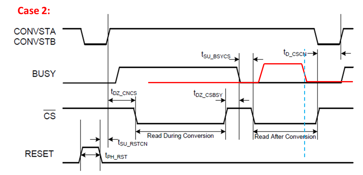

    Case 2:     the new conversion initiated on CONVSTA or CONVSTB (red BUSY high in figure 2 as below) is finished during this data read.
    The new conversion data by this new initiated conversion will be updated into the internal data registers at the end of conversion phase (when red BUSY goes low), so host controller retrieves the data for some bits of previous conversion before this moment, also will retrieve the data for some bits of new initiated conversion after this moment. This is not a complete data and probably not correct.

    In your case 2, described above, will the read in progress during the BUSY transition from high to low stop receiving the next bit in line of the old data and begin receiving the first bit of the new data from channel 1 on the next edge of SCLK
    Answer:  the data reading will continue reading next bit of same data register but with new data in next bit, the data register is same data register.
    We always strongly recommend to finish all channel data reading either during BUSY high (Read During Conversion) OR during BUSY low (Read after Conversion), never read the data across the BUSY falling edge, because there is a higher risk to get incorrect data, this can be implemented perfectly by monitoring BUSY signal and controlling /RD and /CS signals.
