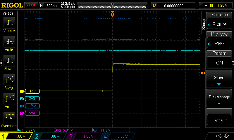

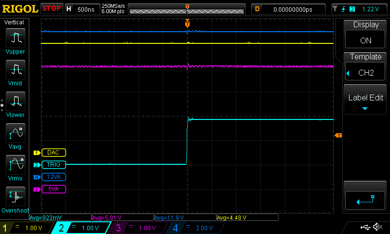

  • I do not see any obvious issues with your schematic. Do you think you could use a oscilloscope to capture the value of the supplies, DAC, and reference during one of these events?
  • Thanks for your help so far Paul,
    I have measured the voltages at the IC and I figured out that not the DAC is the problem!
    It seems like the ADC auto conversion stops after a not specified time, at the moment I solved the problem, by just give the adctrig a tick to restart the auto conversion.
    However I don't understand why the auto conversion stops, I will read the datasheet again and maybe i can find a better solution.
    I have added two screenshots, the first shows the supply voltages during the "auto conversion stop", the second shows the DAC output, which stays stable, during the event
    p.s. have a nice weekend :)

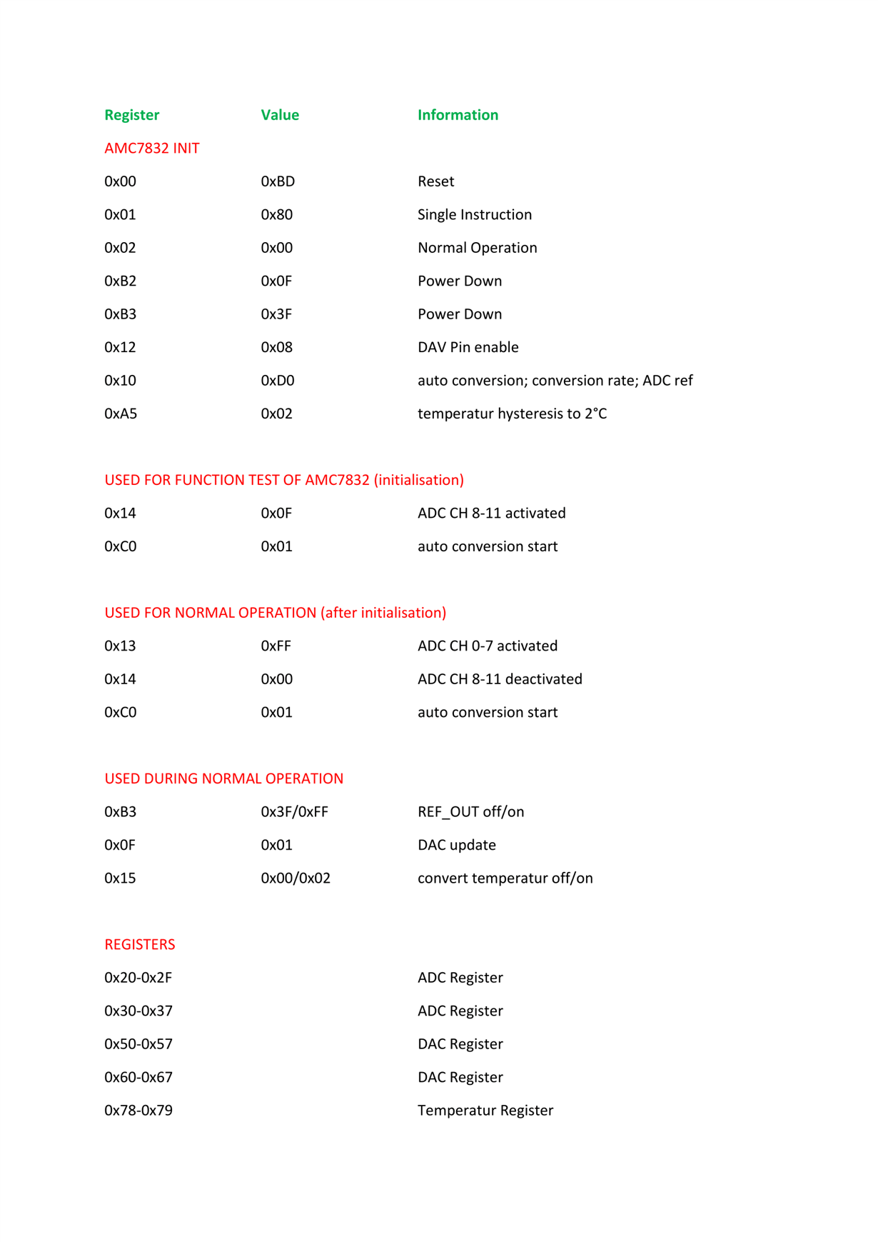

    As promised here are the used commands:
  • Hi Tobias,
    I do not think waiting (or not waiting) for the DAV pulse is causing the ADC to stop converting. I suspect that there is a bug in the code where another register is being written to. Is it possible that the MUX registers are being written to by mistake or in an integer overflow situation?
    Thanks!
    Paul
  • Hi Paul,
    I have added you the code snippet in which the temperature is handled! (it is done periodically)
    I have also checked the rest of the code, and I do not believe that the MUX registers are written accidentally!
