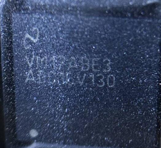

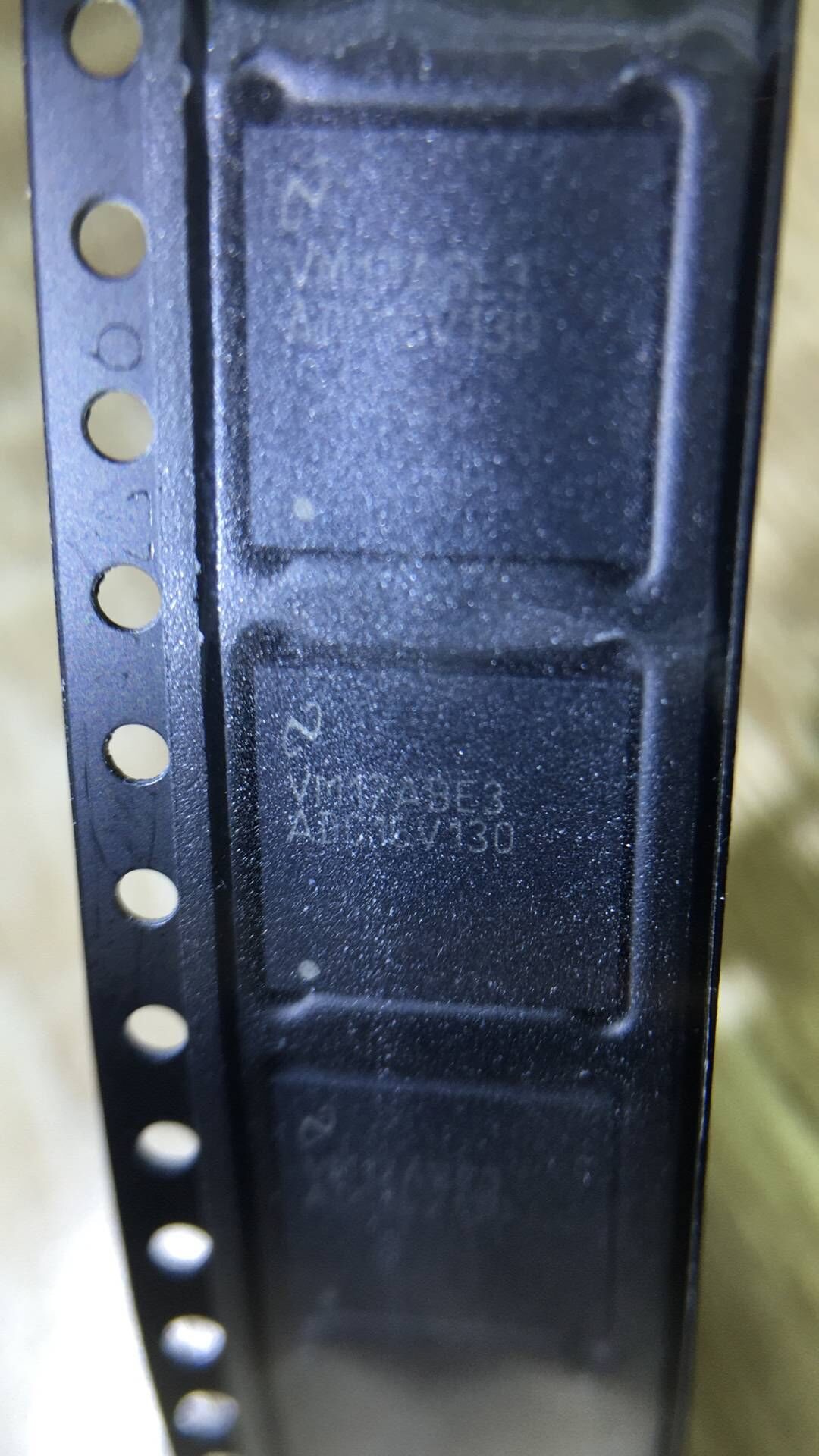

We have a customer who ordered the ADC16V130CISQE/NOPB from the TI Store.
The customer is asking for the date code.
I know this request sounds rudimentary, but the numbers seem ambiguous and out of place for this device (unless it's very old stock):
1st line: VM17ABE3
2nd line: ADC16V130
We have referred to this TI document:
 http://www.ti.com/lit/an/snoa039c/snoa039c.pdf
We have discussed this internally, and no one is clear on this.
My read is October, 2011.
Could someone please have a look at this and provide some feedback?
