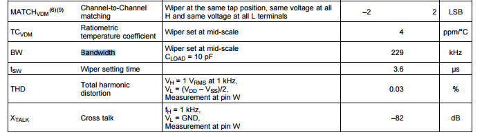

TPL0102-100: How to understand TPL0102 “Bandwidth ”
Part Number: TPL0102-100
Dear,
When I scaned the TPL0102 datasheet, I found it has a Bandwidth, I want to know how to undersand. It is for resistance? or It is for the internal DAC? And if it has a Internal DAC? Thx
    Thank you for your query. The bandwidth is for the resistance. This is because there will not be a pure resistance - there will be switches involved. There is no separate DAC in the device. But a DPOT is essentially a string DAC with some differences.
    Uttam Sahu
    Applications Engineer, Precision DACs
