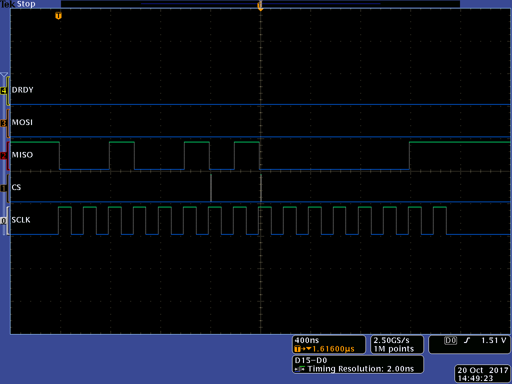

I have come across with a problem when using ADS131A04. I use F28069 as a master controller and the SPI communication seems working. In my circuit, M2 is connected to GND; M1 is left unconnected; M0 is connected to IOVDD. This achieves a hamming code off, 16-bit device word, and asynchronous slave mode. Below is the screen shot after I check the STAT_M2 register.
But it has a problem with SPI. When I check STAT_S register, I get this response, 0010010100000011. From the instruction on Page 59, Bit 1 indicates that "CS is asserted or deasserted when SCLK is high" and Bit 0 indicates "Not enough SCLKs are sent per frame". Could you give some suggestions on how to solve these two errors?
