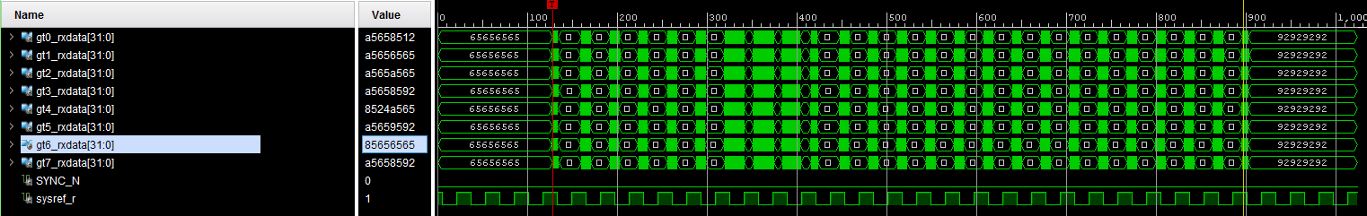

    1. Load LMK_Config_Onboard_819p2_MSPS.cfg
    2. Check the PLL2 led
    3. Press SW1
    4. Load ADS54J60_LMF_8224.cfg
    The reference clock (i.e.FPGA_JESD_SYSREF) is 204.8 MHz and this clock is required by ZCU102 for its PHYs. The line rate is 4.096 Gb/s
    The following are the screenshots from analyzer.

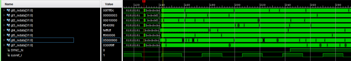

    1. LMK has been loaded with LMK_Config_Onboard_819p2_MSPS.cfg. ADC reset pressed. ADC has not been configured:
    2. The moment when the ADC configuration file has been loaded. Note, that there are no CGS symbols.  SYNC is always low
    3. The moment when I manually select "Repeating ILA" in the GUI. Note, there are "bcbcbcbc" beats, SYNC goes high and ILA starts.
    Here are parameters I got from the ILA gt0_rxdata:
    DID BID ADJCNT LID PHADJ ADJDIR L SCR F K M N CS N' SUBCLASSV S JESDV CF HD RES1 RES2 FCHK
    0 0 0 2 0 0 7 0 1 F 1 D 0 F 1 3 1 0 0 0 0 3B
