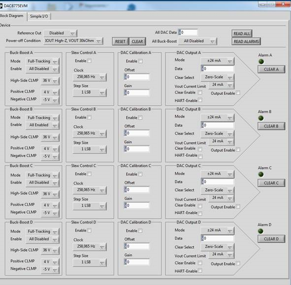

Dear team,
I got some question from customers I summarize here:
1.) Can I power the EVM with 15V without problems? It seems so but please confirm.
2.) They want to use the EVM for +/-20mA application, should they set the current limit to +/ -24mA or to +/ -20mA?
3.) Regarding the buck-boost, which is the suitable mode to use in order to get +/-20mA?
3.a) Would positive and negative enable be the best choice?
3.b) Could the full tracking feature make the chip hotter?
3.c) Would the clamps be limited by the maximum resistance of the loop?
Could you please help?
