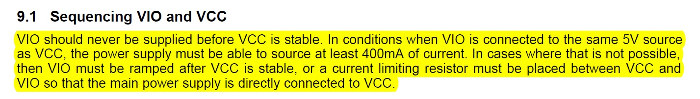

1.  In our old version datasheet(2016 version), it don't have the 9.1 part as showed in the latest datasheet, so not sure why we add this change? For example, if
     these is some bug found during our internal test?

  • Sulyn,
    1.) We found that powering up VIO first could cause a large current draw. We also found that if VCC and VIO are powered from the same supply and powered at the same time, that there can be a surge current that can cause a weak power supply to never fully turn-on. That is why we recommend that the power supply is capable of supplying at least 400mA.
    2.) I've answered this before, so let me look up what the typical currents are. Note that most of the VCC current will depend on the VEXT boost voltage and the resolver load.
    3.) The transient current can be up to 300mA, but it is only during the ramp-up time of VCC. Note that this value is for VIO = 5V, so VIO = 3.3V should be less.
    4.) If VIO is powered first, there will be higher current consumption until VCC powers up.
    5.) If the power supply is capable of handling the current, then there should not be an issue. Do they already have boards? Are they powering up VIO and VCC together?
    -Clancy

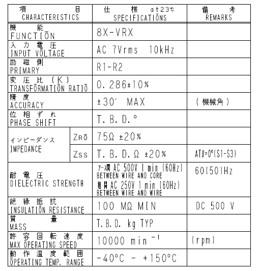

    2. VEXT and the load of the resolver and specifics are as below table, can you help check the VCC and VIO supply current during normal operation?
    As customer hardware already fixed, not sure do we have some solution by using software solution? Any suggestion for this? For the VCC and VIO supply current during normal operation under the above VEXT and Resolver load, appreciate your help to check, thanks a lot!

  • Sulyn,
    If VIO pulls a lot of current, pulling the VIO voltage level down, will the VCC rail still power-up? If so, then they should be in good shape. However, since VIO and VCC are generated from the same power supply, I'm not sure if that will be the case. What power part are they using?
