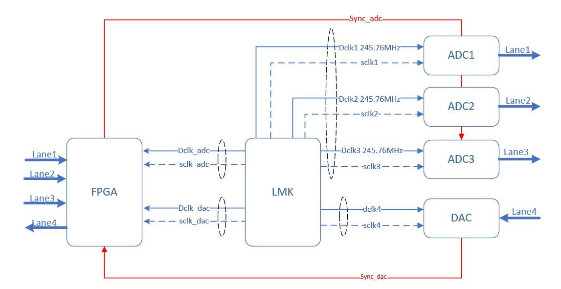

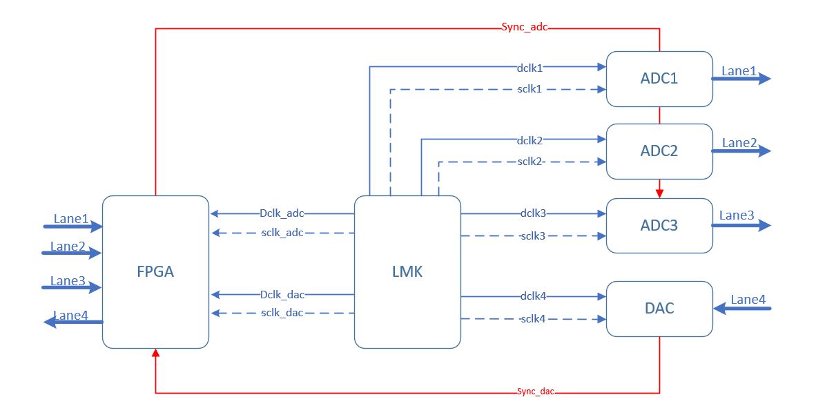

hello, guys
         I plan to design a board with 3 ADCs and a DAC dac37j84 , the pll is lmk04828,  The 3 ADCs chip is required to work Synchronously, so I think there are 4 groups of clock should be matched length, is there any problem?
        The pll used a 122.88MHz vcxo, how to set the frequency of Dclk3 and Dclk_dac?
