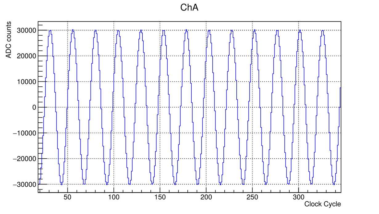

I am working with the ADS4249EVM board and I am able to correctly read the ADC digitized data (with a 245.7MHz clock and 10MHz input waveform) through an Altera Cyclone V FPGA (GX Starter Kit) and an HSMC/LVDS bridge.

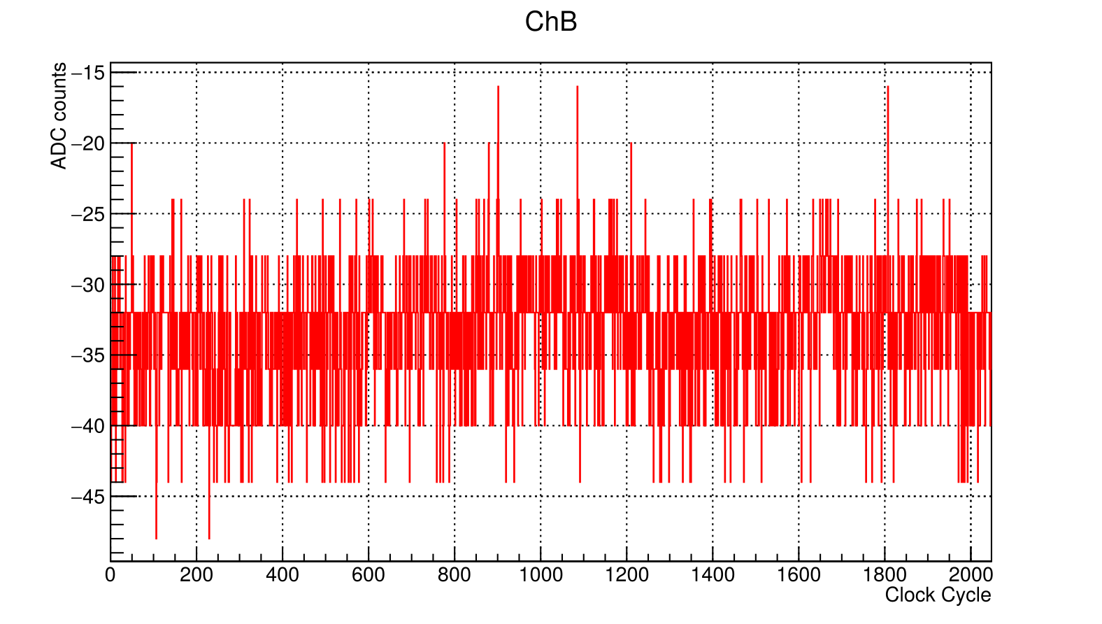

3) I cannot manage to change the output by enabling the EN DIGITAL bit (register 0x42, bit 3) and then activating a digital function (e.g. test patterns, gain ...). The ADC seems to ignore such settings even if the value seems to be written successfully to the register. The output I get is still the 10 MHz waveform (input channel A) and noise (channel B is not connected).

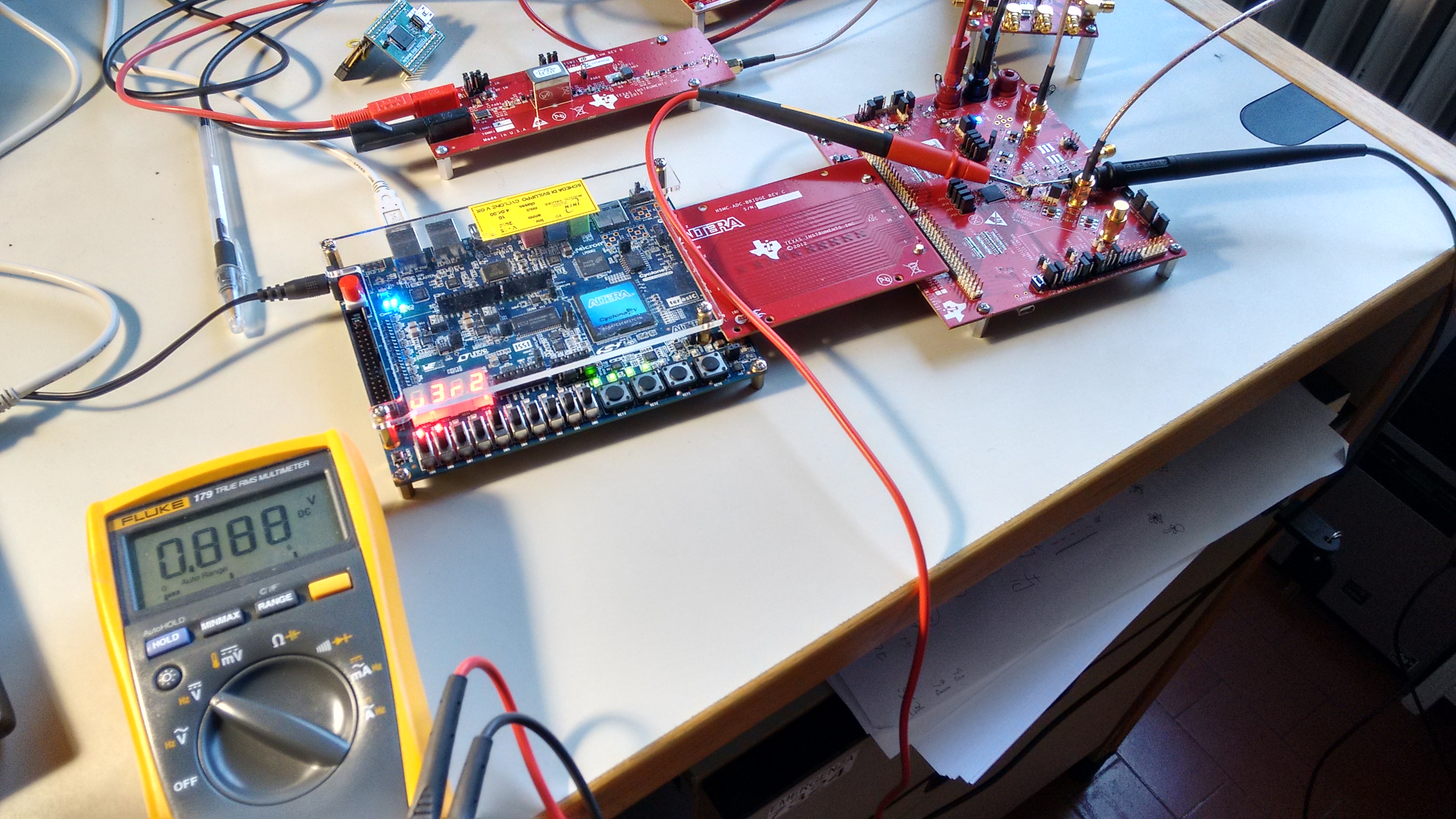

    Despite the fact that I am able to read back what I have written, I can also correctly change the channel outputs from two's complement to offset binary representation. Moreover I am also able to enable the HIGH PERF MODE (an achievement which seems to confirm the good behavior of my serial interface), as I show in the following figure (the VCM goes from 0.95 to 0.88 as described in the ADS4249 datasheet for HIGH PERF MODE):

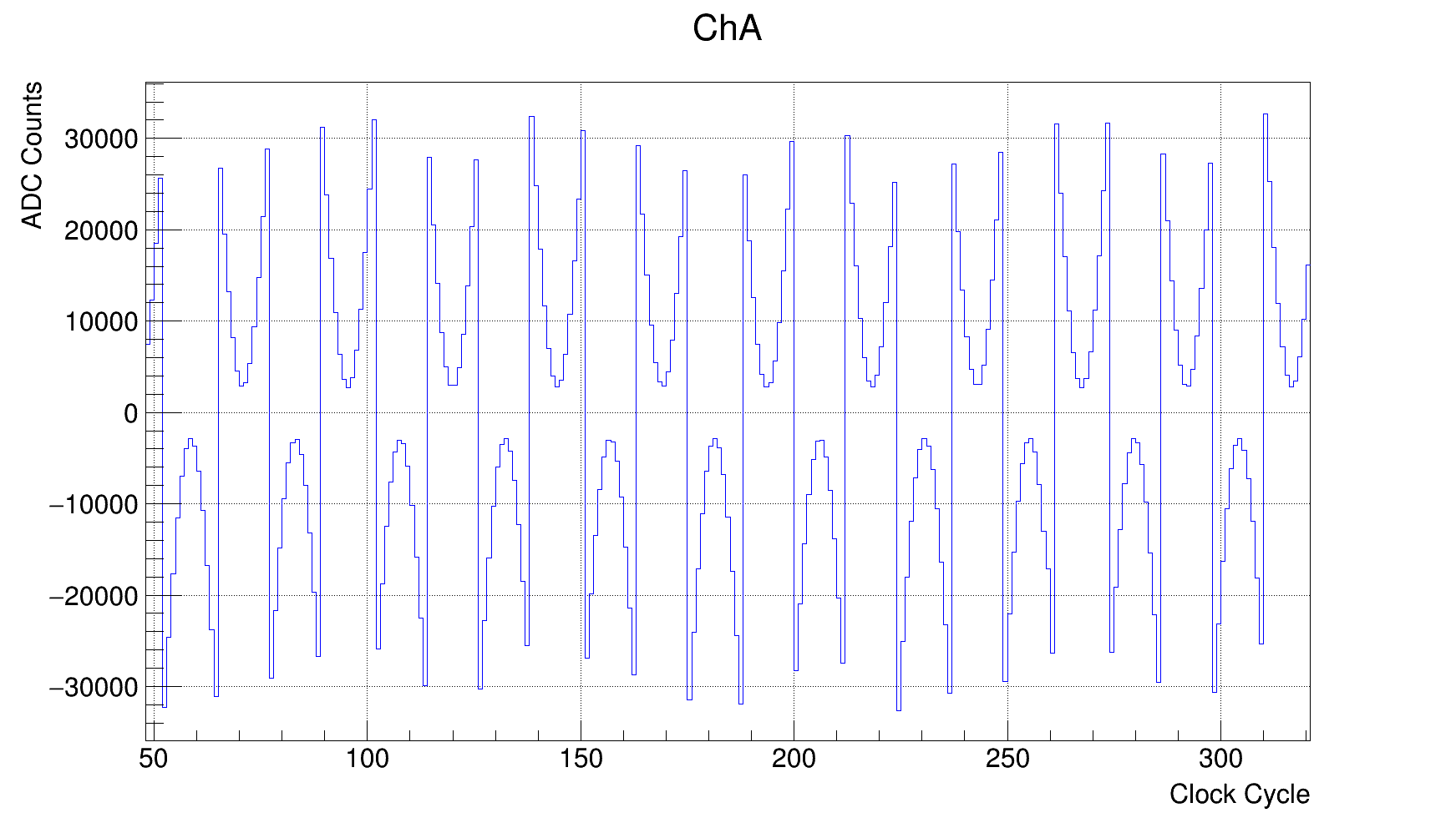

    Here is reported the correct activation of the offset binary numeric representation (through the register 0x29, data 0x18).
    The numbers are represented in offset binary while they are read back in two's complement notation. Hence the waveform appears
    distorted. If I switch back to two's complement notation the following waveform comes back to its correct form, as attached in my
    previous reply. Everything seems to work as expected here.
