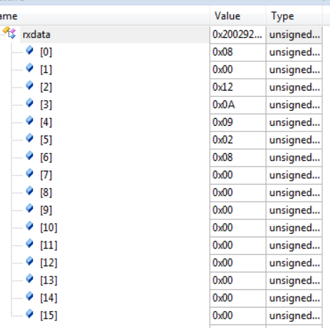

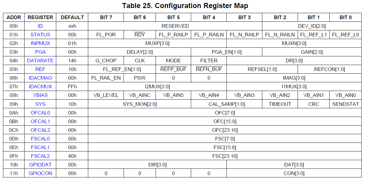

  • Hi Bob,
    Thanks for your response. I watch the DRDY pin through oscilloscope to see if there are any pulses. I have configured the DRDY pin as input.
    In my code I just poll the DRDY pin because I do not read the conversion data in the same ads124s08 sampling rate. This method was implemented by another engineer and I might want to ask, is there any difference in performance by setting high sampling rate(640sps) and read only few times(4 hz)?
    But my urgent issue is to bring up the board and ads124s08 is the only pending thing. Setting the register seems to be ok.

  • Hi Dhanaraj,
    Unfortunately looking at your code for the register writes does not help me to determine much of anything.  It would be better to see scope or logic analyzer shots of the communication for verification.  This is the only truly reliable confirmation.
    If you are probing DRDY (as opposed to DOUT/DRDY), and START pin is high you should see DRDY toggle even at default register settings assuming that both AVDD-AVSS and DVDD are properly connected and powered. RESET must also be high.
    Bob B
