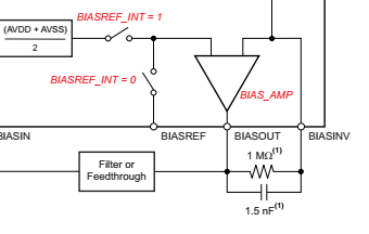

In datasheet bias drive feed back capacitor and resistor typical values are stated as 1,5nF nad 1MOhm. But they were picked as 392kOhm and 10nF in ADS1299EEGFE-PDK.
I calculated gain and cut-off frecuency for both.
For 1Mohm and 1,5nF: 106 Hz Fc and ~66 gain (at 50Hz)
For 392kOhm and 10nF: 40 Hz Fc and ~18 gain (at 50Hz)
Why 392kOhm and 10nF were used in ADS1299EEGFE-PDK ? Are 1Mohm and 1,5nF not better solution?
I measure very high interference at 50 Hz. (10mVpp). Are R and C values the source of the problem may be?

    You are correct that 1.5nF || 1M is a more appropriate solution. The goal should be to set the closed-loop bandwidth of the BIAS amplifier to be greater than 50 Hz / 60 Hz interference as well as at least the second harmonic. This way, the BIAS amplifier has a higher gain at those frequencies and provides a stronger common-mode cancellation signal to the body.
    The EVM was designed a few years ago, but if we ever update the hardware, we will be sure to include this change as well.
