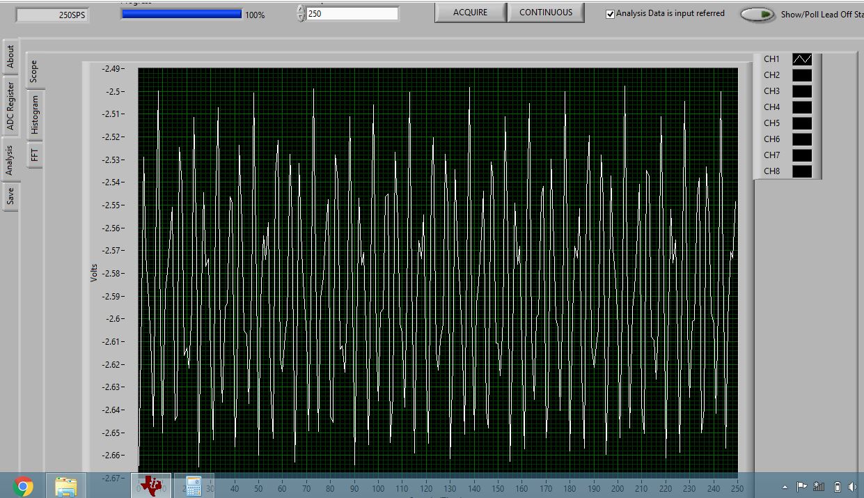

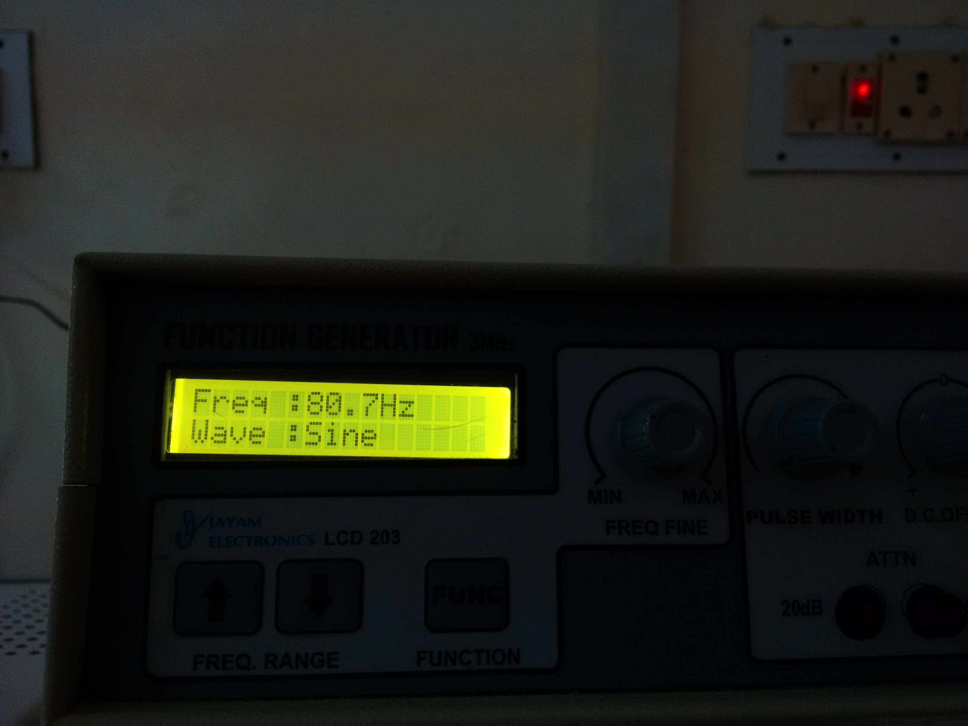

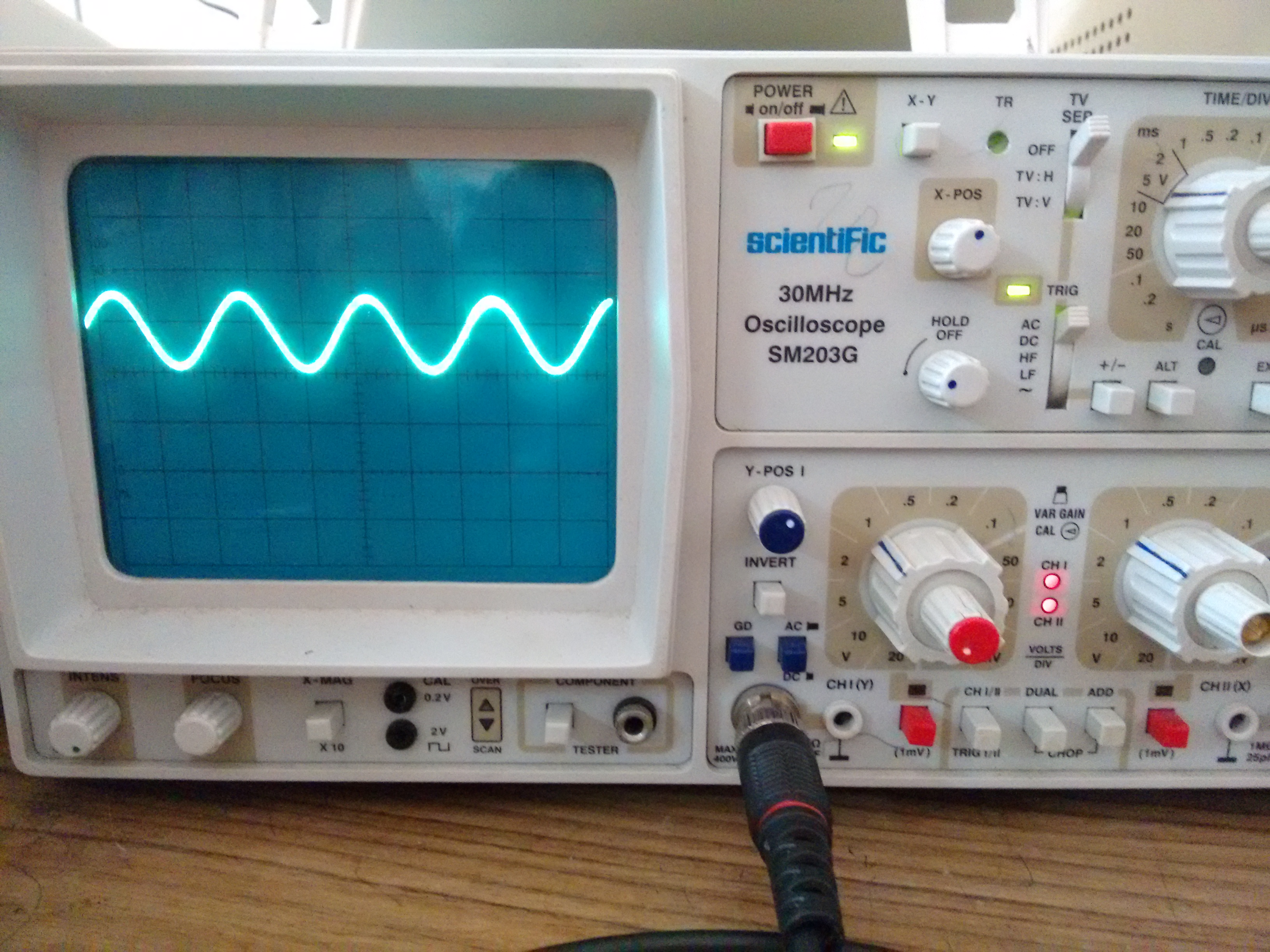

  • Sir i have tried with some input...i have set Vpp as 1V and frequency as 80.7 Hz using CRO and function generator...the settings in ADS1299 EEG-FE kit are as follows
    1. use single ended input
    2.  remove jumpers from 32-36 of J6 and connect the positive of function generator to pin 36 of J6 and ground to pin 34 of J6.
    3.  Set SRB1 bit closed
    4.  Set PGA gain to 1
    5. Checked with sine wave as input
    But i didnt get sine wave as expected...i have got some other waveform...plz explain what is wrong with me..either the settings or connections??let me post the image below...

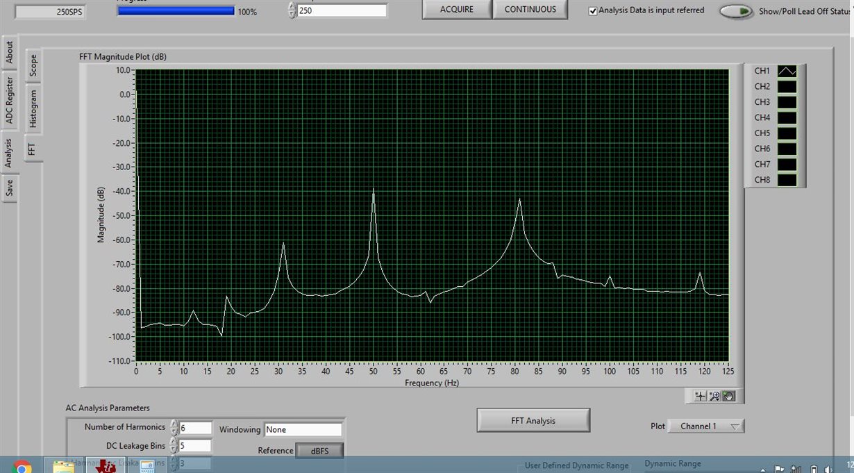

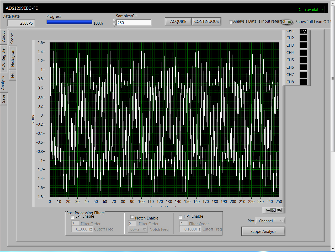

  • Hi LF,
    I was setting up the EVM with Tom, We did not experience any distortion or abnormalities in the FFT. Two things we did to get a clean signal was provide an offset of 2.5V to the sine wave, that way the signal is not close to the lower -VREF. Also, the sampling rate was set to 250SPS in your setup. This is very close the Nyquist Sampling:
    1/80.7 = 0.0124 * 2 = 0.02478
    Changing the sample rate to 1000SPS will give you a better sampled signal.

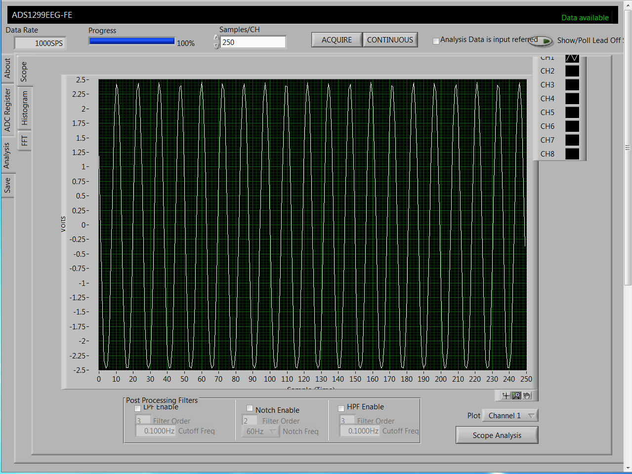

  • Hi LF,
    Here are the screenshots of my signal. I took both 250SPS and 1000SPS so you can see the difference
    Sine, 80.7 Hz, Offset 1.125 V, Amplitude 1 Vrms
    250SPS
    1000SPS

  • Hi LF,
    To clarify about the sampling rate, 250 SPS is not Nquist of 80.7 Hz, but it's such a slow data rate that you can easily see that it is aliasing the signal. As you increase the SPS to 1000, 2000, etc the signal will be look better.
    As for the offset, i did not mention that i was performing the measurement with uni-polar (0 - 5 V). when this is done, and SRB1 is closed it bias the negative supply to 2.5 V. This makes sure that you are at the center of Vref and you won't be clipping the positive or negative supply. As a result, i applied a 2.5 V offset to my sine wave, so the differential between positive and negative supply is the sine wave exclusively. On my signal generator the signal was not 50 Ohm terminated so I had to half the desired voltage I needed. but if your signal gen is properly terminated you can use 2.5 V.

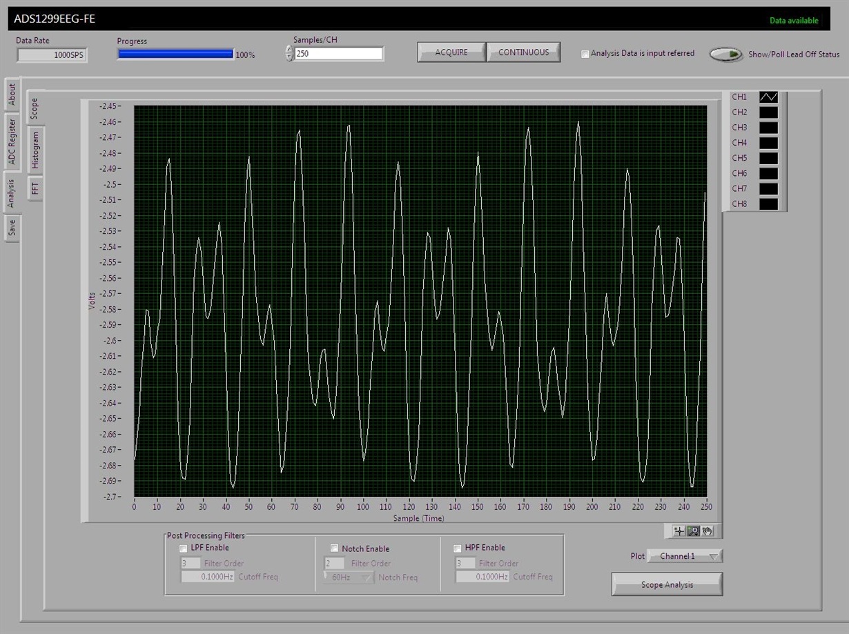

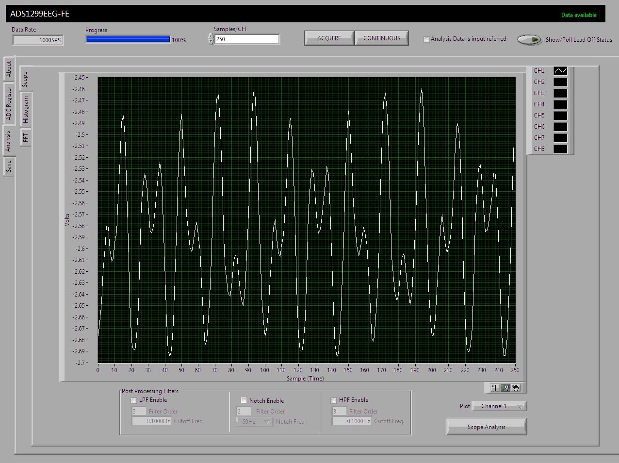

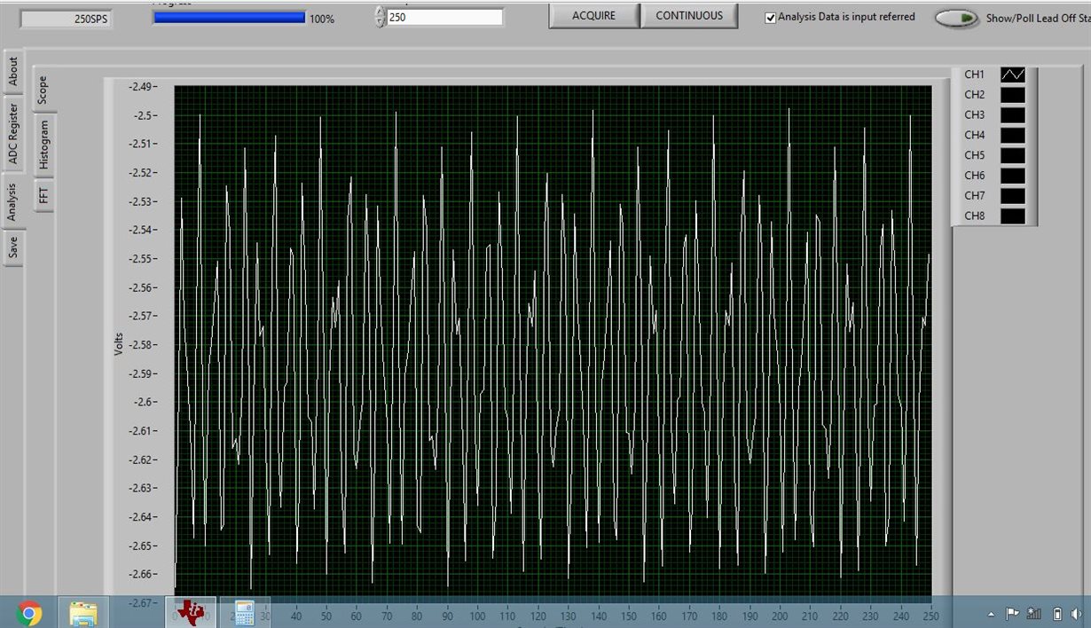

  • Thank you sir for ur valuable replies....today i tried with 1000SPS, Vpp-1, gain-1 and f=89.7 Hz ...but am not sure about 50 ohm terminator ...how i have to check whether the function generator has 50 ohm terminator...and the important thing is suppose the function gen has no 50 ohm terminator how i have to reduce the offset voltage from 2.5v to 1.125v...I have uploaded the output what i got today with the above mentioned values...what is  mistake with this output sir?
  • LF,
    Are you using unipolar or bipolar power supply? Your graph results are very bizarre because your median voltage over where the signal is oscillating is at -2.5 V. Whereas the part's spec that -2.5 V is the negative supply cuttoff. Do you have another signal generator you can try? Because it looks like there are several sine waves being sent, it does not look like harmonics from your graph. Thankfully, the 1k SPS is providing a clean reading. the first thing I would do is try and get the sine wave to 0 V.
  • Sir am using unipolar supply.. And the input I used is single ended...I gave the positive terminal of function generator to pin 36 of J6 and ground terminal to 34 of J6 and make SRB1 closed...the gain I used is 1...what can I do for reducing the offset voltage from 2.5v to 1.125v??
  • In your signal generator set the offset voltage to 1.25 V. (2.5 V / 2)
